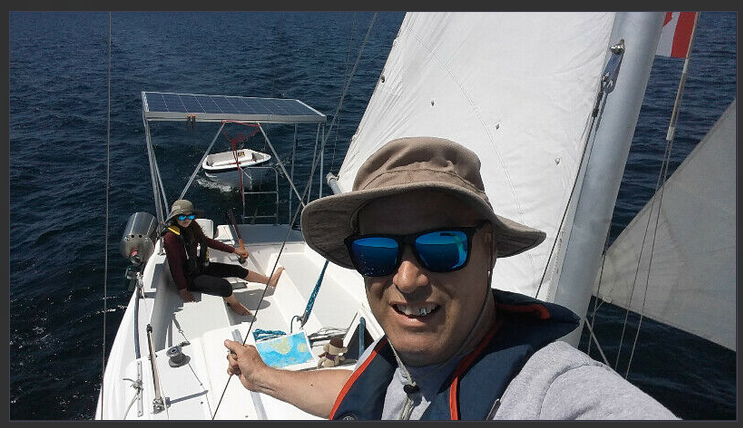

Go bigger than you think you will need. Also with the controller. You will probably want to up the # of W and panels someday.
MPPT controller is best for getting all the power out of the panel.
I had 2 100w flexible panels and a 30A PWM controller. I only run lights, radio, and charge devices (3 phones, 1 tablet and camera) and thought the setup was lacking.
Ive upgraded to a single 230w panel on an arch and a 30a MPPT controller. Now I don't worry about cloudy days. It seems to keep up.
The arch is great for drying towels too.
