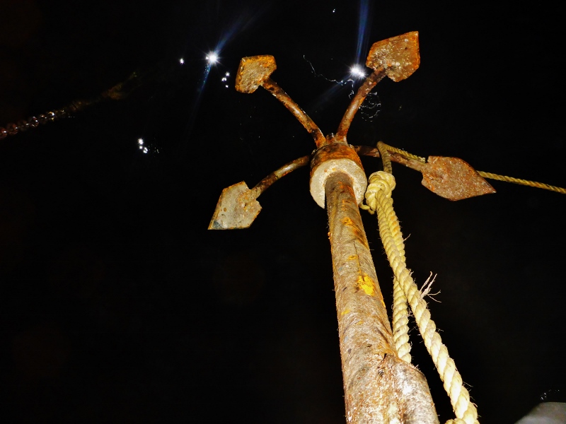

Just as heads up regarding pulling up your anchor from the helm.
Leaving Chaguaramas, Trinidad one morning, the anchor below was fouled in our chain about halfway out to the anchor. Had someone not been forward monitoring the situation, imagine the damage this 250# beast would have done as the windlass pulled it into the bow fluke first!
