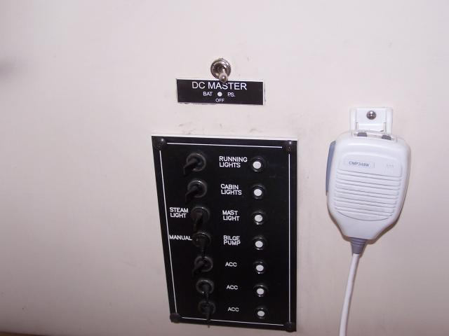

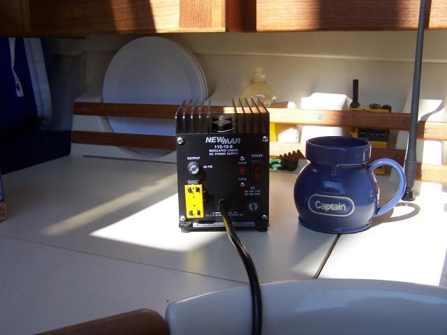

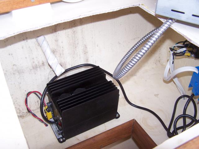

I recently added a 12V DC power supply and a master DC switch. When I'm on shore power I switch all DC circuits off the battery and onto the power supply. I did this because too often I returned to find I left something on and the battery was dead. Also because all my sleep overs are always when shore power is available.
The battery charger is AC. I leave shore power connected to allow the battery to be charged.
