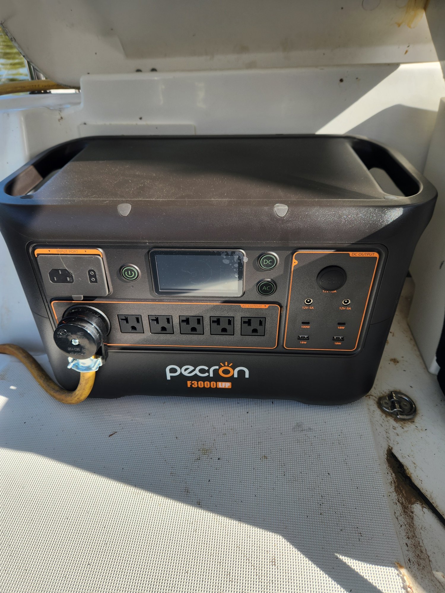

I've been sitting at the dock with the shore power disconnected for about an hour with the AC running. The Percon f3000lfp shows that I've used about 30% of the battery, not too bad. My AC compressor has been running 95% of that hour, but it isn't that hot outside. The power station starts and runs my 16k btu AC no problem, my Honda 2200 will not do that. My battery charger runs happily on it too, not that I would do that on a regular basis. I haven't tried the coffee maker or the water heater but I have little doubt that they will work too. Obviously I can't running everything at once. Questions comments?

What kind of power does it have under the hood and how long to bring it back to 100% SOC ?
Its has more starting and running power than my Honda 2200 inverter generator. The power station obviously doesn't have as much "gas in the tank" compared to a fuel burning generator. My observation is that the power station will absorb 1700 watts from line power, it's rated at 1800 watts. So, the recharge is very fast @ about 2 hours if you can feed it at the full 1800 watts. I throttled it back to about 1100 watts on the boat. It can also be recharged with solar or a DC source above approximately 28 volts, I don't remember the specifications of the DC/solar input. They do sell a charger that boosts 12 volts from an alternator to a usable voltage and a claimed 500 watts of charging, my 100 amp Balmar should handle that.
I am impressed with the surge capacity and the recharge rate.
It's about 69lbs but it has 2 handles that make it easier to carry than my Honda generator. No carbon monoxide to worry about, unless I pair with the generator.
I'll have access to all the dock side amenities while I'm not at the dock, even if it's only for a few hours.
