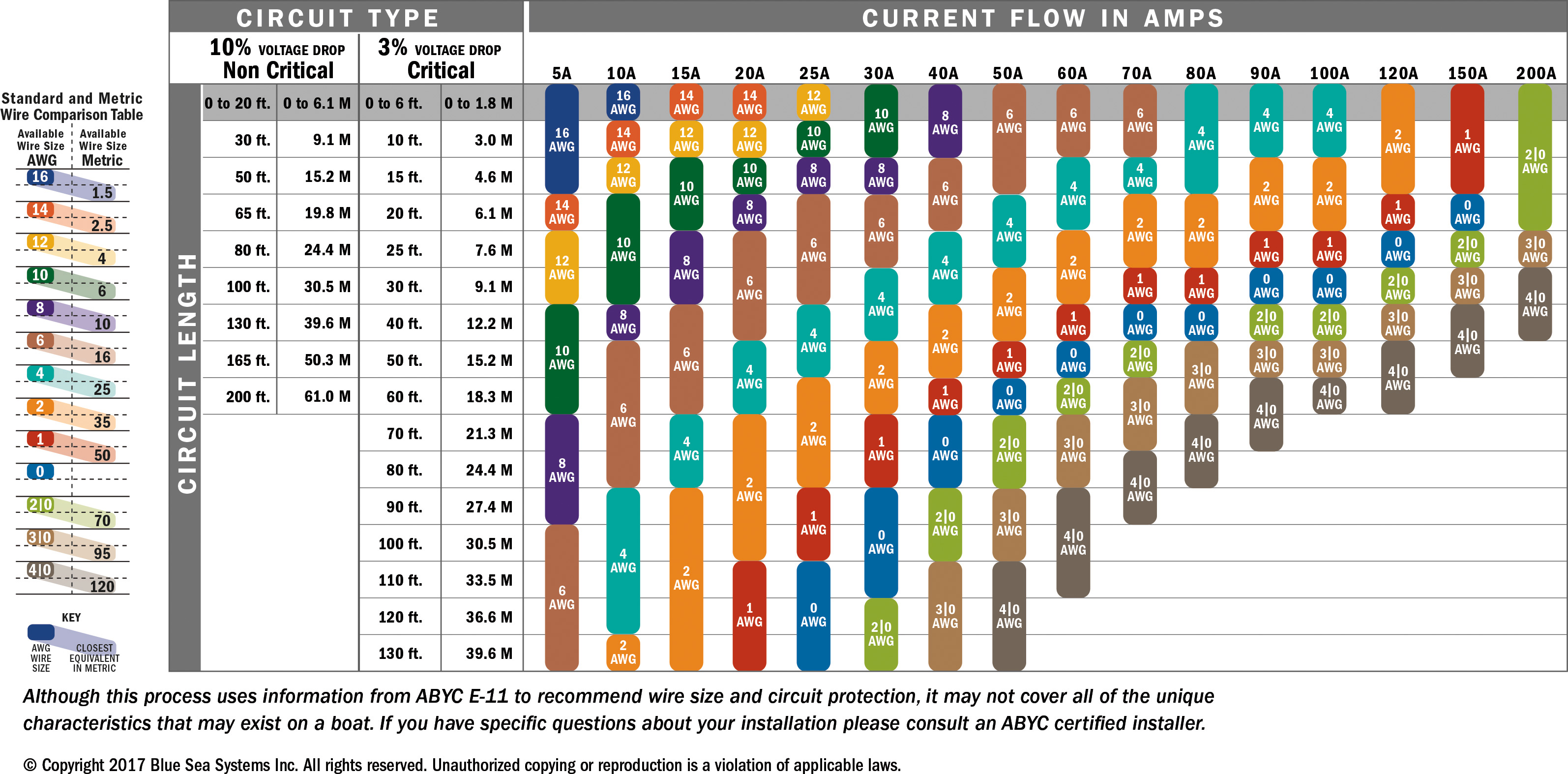

There is only about 6' of cabling from the battery to the starter. I'm seeing 80 amps for 4awg wire on most sites
BlueSea recommends 70-100A depending on wire type
The starter isn't likely to be anywhere close to max capacity of the wiring. I've seen what 30A@120v can do. I also have a welder rated at 125A can can penetrate upto 3/8" steel. No point in putting a larger fuse than needed. Anyways, what I'm interested in finding out is the power draw of the starter. I can meter most other components to find this info
That table tells you how large the wire needs to be for “X” amps of current to have a voltage drop of 3 (or 10) %, with “Y” feet of wire. It really doesn’t tell you what size fuse to use. Normally you want the fuse to protect the wire from a dead short, so use this table: https://www.bluesea.com/support/reference/529/Allowable_Amperage_in_Conductors_-_Wire_Sizing_Chart, I think.

@marchem is correct, it is not the voltage drop to fuse for, but the capacity of the wire to handle amperage regardless of length.
When considering voltage drop the calculation is based on the "round trip" of the circuit. If the starter is 6 feet from the battery, the round trip is 12'. Often boat builders use the smallest wire they can get away with to cut down on build costs. Sizing up to a 2 ga might yield better starting.
