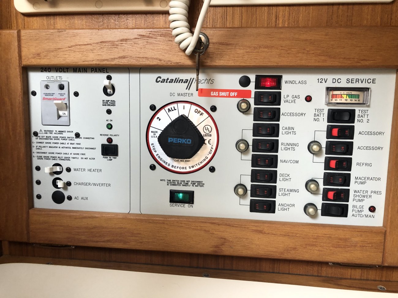

May 20, 2016
3,015
This is the panel. The fridge only gets cold when it’s on ‘All’ however all other accessories including lights radio powerpoints all work on ‘1’
If wired correctly. Everything should work in 1,2, and both. Very very few things should work in off ( bilge pumps, battery monitors, gas alarm).
Battery chargers should work in any position including off, but some are wired to the common post on the battery switch and only charge the selected battery(s).
There is no one right way to manage your battery setup, it depends on how you use the boat and what is important to you. But it sounds like yours is wired incorrectly.

Just an educated guess here but if the frig only works in the Both position, neither battery on its own can supply enough power for the frig to operate. Maybe you have a weak battery?
Maybe the PO did something strange so it only is powered when the switch is in the Both position but I don’t know how that could be done.
Interesting. Your voltmeter is reading 0v. It appears that the selector switch for the voltmeter is on "Batt 2". You could try selecting Batt 1 and see what the reading is. In any case, it appears you might have at least one bad battery. Time to get someone on board with a voltage meter and hydrometer to check out the batteries.
Another thing to note, it appears your bilge pump circuit breaker might be in the "off" position. It's a good idea to verify it is in the middle, or "Auto" position whenever the boat is in the water.
