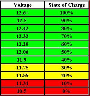

A voltmeter is not a good indicator of battery state of charge. A battery monitor like the Victron will give you a much better indication of battery SOC.
Between 50% and 80% you have about 110 AH to work with. Not a whole lot when refrigeration is cycling constantly.
A 3 stage regulator will not charge the batteries any faster. Battery acceptance is the determining factor. Between 50% and 80% the batteries will accept up to 90 amps in your case or the max alternator output whichever is lower. Where a 3 stage will help is if you are motoring for a long time as it gives you a float stage you currently don't have if using the standard internal reg.
Here are the state of charge voltages. There may be a slight variation between brands but it's pretty close.
