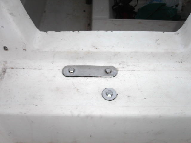

The only major part missing from my recently acquired 1978 M22 was the keel winch.
I found a reasonably priced Dutton Lainson brake winch at Northern Tool, but it doesn't come with the cable and anyway they don't ship to Hawaii.
I went to the local Checker Auto Parts Store and found a 12-volt powered winch rated at 2000# for ATV and Boat use: the price was about $90.
Got it installed today and it seems to work just fine. Reinforced below the glass with plywood. All it cost me in aesthetics was one additional stainless steel fastener showing on the step leading to the cabin.
Here's some pics we shot this evening as the job was done.
