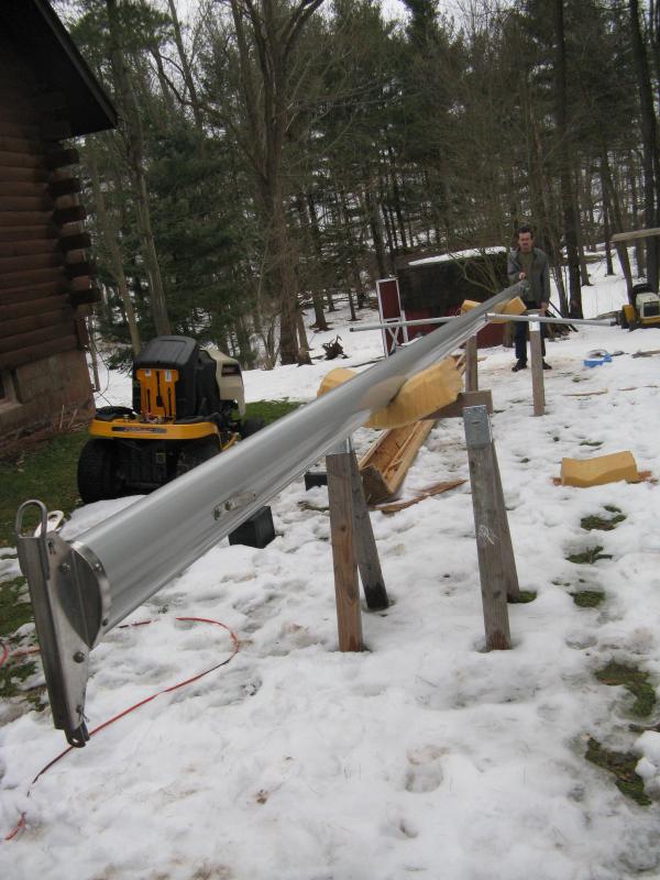

Had my mast, boom and spreaders, stripped, reanodized and powder coated by Charleston Spar. Tough as nails. :D
I have a powder coat gun and a dedicated oven. I have coated several items on my sailboat. Some of it has not held up well. Anodizing aluminum is MUCH better if you are going to pay someone. Your mast looks GREAT!
Unlike anodizing, a powder finish is brittle and will chip if hit with any metal item. I saw a mention above of "messy" describing powder coating. I find the opposite. All you do is blow it away or suck it up with a vacuum. It has the consistency of talcum powder and just blows off anything when it is not cured.
Also - it is all about the oven. I have a standard kitchen oven mounted to a stand that I made. The oven was free from a neighbor. It has very accurate temperature settings and most colors are melted in 10 minutes. Remove from the heat and the finished result is a hard, shiny coating that is UV resistant. Just don't hit it with a hammer or steel winch handle. If the item to be coated is up and out of the way, or not likely to be nicked, powder coating works great.
