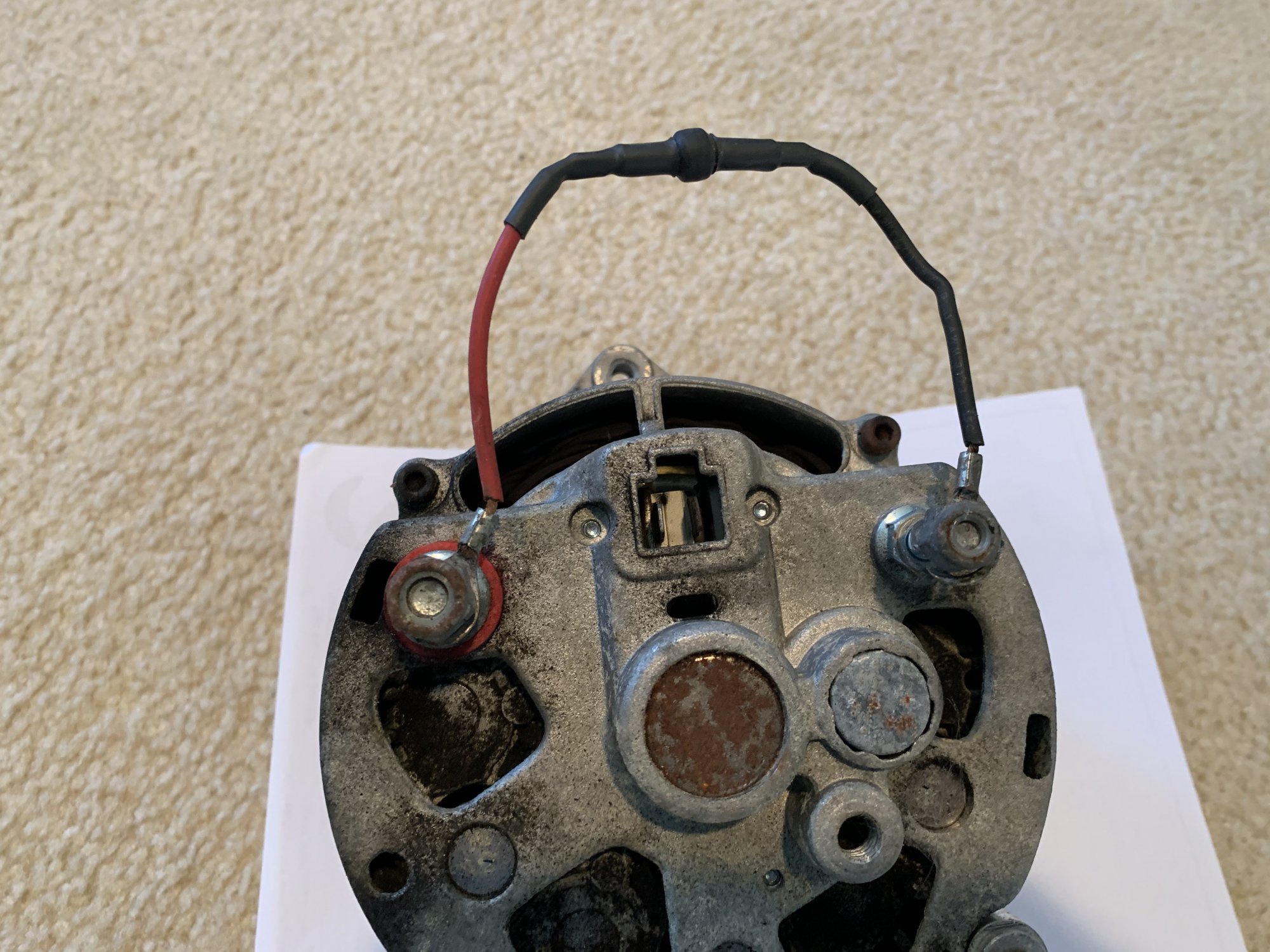

I'm wondering if I did any damage to the alternator diodes or belt. I have a high-output alternator (not the original but it is at least 20 years old) and a new Balmar MC-618 external regulator. The belt is a new serpentine belt installed with an adaptor kit to change the pulleys. I'm pretty sure I wired the disconnect switch and regulator correctly with the regulator power wire on the alternator side of the disconnect switch. Also, my alternator has some sort of jumper between the positive and negative posts that I guess is some kind of alternator protection device. I have no idea if it is any good.

That jumper between the terminals is a TVS diode to help mitigate a voltage spike on disconnect.
If the alternator is working, its diodes are fine.

That's what I thought. There was not any sign or noise of distress once I switched the alternator on. The sound of the engine seemed normal and the rpms dropped about 100. That photo was taken 5 years ago when I removed the alternator and replaced the standard v-belt pullies. The belt dust blackened the entire engine compartment. There has not been any belt dust since I installed the serpentine belt. I haven't looked at the belt yet since this episode. I do have a spare, but I figured I will never need it.
