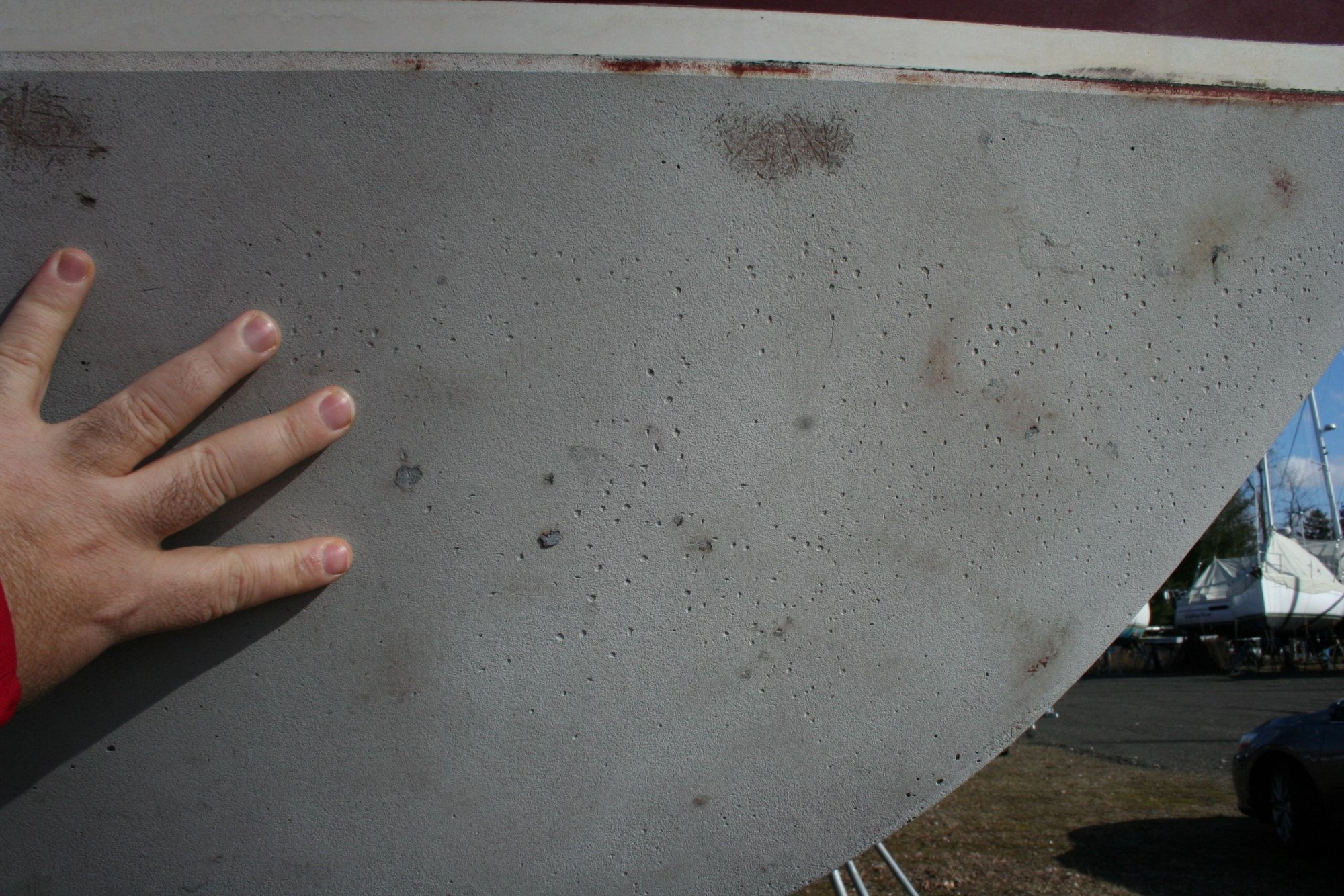

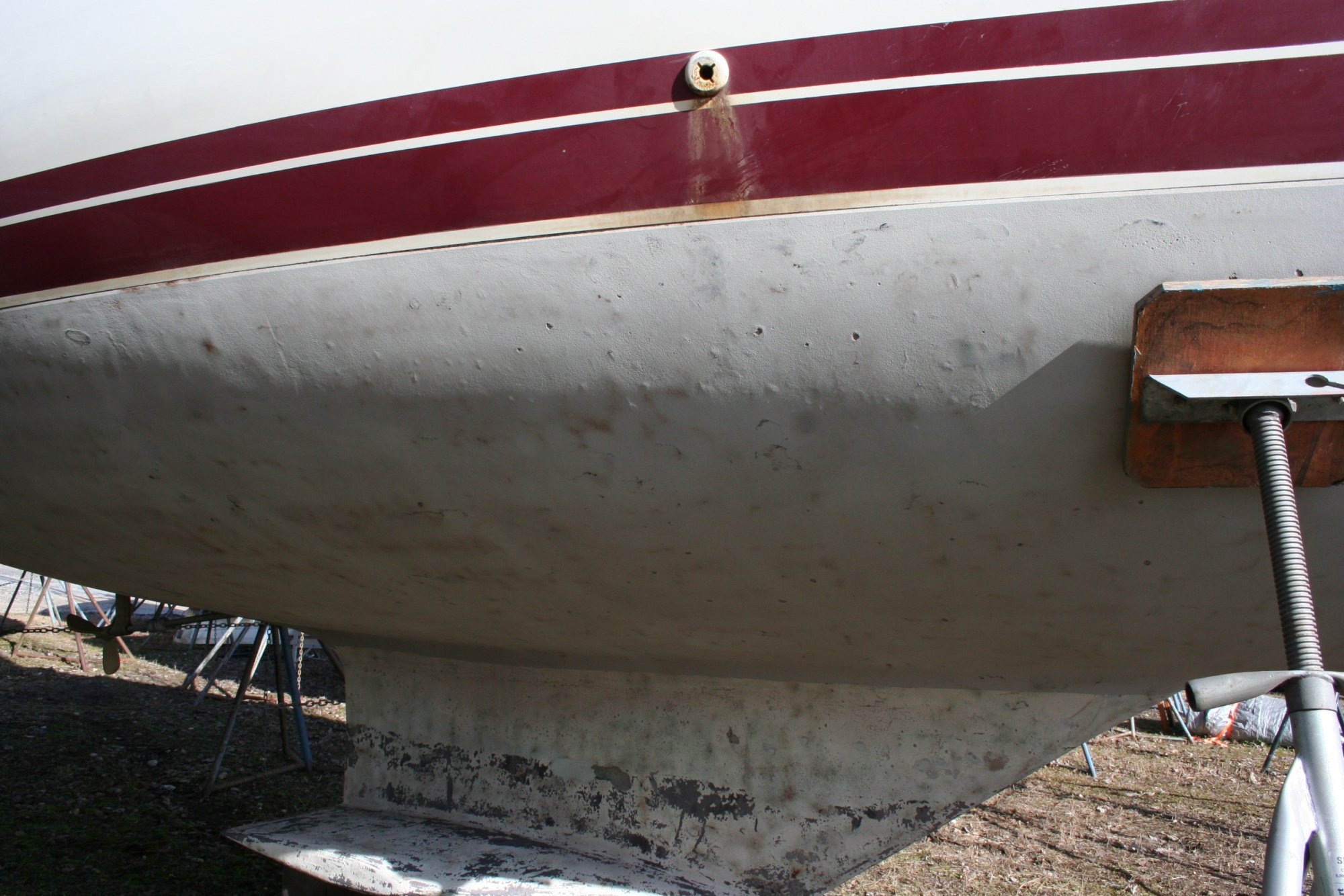

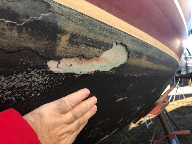

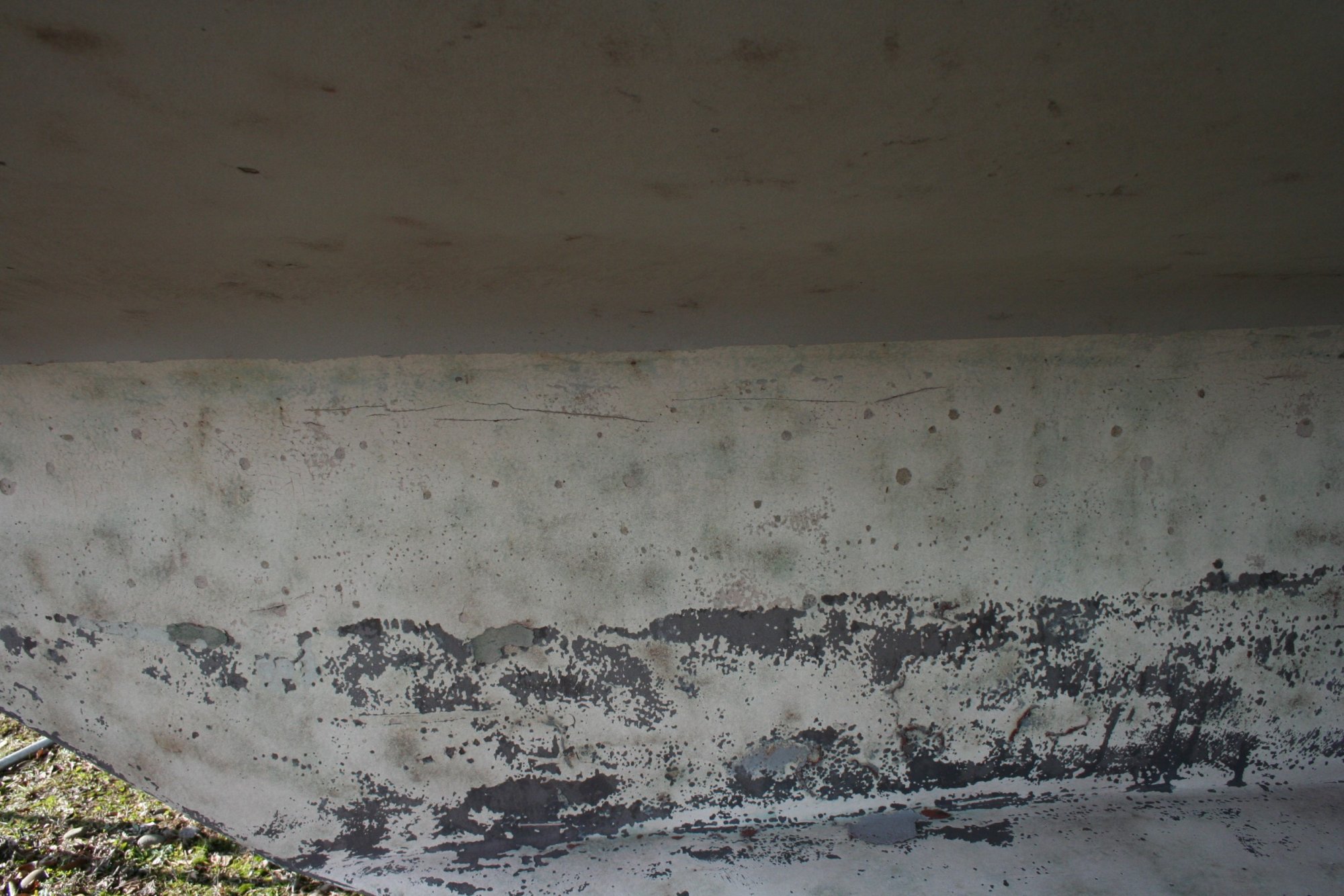

Soda blasting is done, unsure of the next step.
I figured I would need to sand with some 80 grit, wash it, clean it with acetone, then apply the barrier and then bottom coat. However, there are some small chips in the hull, and I was wondering if you think it needs a fairing compound first? I am not a racer, just cruising the Atlantic coastline of New Jersey for day sailing.
I was looking at using TotalBoat Fairing Compound if needed, which was recommended as it's easy to apply, forgiving, and easy to sand when dried/cured. I plan to follow that with Pettit Protect barrier, and Pettit Hydrocoat for the bottom.
How much fairing compound would be required to fair a Catalina 30’?
Any
Any advice would be greatly appreciated.

I had set out to soda blast our hull 4 years ago.. Hired a young man that stared me away from soda and onto glass bead. He had references from several marinas.. Did an outstanding job.
23,855
That is a loaded query. Depending on your boat you can start with a quart but be ready to buy the gallon. Jamestown Distributors had some sales running. I think one of the BoatToday videos covered the fairing process. I think Andy was using Total Boat fairing compound.
View attachment 189528View attachment 189529View attachment 189530View attachment 189531Any
Mike Montone
Whatever barrier coat that you go with do your homework on the application process. I had used System 2000 by Interlux. It was saying 4-6 coats. Went with 4. Started with gray, then white, back to gray, ending with white. Then when the last white coat was still tacky, the first Alblative coat blue followed by a red coat...
I figured it'd be loaded, not knowing how how many dips and chips there'd be, which would equate to how much compound would be required/used. I think I may by two quarts just in case, to be sure that I have them on hand, no need to re-order, etc. I was concerned whether I should epoxy the chips first, then apply fairing compound, etc. so I wrote to Pettit as well asking advice. They replied with: Sand, clean with Pettit 92 Bio-Blue cleaner, fair, two coats of the Pettit Protect, two coats of the Hydrocoat or Odyssey antifouling.
Having never done this before I am more than a little, but I am doing my research and due diligence. I also need to wait until a little warmer weather, and trying to gauge how long the process will take. I have some travel for work in May, so I would like to complete this work in April, launch the boat in April, and reposition the boat to it's new seasonal marina about 100 nm away.
