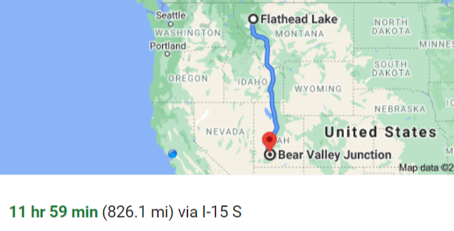

Wow.....that is 12 hours from Flathead Lake and from San Francisco!!

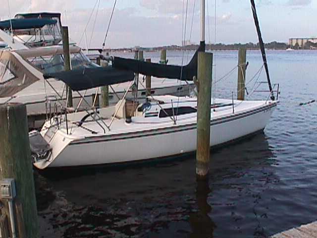

Nice looking boat! You should have a lot of fun with her. Why are there no pictures with the boom? The bimini looks really tall. Can it be used while sailing?

unfortunately the bimini and boom are incompatible, so you either sail or enjoy the shade. that's one thing I'll be looking to modify this summer.

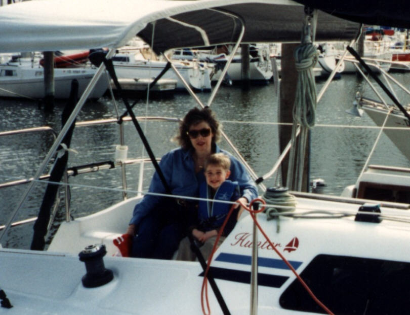

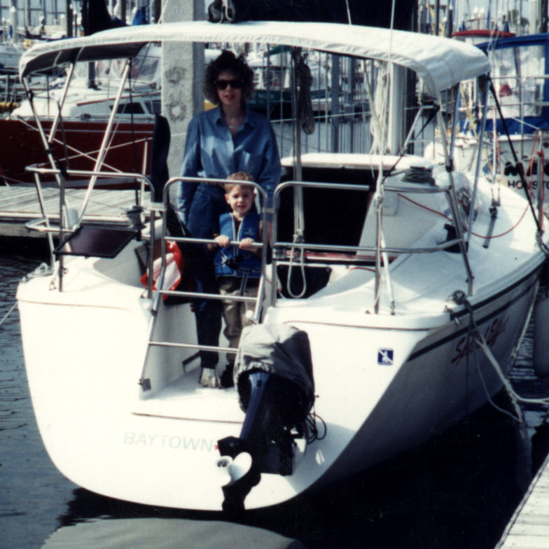

It's been 25 years, but we had a bimini with lots of headroom and still sailed with it up. I drilled out the goosemeck rivets on the mast and tapped the holes and added more holes in the mast about 16" up. I had another reef added to the mainsail at 16". When the bimini was up, the boom was attached at the upper holes. If I wanted to race with full sail area, I took down the bimini, shook out the reef, and lowered the boom back down.
Also, I remember seeing one with just the boom end/mainsail clew raised. The bimini was smaller, not as far forward, but it was easier to go back to normal sail area. The bimini could only go to the mainsheet anyway, unless you also added some blocks or a whole new traveler further forward, and I have seen that done to a 26.5, too.

Thanks Bill, that makes sense as a way to move the boom up. I'll have to see about mainsheet clearance though...

Between the boom and the mainsheet, it says the PO gave no thought to sailing or even rigging the boat to sail with the bimini deployed. If it were mine I'd replace the bimini with one more suited to the boat. But you are way up north so maybe a bimini isn't so important in your area.

nice looking boat Bill! it looks like the back stays go through the bimini? I might have to see about modifying to do just that. my wife is handy with the sewing machines, and we are already planning to get her a stronger one for the cushion repairs. so far it looks like the sailrite will be the one she chooses.
