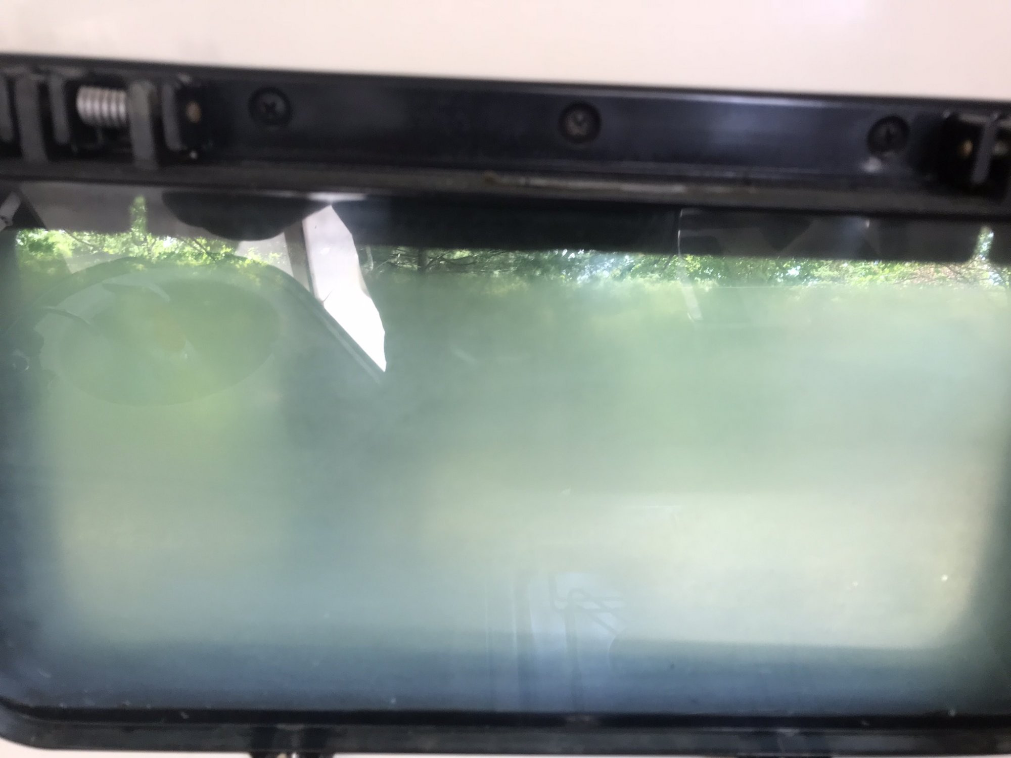

Does anyone have any tips or recommendations for restoring cloudy port lights? I also have 2 beckons that I can remove and polish (the rest are built into the deck).

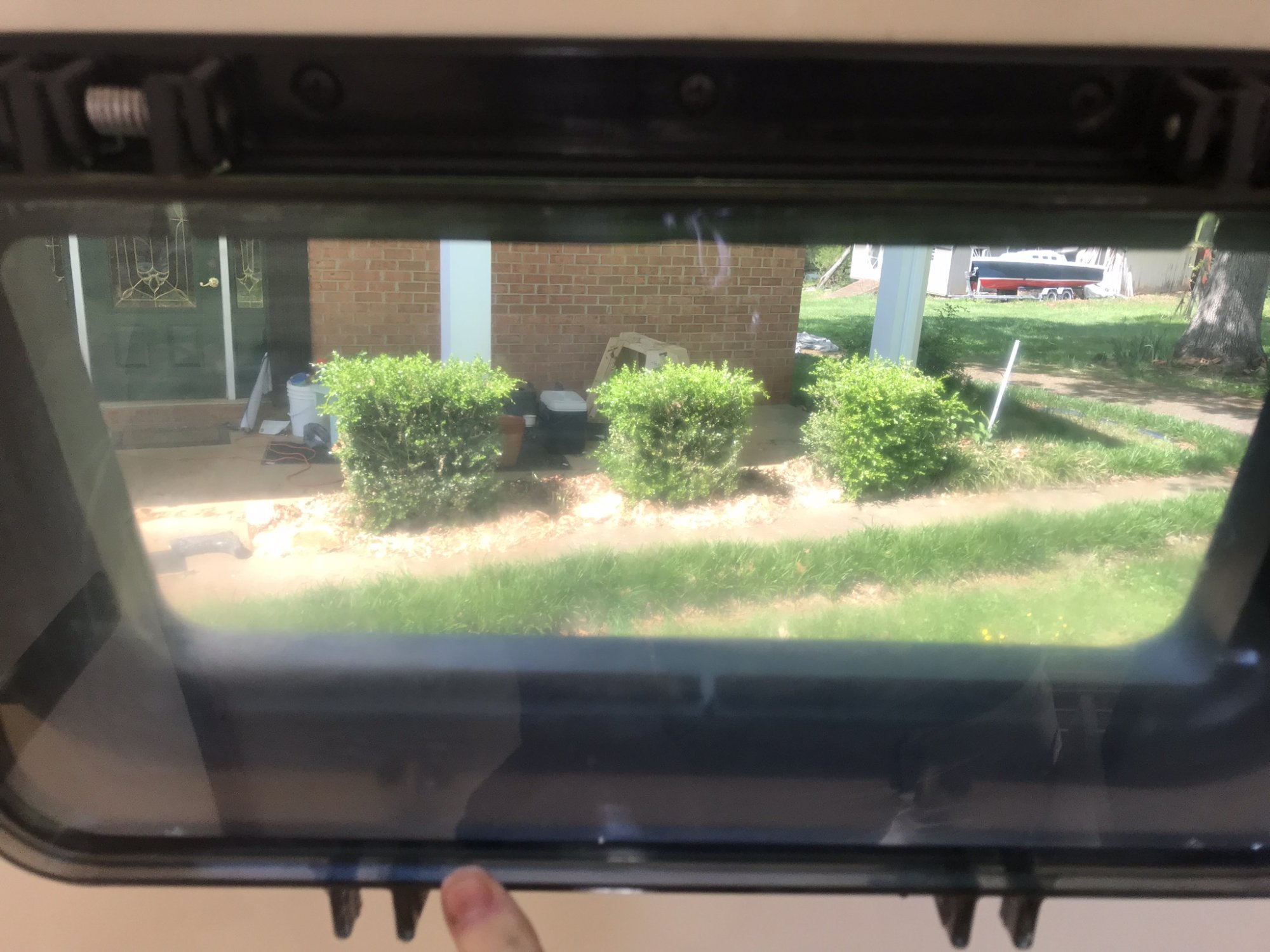

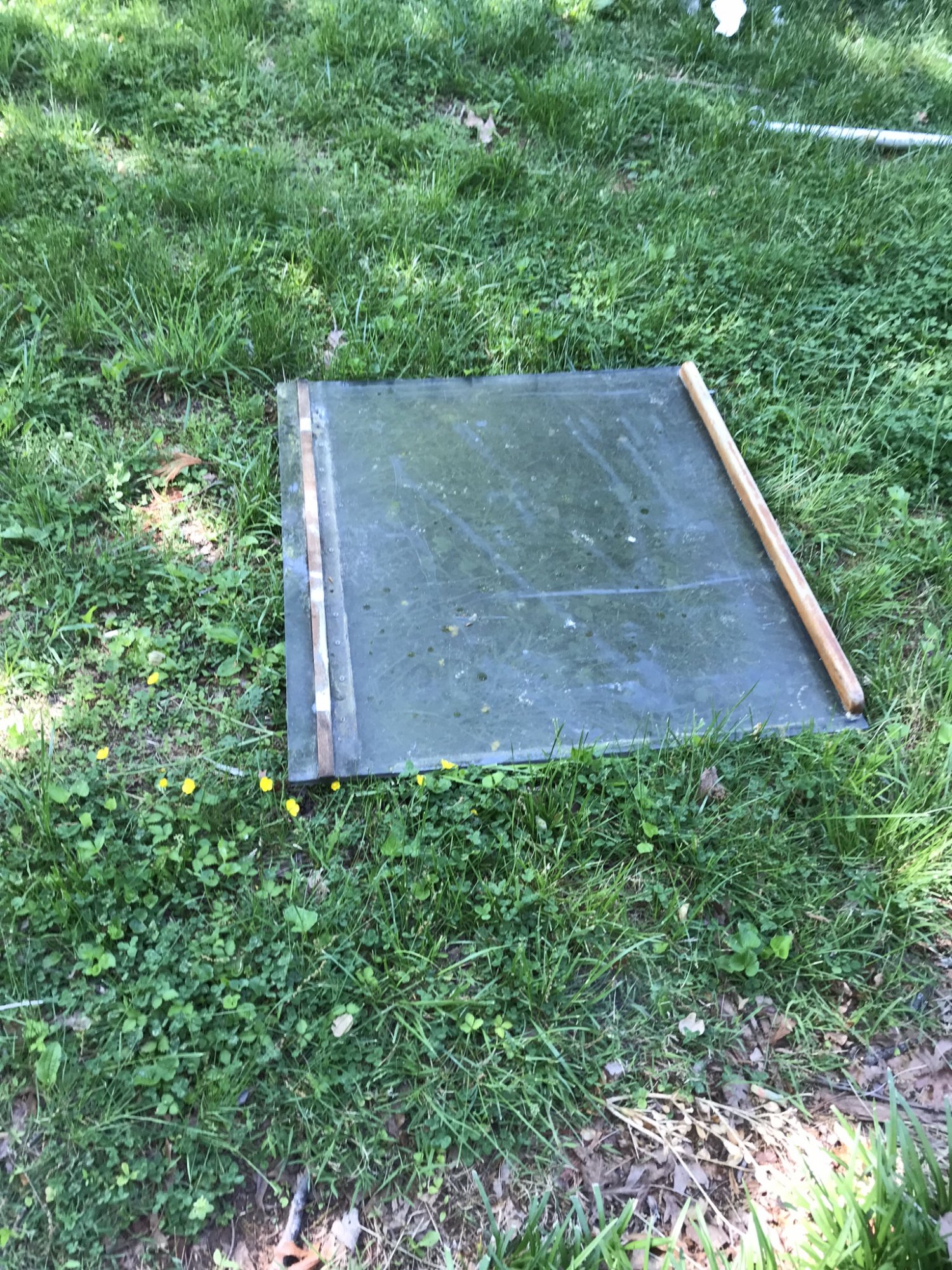

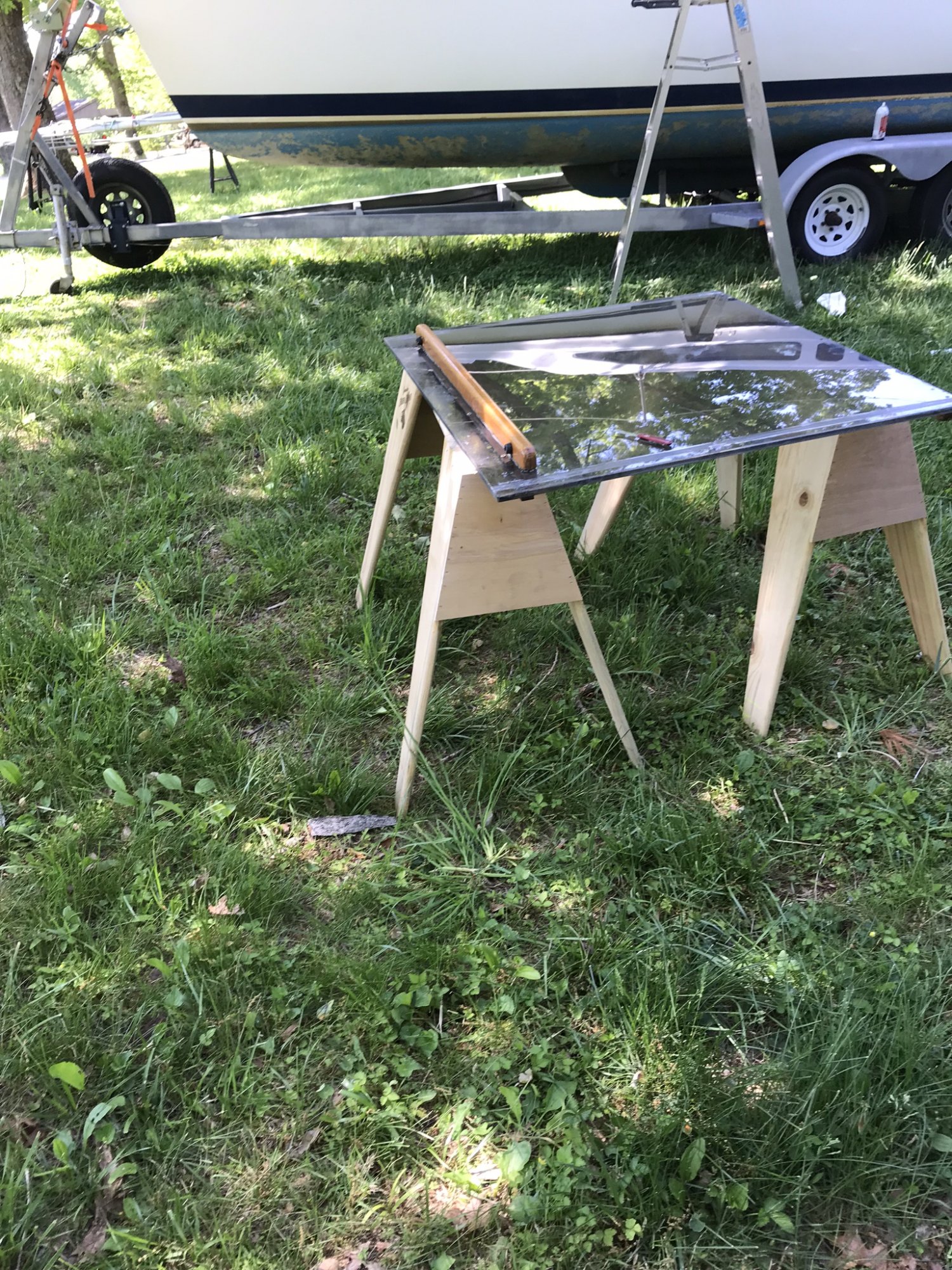

Here are some before and after pictures of me polishing a port, and the acrylic companionway hatch, for my Hunter 26.
Very nice results. Did you machine polish with foam or wool or did you hand polish? I need to work on my companionway hatch & acrylic hatch boards.
Likes: rgranger
12,565
I used a cheap buffer from Auto Zone.
Likes: BigEasy
12,565
When I sold the boat four years later, the ports were still clear. I did not use any UV protective spray.
