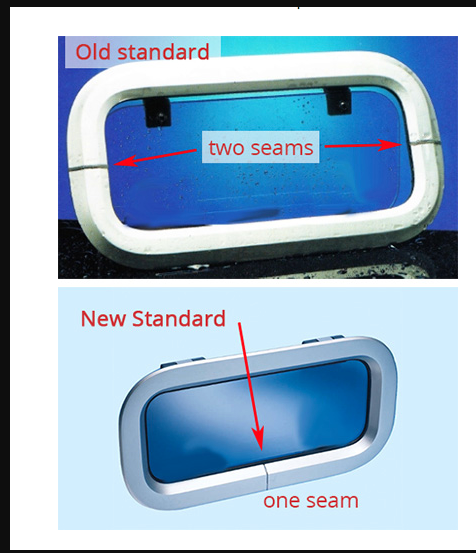

Lewmar recommends digging out the old sealant from where the extrusions butt on the outside, 2 butts if Old Standard and 1 if New Standard ports, and refilling them with new sealant.Screen Shot 2018-07-04 at 10.50.18 AM.png

I only have the one seam and thought (my mistake!) that the seam was covered by the sealant just inside the perimeter. It was a Florida gully washer when I was leaving and I looked directly at the extrusion gap considering it as a source, a close lightning strike interrupted my introspection! I will address the gaps on my return and devout more attention to the others that I intend to pluck out as the ones I pulled came out ever so easily and they are all the same original bedding.
