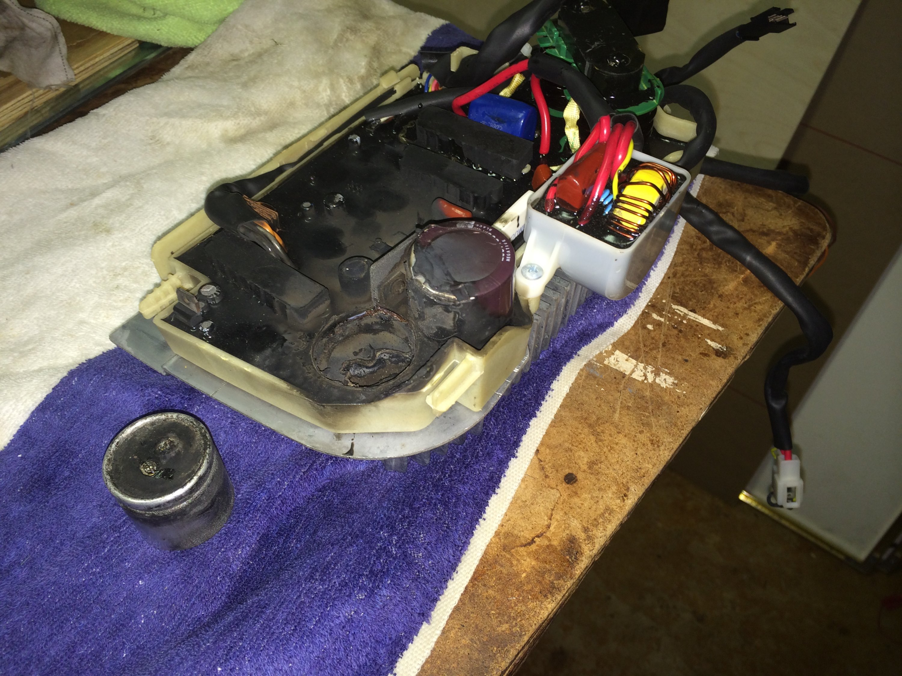

I had a great experience with their customer service folks, Dom.. Bought a 2000 watt (continuous) inverter unit (iX 2000) from them a few years ago. A year after it was out of warranty, the inverter module spectacularly let its magic smoke out.. I was running a small chain saw with it and not close to its rated output.. I disassembled it and took a bunch of pictures and sent them a letter detailing the failure and how I did not expect that unit to have failed after only about 10 hours of run time.. Since the engine and alternator etc was not damaged I asked them for a new inverter module.. They promptly sent me a whole new generator..

Note that the Generac I have was actually manufactured by the Jiangsu Tiger Yacht Manufacturing LTD. .. made in China.. The engine and alternator are very well built and robust.. The inverter module, which was probably outsourced, was the only failure. It looked like something in the potting compound made a gas pocket which exploded, blowing off one of the big electrolytic capacitors..(capacitor did not pop, it got blown off the board) The replacement module cost was about the cost of the entire unit .. I looked at several options before going to Generac with the failure.. and yes, I bought a Honda in the meantime.. The Generac is rated at 25% more power than the Honda is why I bought it. The inverter module in the Honda looks very much like the one in the Generac (may be an artifact of the Jiangsu having been reverse engineered from the Honda?).IMG_0097.JPG
