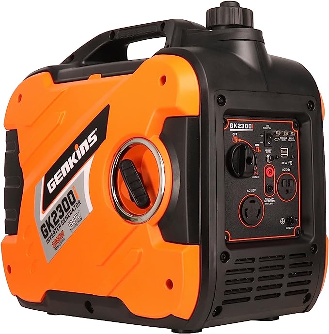

I purchased this Genkins 2300 watt inverter generator when I owned a Hunter 38. It has a NEMA L5-30 outlet right on the front panel so a 30A shore power cable plugs right in without adapters. It is selling on AMZN right now for $389. The comparable Honda EU2200i is $1200.

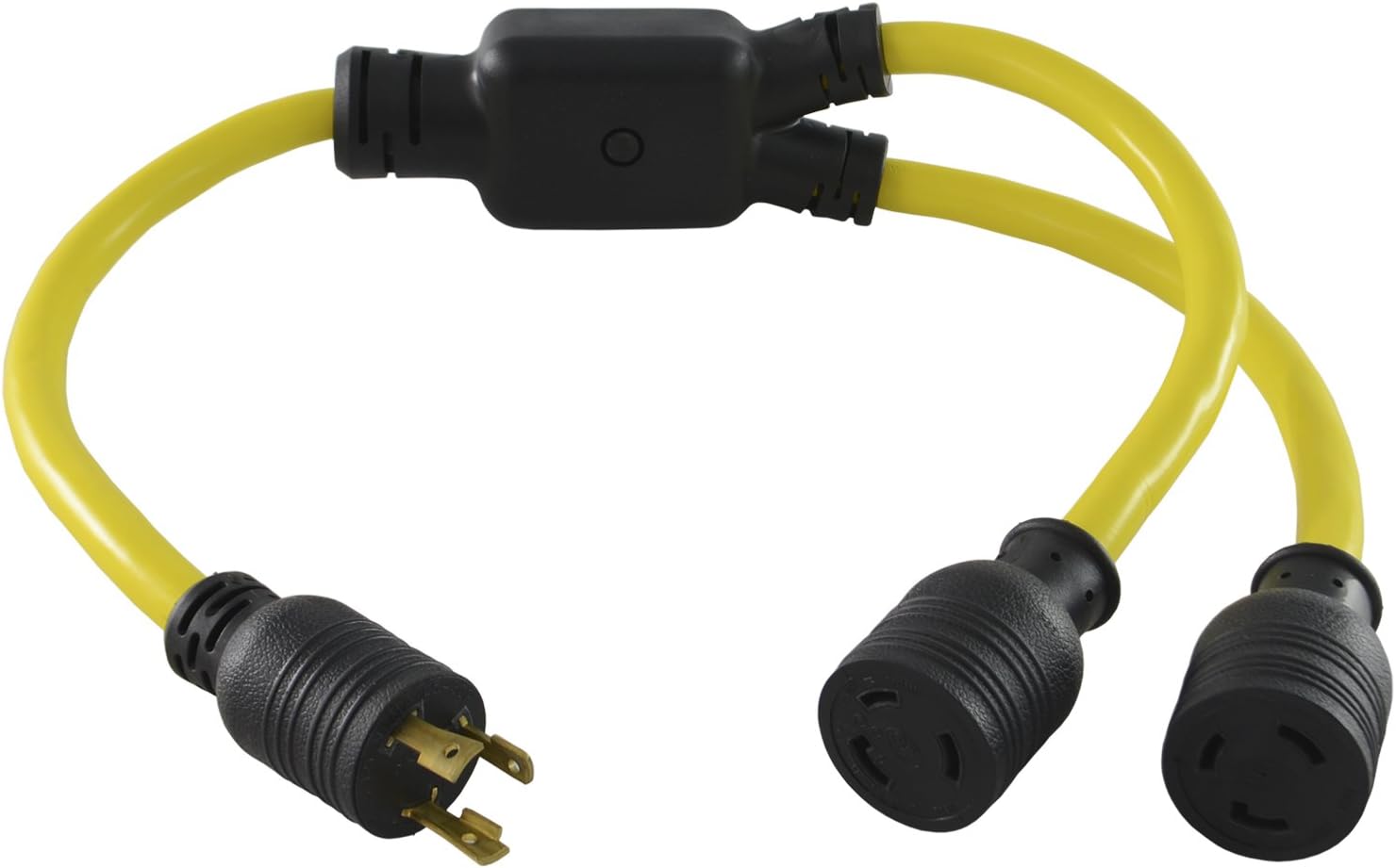

My 38 had two 30A shore power inlets for two separate buses. One bus powered the house loads and battery charger. The second bus powered a 16K BTU Dometic marine air condition for the salon plus vberth and a second 8k BTU Dometic marine air for the aft stateroom.
I used a y-adapter when I needed both inlets energized.
There are some CAVEATS:
  • 1900W running load is enough to power house loads, battery charger, A/C cooling pump and only one A/C compressor. I could not run both A/C units at the same time. Nor could I run microwave, coffee maker, vacuum, etc. all at the same time.
  • To run the A/C I had to turn off the ESC function which runs the generator at a slower idle under light loads. With the ESC on, the generator could not get up to speed quick enough for the compressor load.
  • Under full load, the generator's tank held enough fuel for 4 hours of operation. Not quite enough to get through a hot night without an early morning fuel top off.
  • You said you wanted it dockside, but I used the generator at anchor too. Make sure you have good ventilation so CO2 doesn't build up below.

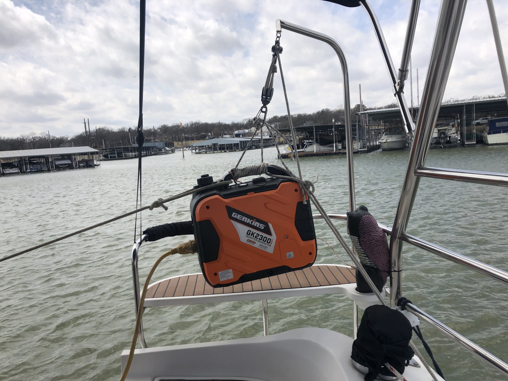

  • The generator is reasonably quiet, but it will transmit vibration to the hull. I had fairly good results suspending the generator off the deck from a halyard and then using lines to stop side to side, forward to aft motion.
I have sold that 38, but I use the generator on the Hunter 33 I now own. It's a great piece of gear.
