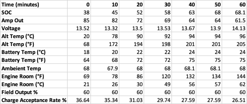

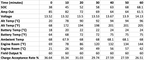

Here's some data I collected last year. The batteries were 2 Group 31 Firefly batteries with a charge acceptance rate of .4C. The alternator is a Balmar 165a controlled by a 618 regulator with the field current limited and a temp limit of 100°C. Over the course of an hour the SOC was raised 30 percentage points. At 20 minutes you can see the acceptance rate begin to decline, over the hour it declined from .36C too .26C as the internal resistance increased. Like wise voltage was increasing and approaching the absorption voltage of 14.4. After an hour I decided to stop wasting diesel and let the sun take over. It had been a couple of very overcast days on anchor in December.
Nice table - I also read through Rods article you posted the link to, while my question was not answered, it is a very interesting write-up!
