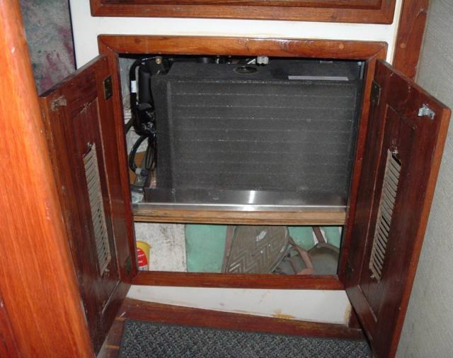

"Extended cruising" means time away from the shorepower. Cool air is going to be at a premium regardless which way you go. But central air is much more efficient because it is water-cooled. It is also smaller, lighter, and not something that has to be moved and stored. And, naturally, it is nearly double the cost.
My own Mermaid occupies the bottom of a small locker. I did not want to use storage space for duct work. It simply blows out under the nav station.
