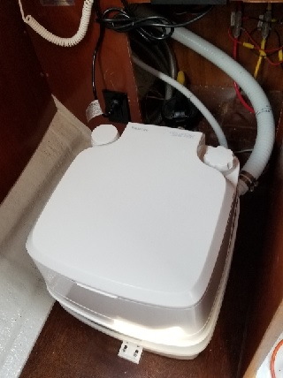

Perfect timing as I just converted my Thetford 550P MSD from a Porta Pottie to having pump-out. It came with the "connection" for the pump-out line and the vent. Important safety tip, when running the pump out line, be sure you have enough for the nice gentle curve as the flush tank/seat needs the line connection to be at a bit of an angle to be able to be remounted. Pic below.
I ran it to a deck fitting above and then ran the vent hose out the side of the boat to a mushroom thru hull well above the water line.
