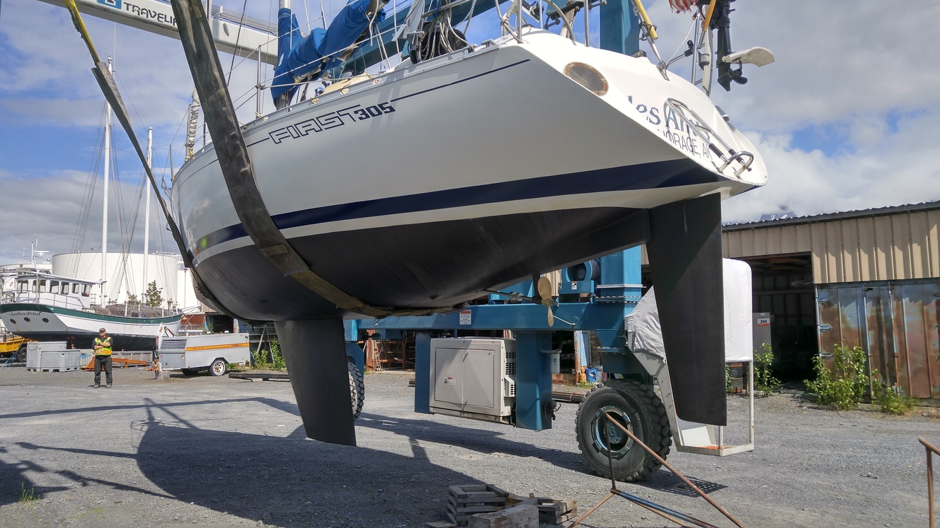

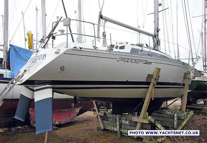

  • Does your Beneteau First 305 have two rudders?

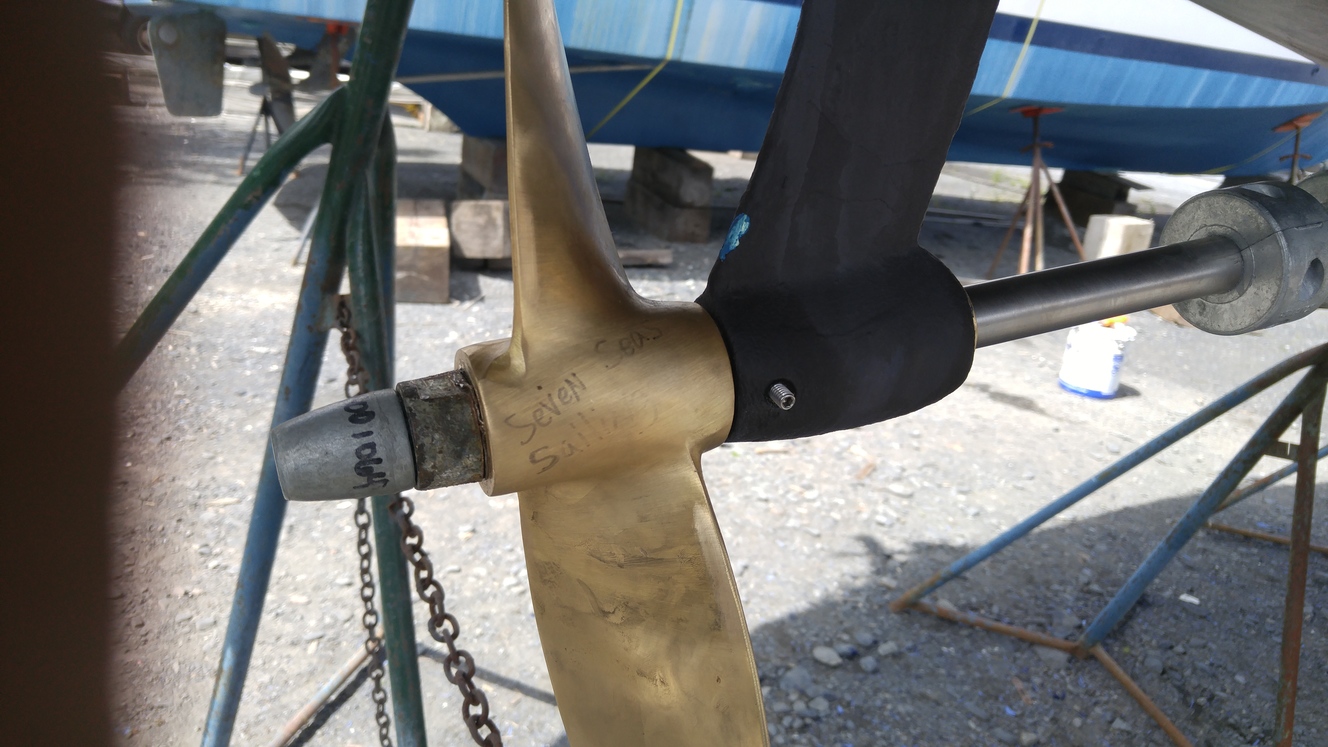

Do you have a folding prop that needs to be assisted to close by shutting the engine off and putting the shift in reverse to fold the blades and then all is quiet?

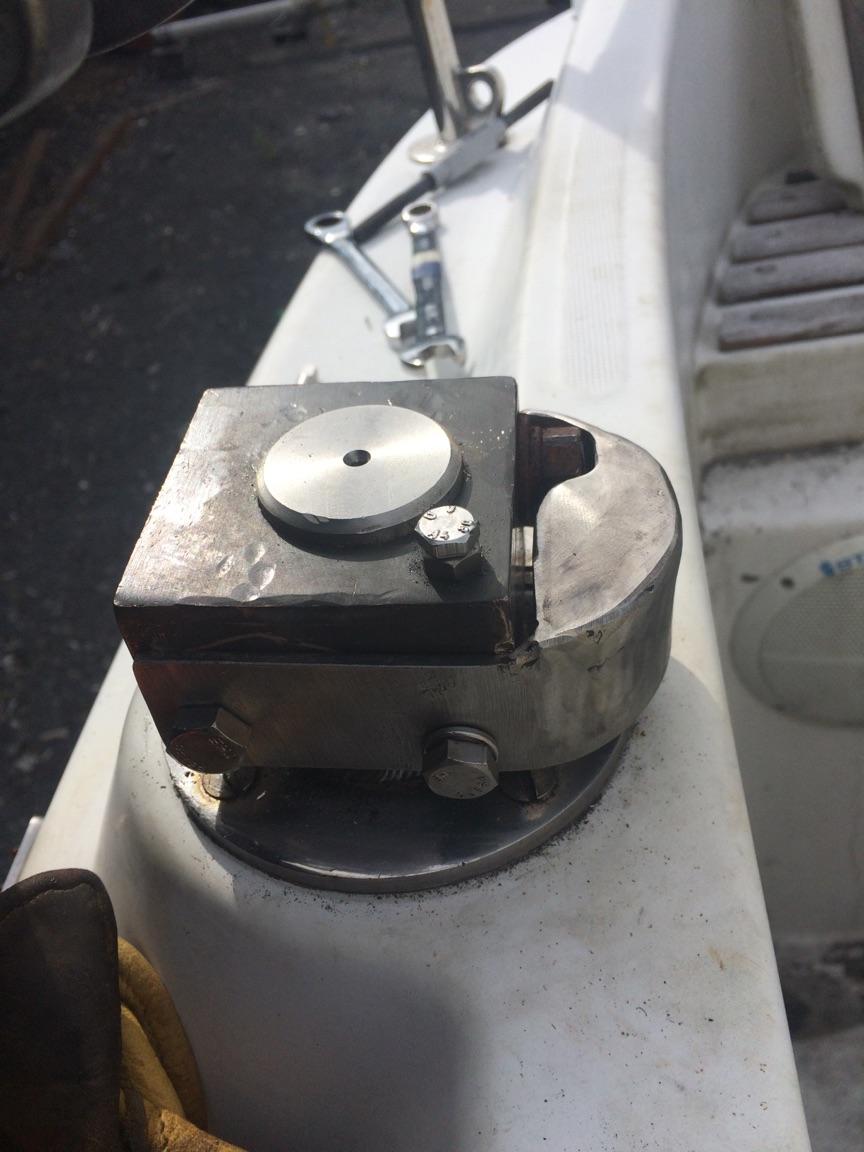

Make sure your rudder cables, chains, sprockets and wheel axle are all in good shape (no loose play). If not those items then go over the side and check your rudder for play in the rudder stock.

The boat has a single rudder (center). https://postimg.org/image/53i4m7rg9/

The rudder stop was custom retrofitted and I was told that the steering quadrant looks good. When the boat was hauled out I felt no play in the rudder. https://postimg.org/image/6k6jtb7tj/
Non-folding Prop: https://postimg.org/image/l0iywz0qp/
https://postimg.org/image/ffll55s9r/
Wheeled steering and the steering has no detectable play.
So in terms of knots I noticed it a heck of a lot more at 7 knots than I did at 5 and nearly no issue at around 3 but obviously I was trying to get back into the port fast thinking I might be losing a rudder.
