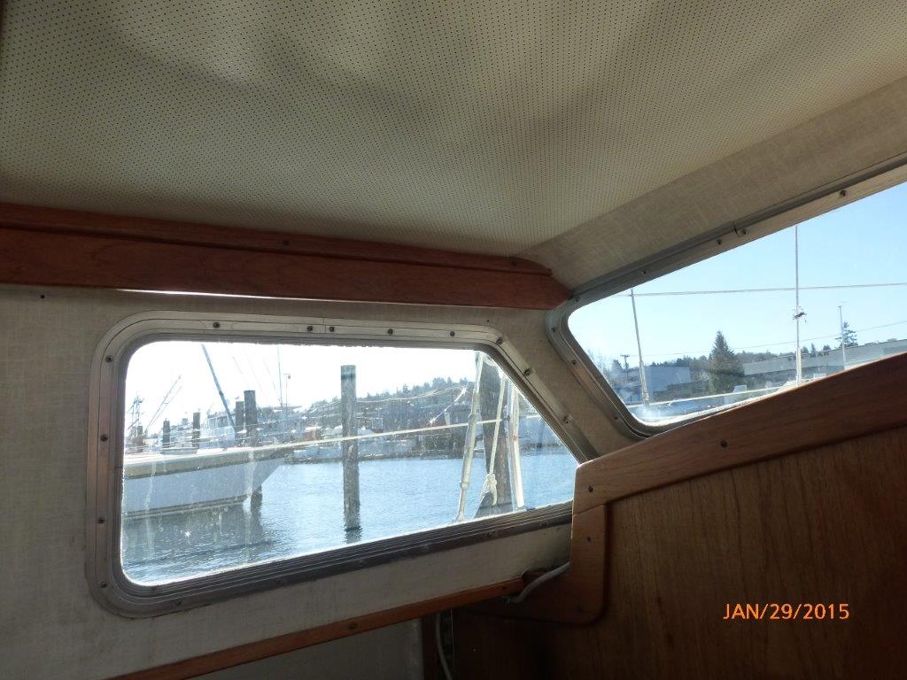

Hi Brian. Coming to the question a bit late. I think to answer the original question it can be any of the materials you identified. I have nine ports that surround my salon. They are laminated two layer glass. I'll be replacing as many of them as break this spring. It has come the time that the seals holding them in place have dried out and they are now wicking water into the cabin. Separately, but in concert, I will be removing the trim pieces. Cleaning them and reinstalling them hoping to get another 20 plus years of service.
