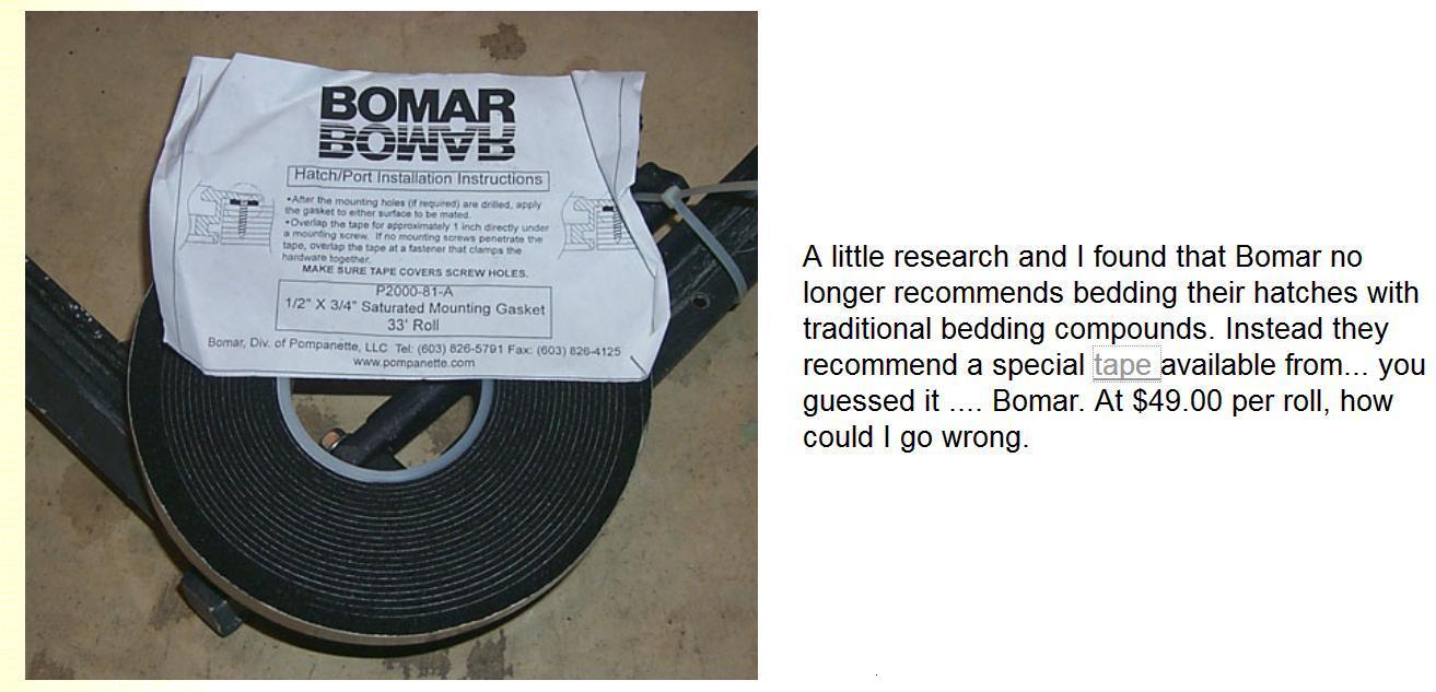

Found this in my records from a few years ago:
Seems like a good material. The gasket is not a solid dimensional item but tape. So good so far. The next step is yours.
Tell me where you're at and I can describe exactly how to remove, fabricate, and install the acrylic glass (for a small gratuity).
