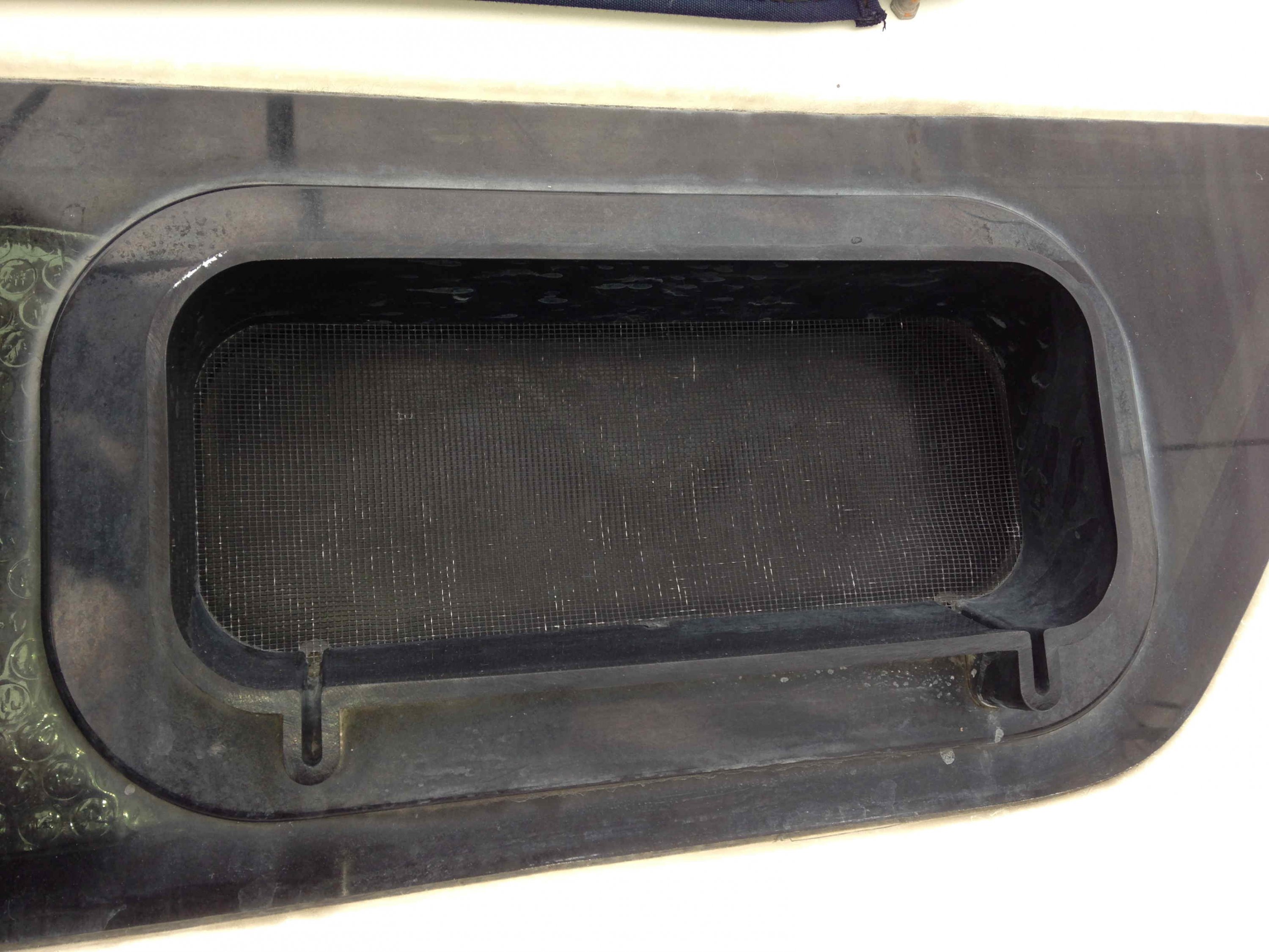

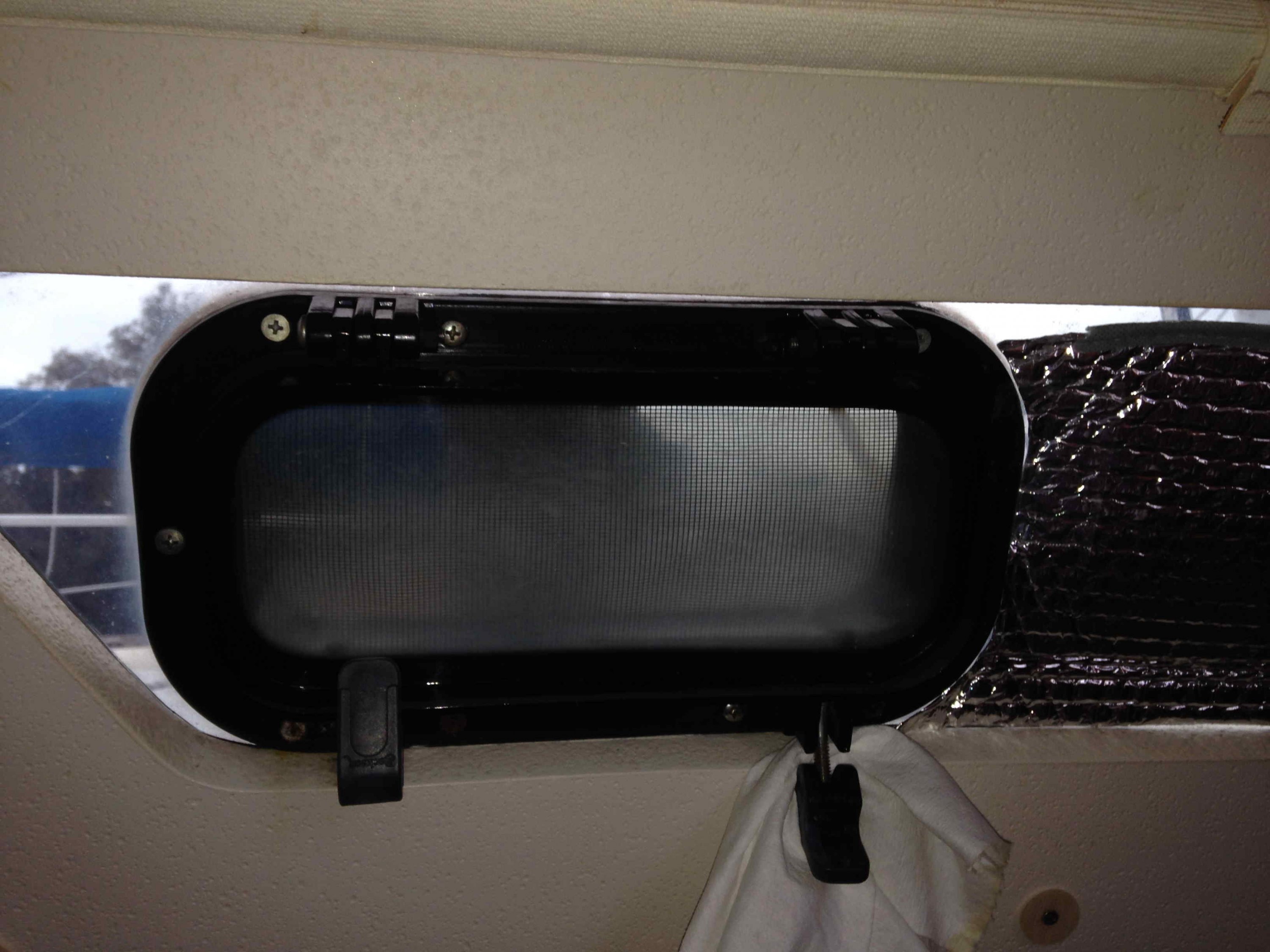

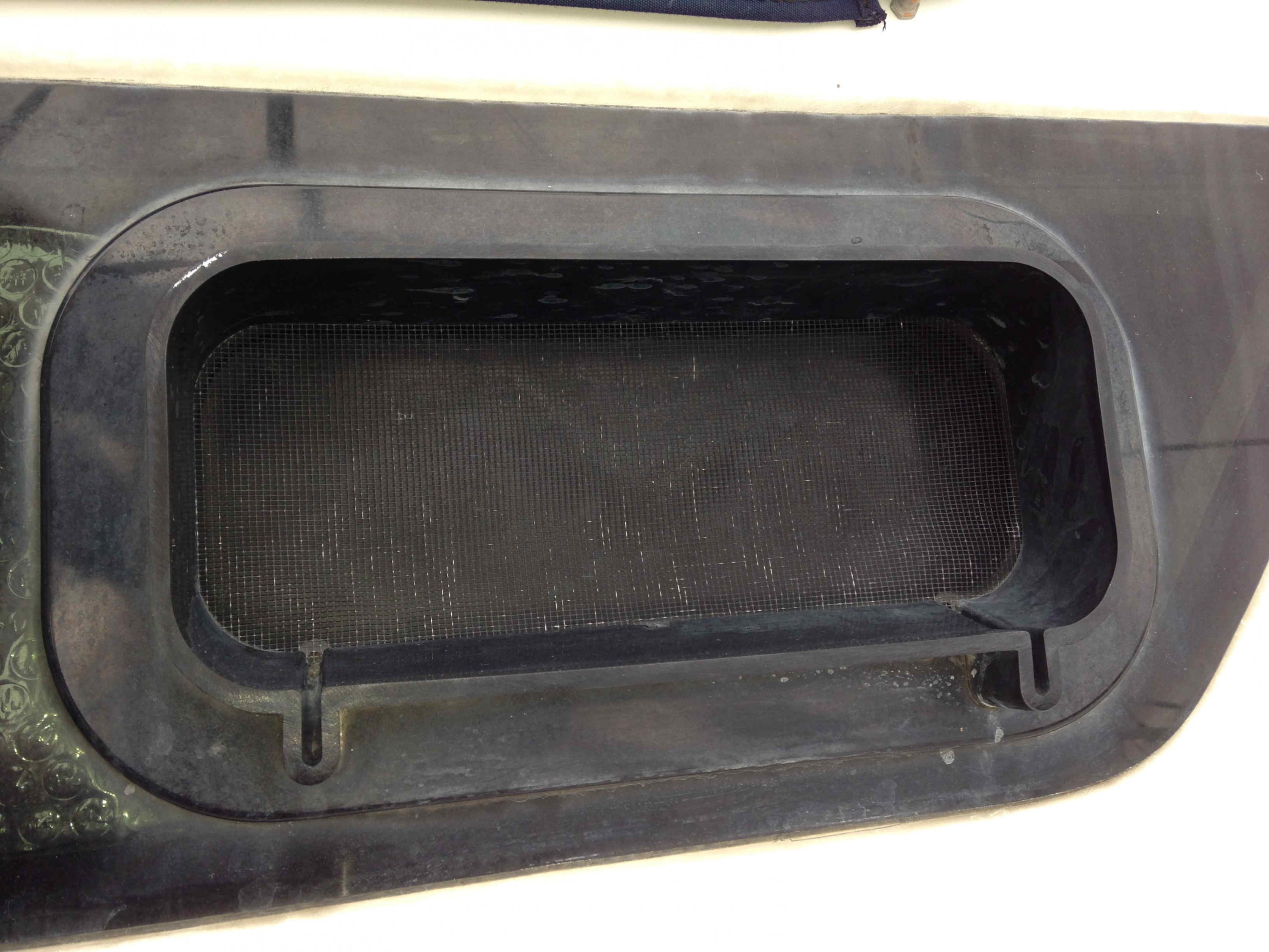

Do any of you C-310 owners know the make / model of the port light over the stove? I need to replace mine. A pick up crew member close the port when it started raining without asking how to do it. They broke out the plastic that held the hinge pin for the closing clasp. I tried fixing it by building up epoxy with carbon fiber, but it came apart.
Measuring mine, the outside dimensions of the flange are 12.5" x 6 7/8". The dimensions of the actual port light are 10.5" x 4.5"

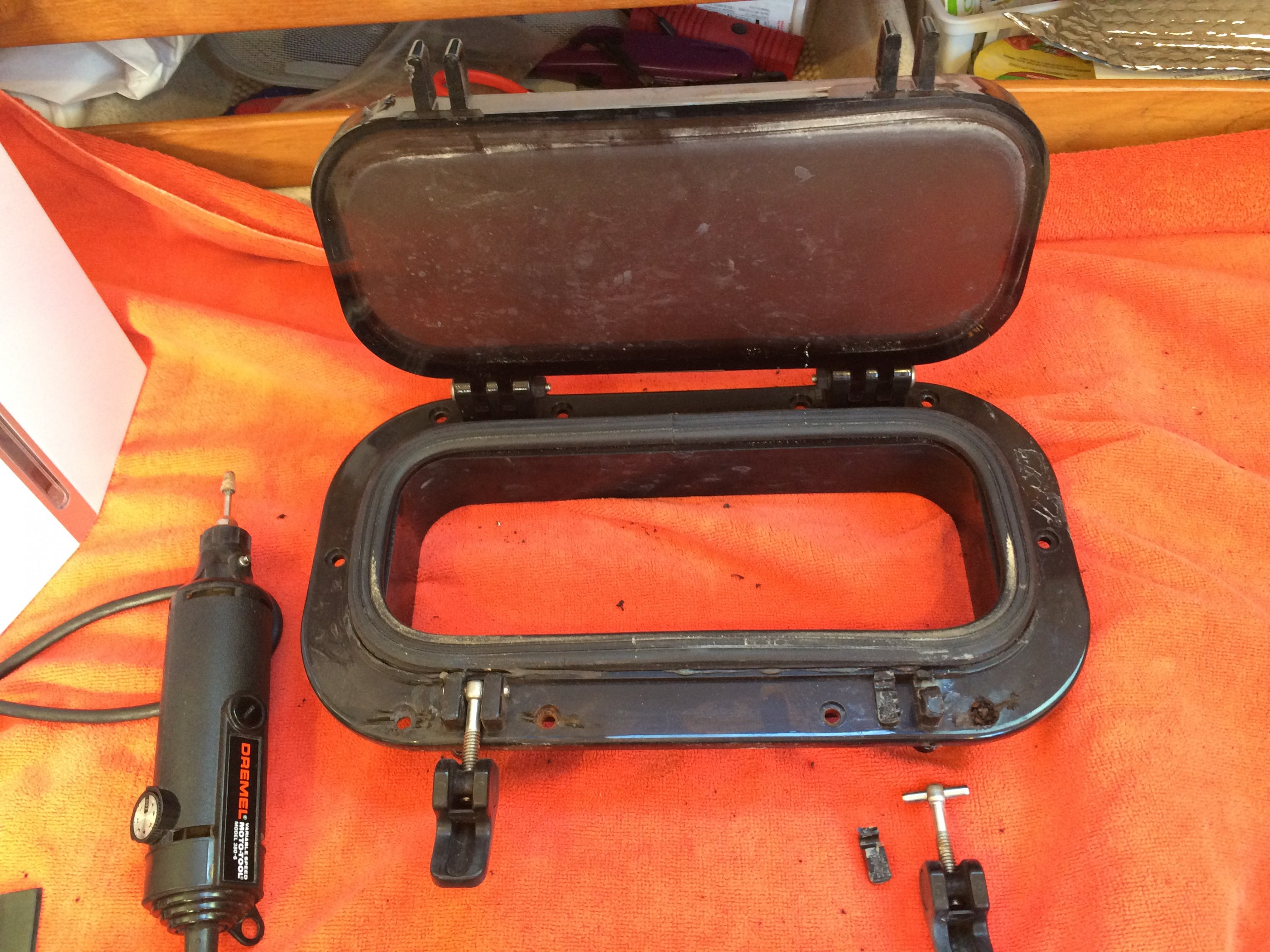

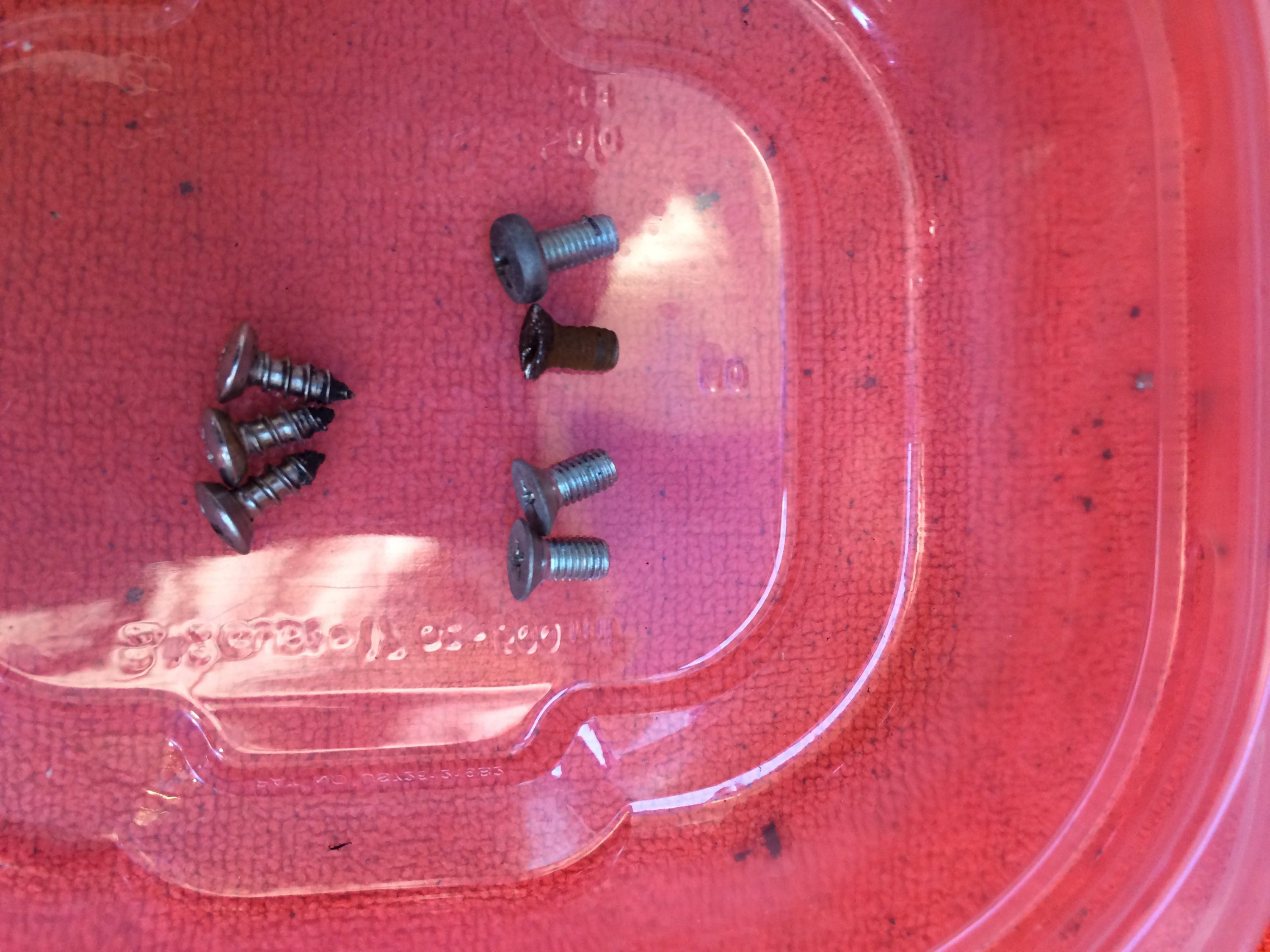

I removed the old port light yesterday. I found that the PO had not done me any favors.

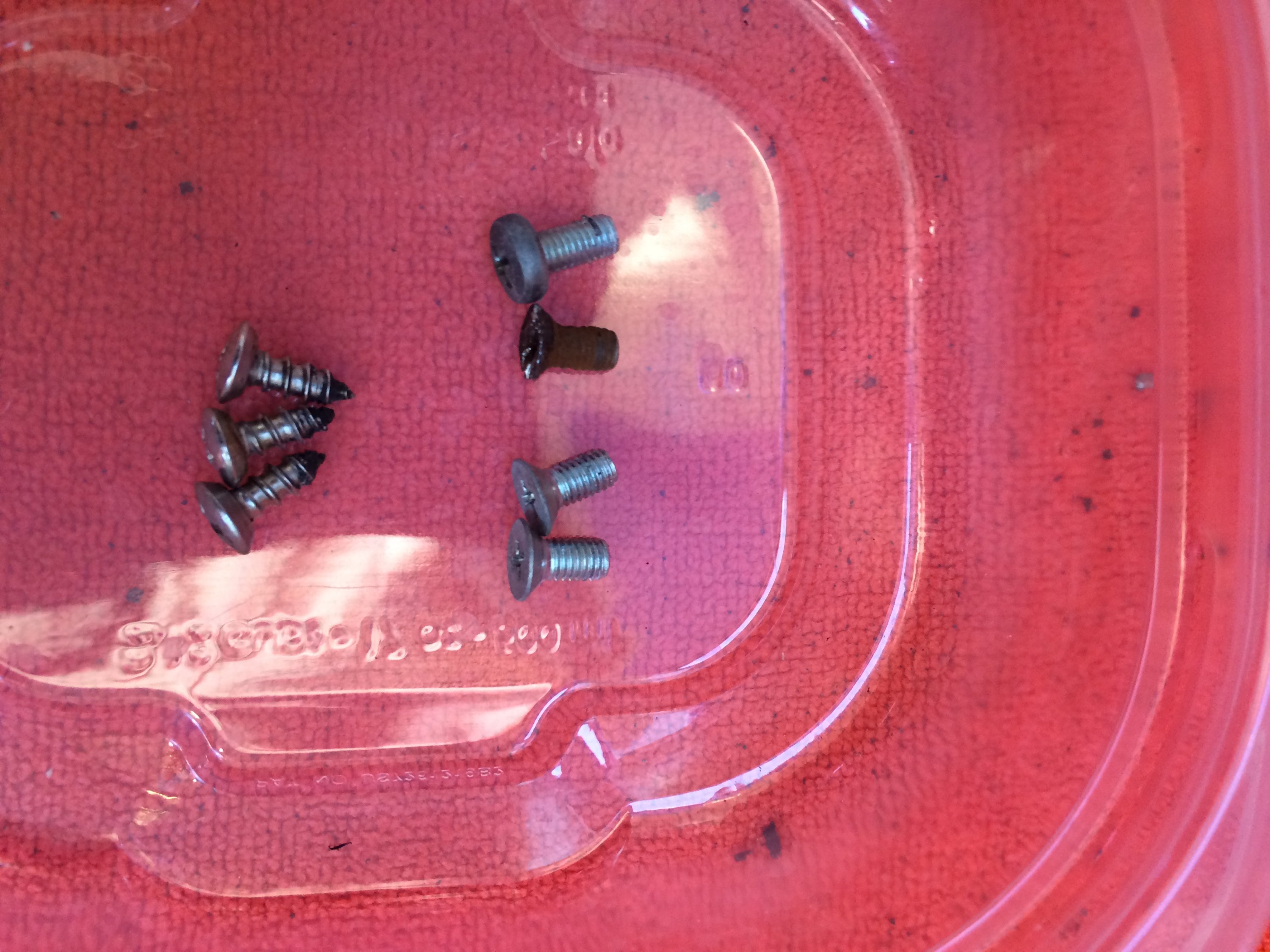

1) It has 10 fasteners. There were four different types installed, including four bolts. It is supposed to be in with 10 stainless wood screws,1/2 inch, oval head. Three of the screws were not stainless, and of course all three had rusted heads. Insert phillips screw driver, turn, and instant head strip. I used a Dremel cut off wheel to cut in slots. I was able to back one of the three out. On the other two the head broke in half as soon as I turned the screw driver. I had to grind the heads off with the Dremel, then used wire and a putty knife to cut the sealant, and back the port light out over the remaining two studs. The studs were removed with pliers
2) There were two different sealants. It looked like old silicone clear had yellowed and was caked onto the original sealant. It took a while to clean it all up.
The pictures show the old port light, with the broken dog latch on the right - the reason I removed it. The second picture shows the assortment of screws. It should of been 10 of the items on the left in the picture.
