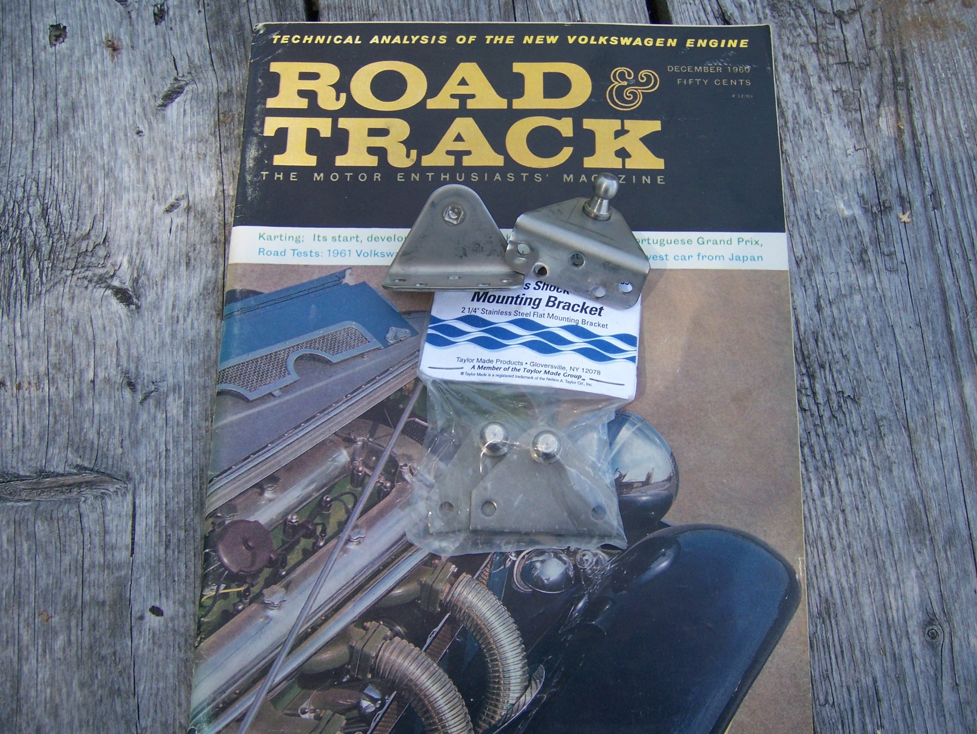

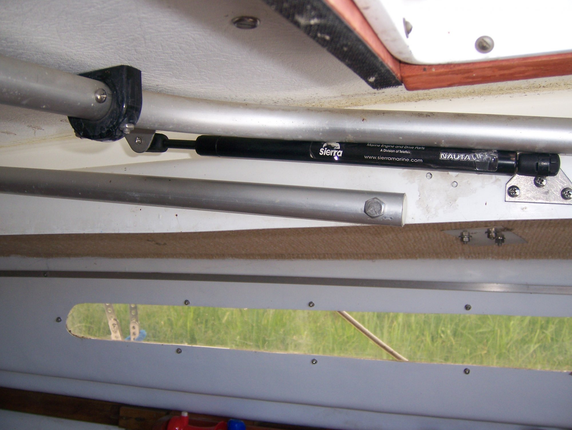

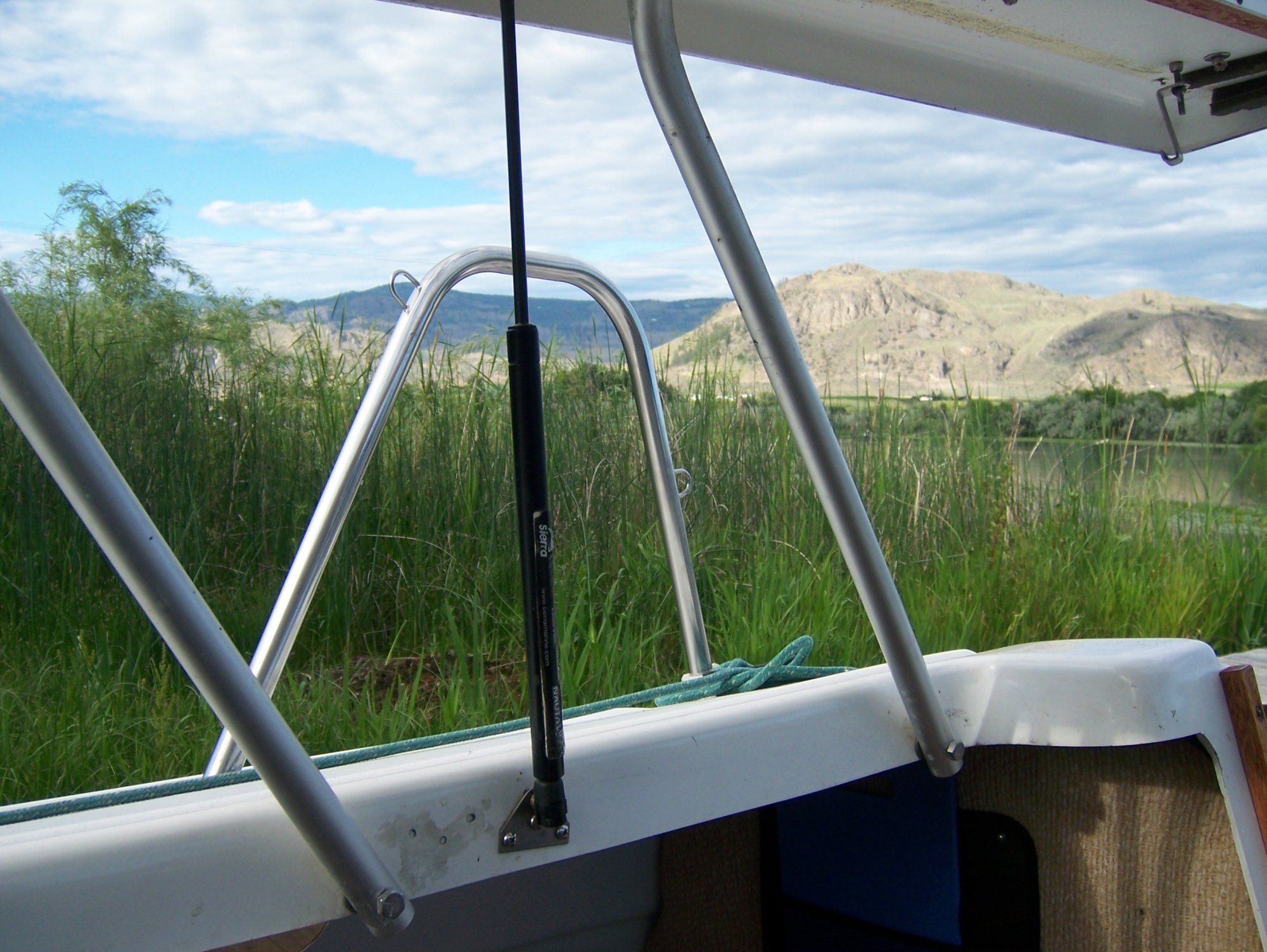

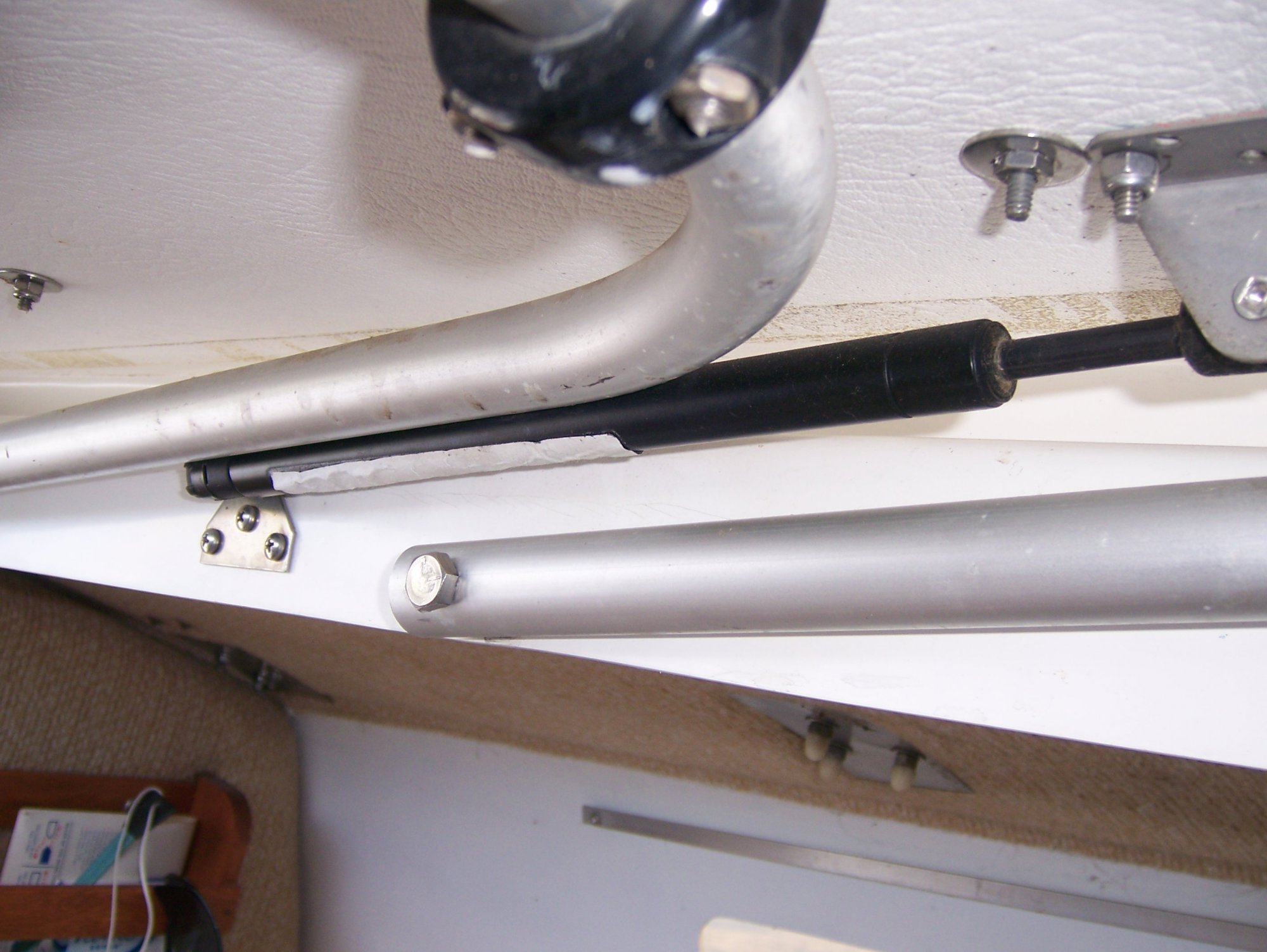

I did this several years ago You can see where I had to reposition the bracket so that the strut would be straight up when extended. It still takes a lift for the first few inches till the struts take over.

So they work better if they are extended straight up? I was not sure how to do this. Did you attach the top first and let it drop sraight down to mark the bottom bracket. Are they stainless steel brackets or can I use the steel ones on Amazon?

They don't give enough support if they are on a slant. As you can see by the extra holes, the installation was trial and error. My finish work isn't much, but then again, it's a MacGregor. I used stainless brackets.
