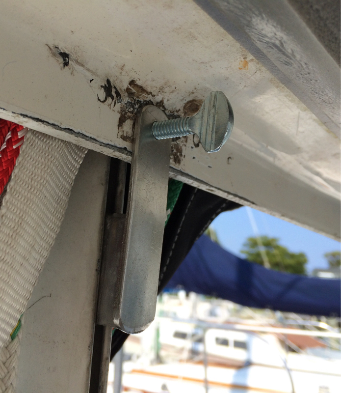

There is a hole now, that thumb screw goes back into the slot on the mast. The admiral is now safe

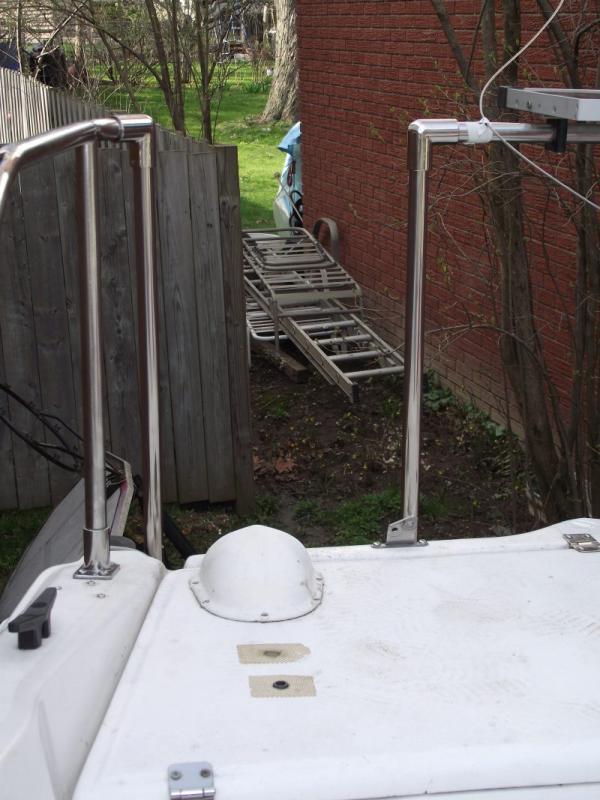

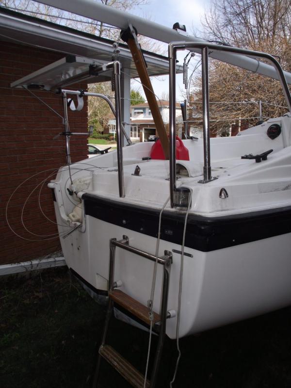

Once your ladder is mounted, you may want to do this next...
I wanted a "step through" stern railing - one that was strong but also one that was clean and simple (and not looking like a "mobility aid" with a ton of extra tubing and bracing.
The solution was locating two holes in the fiberglass i such a way that two vertical pieces of stainless go through them and up against the transom.
I spaced these vertical tubes so the can tie into my "L" reinforcing for the swim ladder. Tying them together lets the swim ladder force cancel out the force on the vertical tubes.
You can see from the pictures that this is extremely clean, uncluttered and stronger than any solution I have seen to date.
I placed everything so the ladder folds into the opening - with a release line you can reach from the water.

Another option that has no strength problems and gives more steps above the existing ladder we had.
Added an extension on the bottom later to help getting on the ladder while swimming and ...
The upper steps allowed the diagonal brace to be added to turn the ladder into a tow bar for the dinghy and also as a loading platform to get in and out of the dinghy,
Sumner
