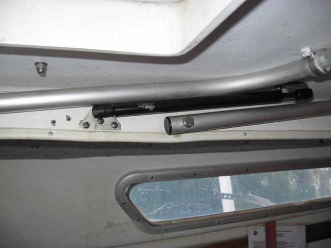

On another thread someone was asking about adding gas struts. I used 90lb. 20" struts, WM sells 2 types of mounting tabs, straight and angle, I used 2 of each type. I mounted the lower bracket where the original j bolt bracket was located. make sure the struts don't interfere with the support arms when folded down, and locate the upper mounts so the struts are vertical when the top is up.
