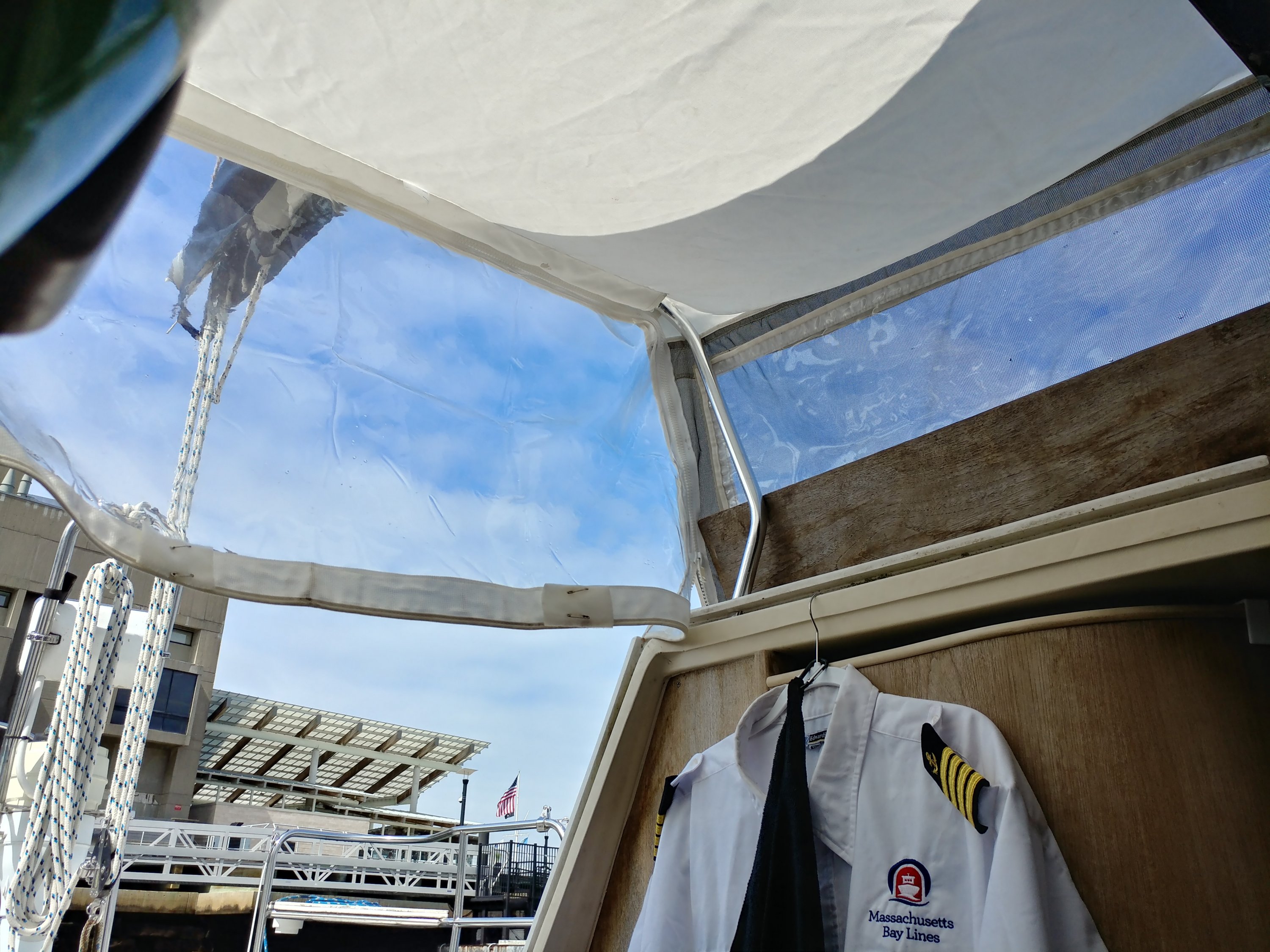

How do you guys take up the slack in the poptop enclosure? Mine droops pretty badly.

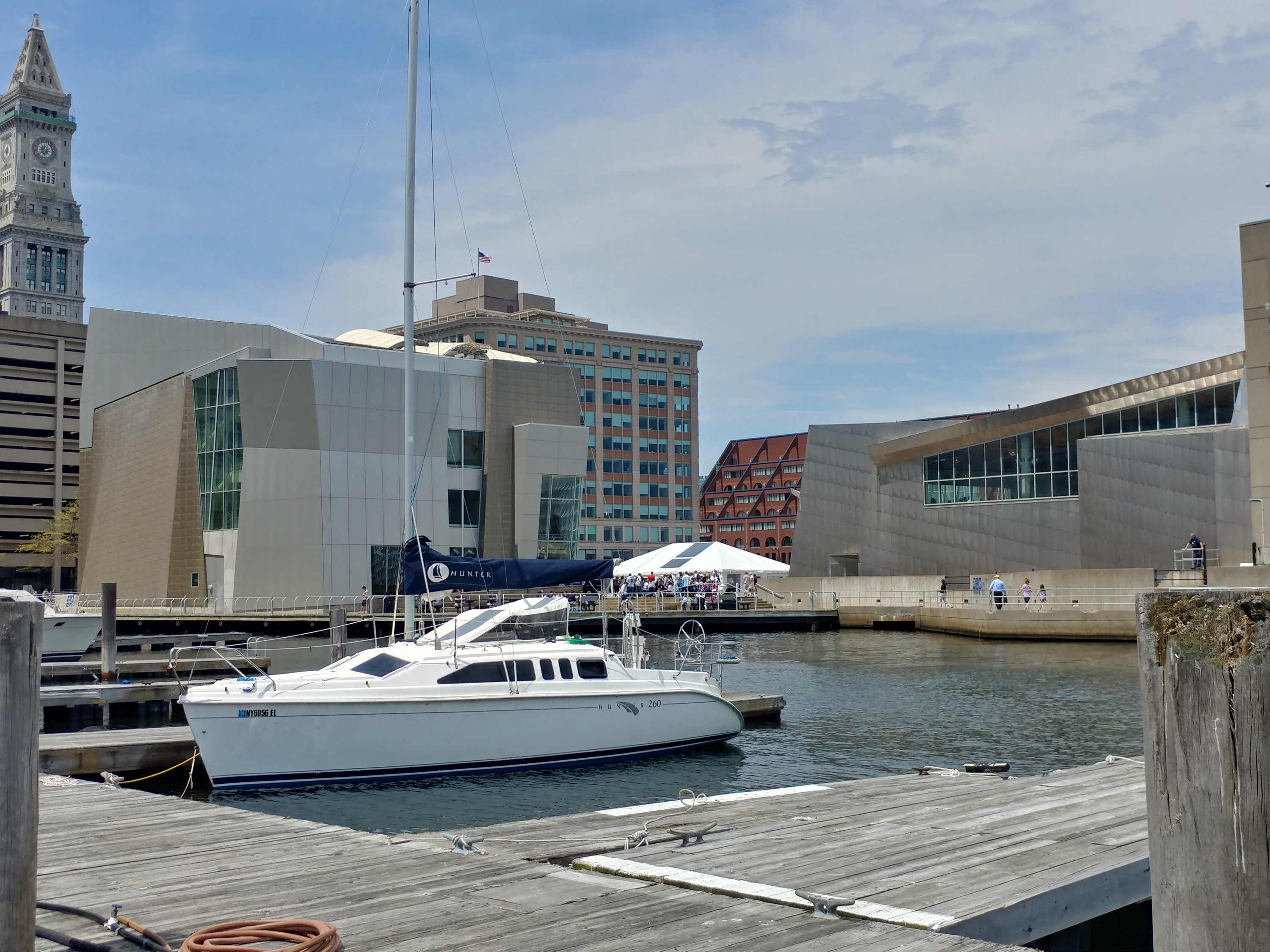

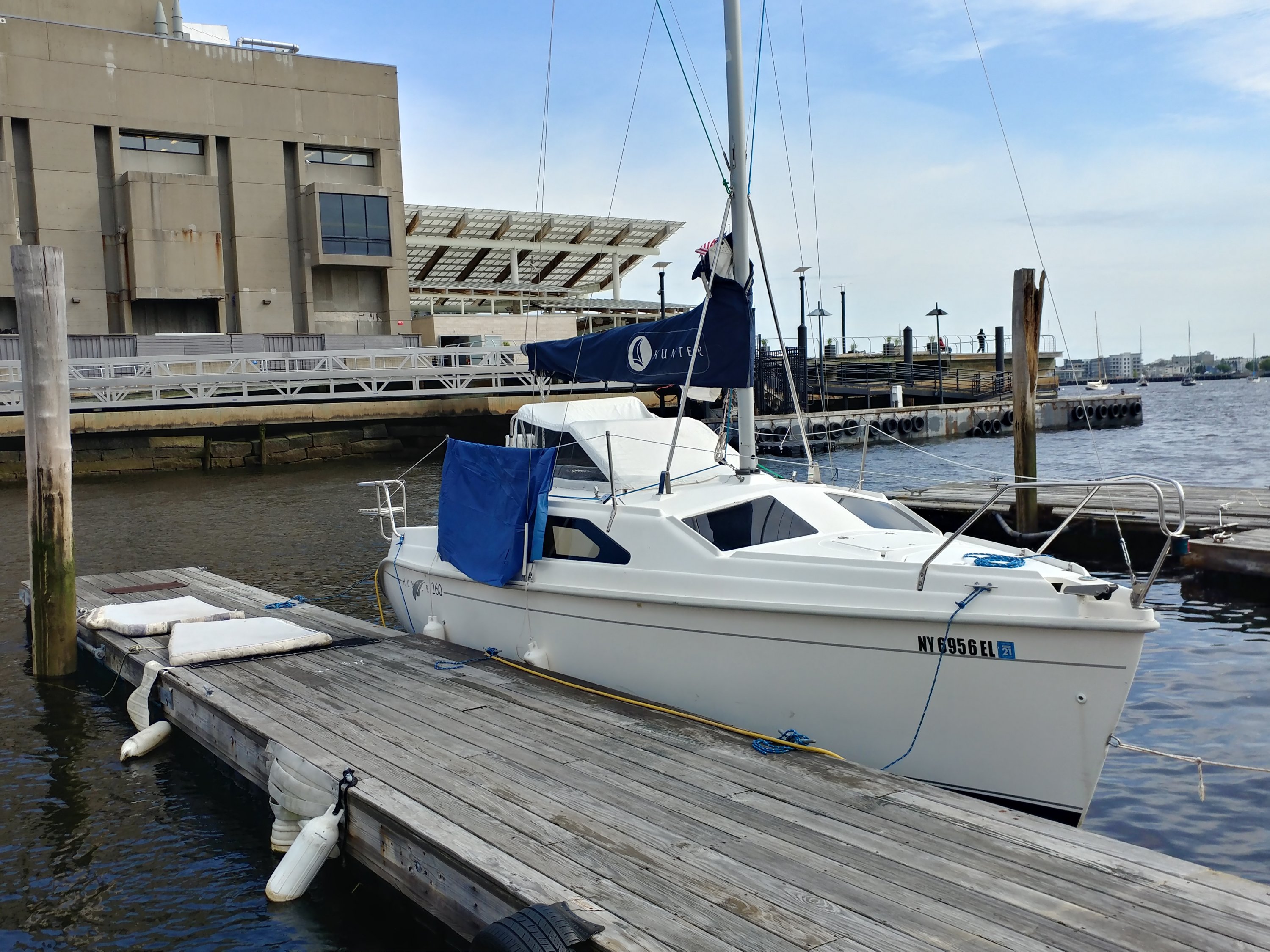

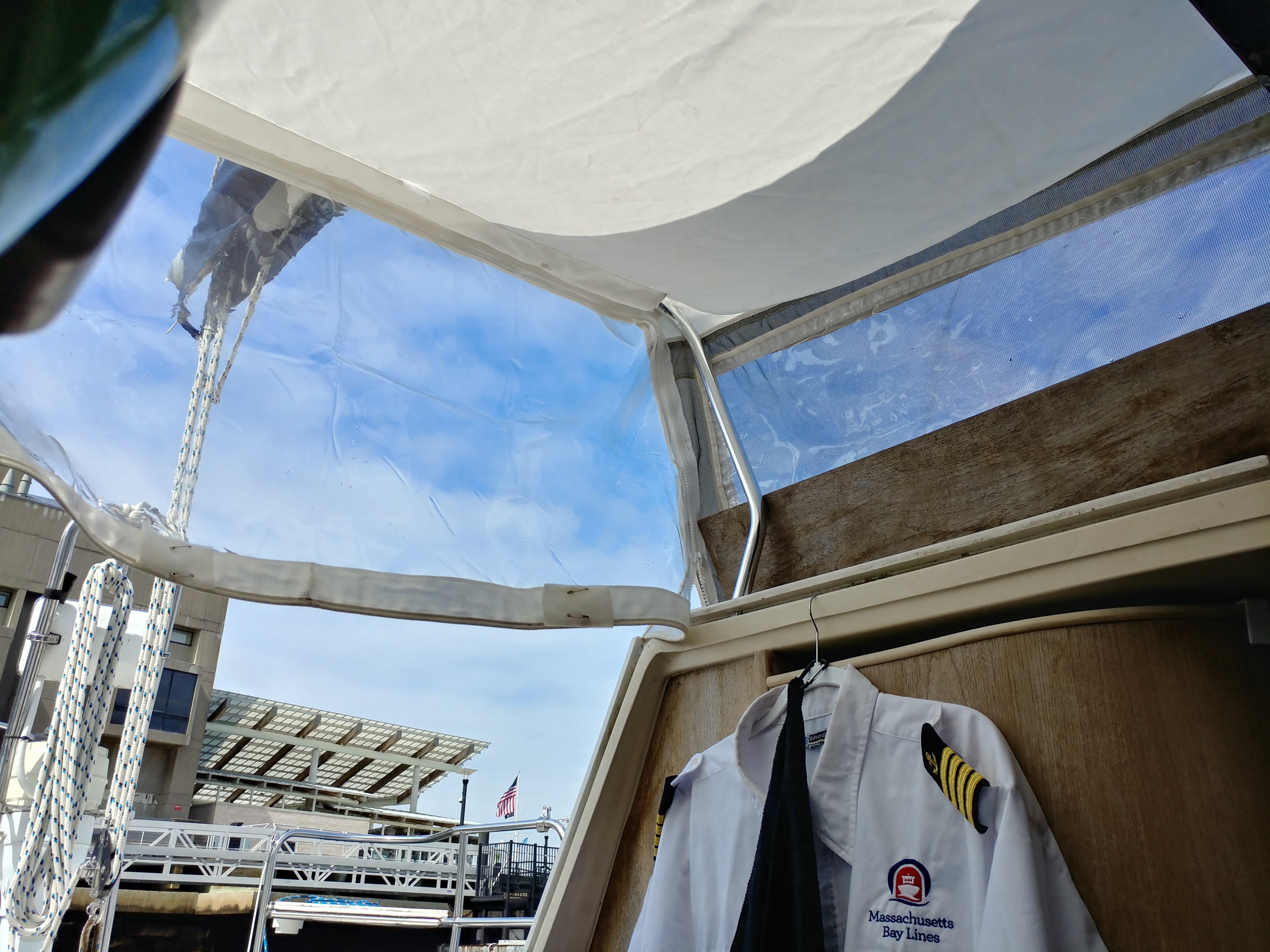

I can get better tomorrow if you need them. If you look at the canvas pop top its sags. I know Im not the only one with this issue.

I believe that the back bow should have a bend in it to make it sweep back from vertical. From the pic it looks like the aft end of the enclosure is vertical.

Not sure if you are the original owner or if this is new so I am going blind on this. Does the aluminum bow or rail is sticking straight up or does it have a bend on top of that rail? Photo of rail please

Thanks for the replies, the aluminum rail is bent. I am the original owner. I have also tried to adjust the poptop supports to no avail.

is the bend portion facing outward toward the cockpit? If So can you take a close up so I can see what is going on. I was involved with that design when it was measured by the manufacturer.

something is definitely odd about your installation. My recollection is that the bar should protrude vertically from the hole in the companionway slider and then the bend should sweep it back.

Is this picture good enough?
It sure looks like the legs are not seated down all the way. I don't have an enclosure, but I checked my H26 and there is a hole on top where the support would insert, and then the bottom part of the rod would be held vertical in an indentation, making the bent part lean aft. In your pic it looks like the bottom part is not vertical, if it was it looks like the slack would be taken out. Are you absolutely sure you have the supports seated all the way down?
