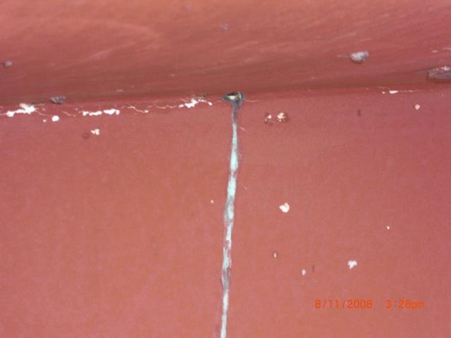

Anyone having problems getting the dealer or Beneteau to do work on their vessels? Our boat is four years old and the keel is taking on water, rusting, chipping away. I have called, emailed and nothing. My husband is almost 70 and I bought it for him thinking good investment. We have encountered nothing but problems and no help from anyone. Is it a WOMAN thing or an ELDERLY thing thinking they can get by with it. We have caps on water tanks that were cracked and repaired with a rubber glue that caused water to come in to the vessel. Gel coat cracks, window leaks the list could go on.

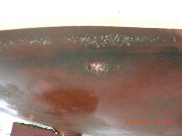

Looking at your pix, I am very surprised at the condition of your 4 yr old boat. Did you buy the boat recently or have you owned it all along? If the former, was it in charter? To me, this looks like a maintenance issue, not a manufacturing defect from Beneteau. The bottom (and keel) don't have much paint protection from rust, and at least one of the fiberglass dings is from an impact. The crack looks like a repair gone bad, and you mention poorly repaired caps using rubber glue (not marine caulk). So, I don't think you can blame Beneteau.
I recommend that you have the boat surveyed by a professional, independent boat surveyor. He can tell you more about the actual condition of the boat, probably causes, and approximate costs of repair. Then, either go back to the Beneteau dealer that sold you the boat or get a reputable boat yard to do the work. You don't need to go to Beneteau directly, unless the boat is under 5 years old and the problem is covered by warranty.

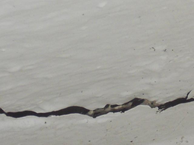

Looking at the pictures you provided, I would agree that these seem to be maintenance issues. As for the cracks... It would seem as though the boat hit something hard at on time or another.

We bought the boat new, made for us. The cracks are in the anchor locker and we have a electric windless so it comes in slow and smooth. The boat has never been aground and we have never hit anything to do that kind of damage we would have known we hit something I would think.
The first time we pulled the boat after two years you could see the while squares where the jackstands were, no paint at all. The boat was on the hill for 43 days in 2009 the second time drying out the keel that had taken on water. Per Beneteau's instructions we dried it out and they resealed it, tightened the bolts to Beneteau's specs. Here we are again 2010 the boat is on the hill drying out the keel.

As far as the gelcoat hole, I've experienced them. They are voids in the lay up. I don't consider them to be a big deal. That is a LOT of fiberglass to lay up when you think about it. Mine voids in the cockpit were found under warranty and fixed under warranty. As far as the rest, it sure looks like poor prep when the bottom was painted, including the keel. And, I'm guessing someone didn't caulk the keel/hull joint correctly, or re-torque the keel after a while (I noticed Beneteau once recommended this in 2000 (my first B), but doesn't seem to in the new owners manual (my second B)). Unfortunately, it does sound like you've had more than your fair share of problems, including several that appear on other message boards. They just never ALL seem to show up on the same boat at the same time.

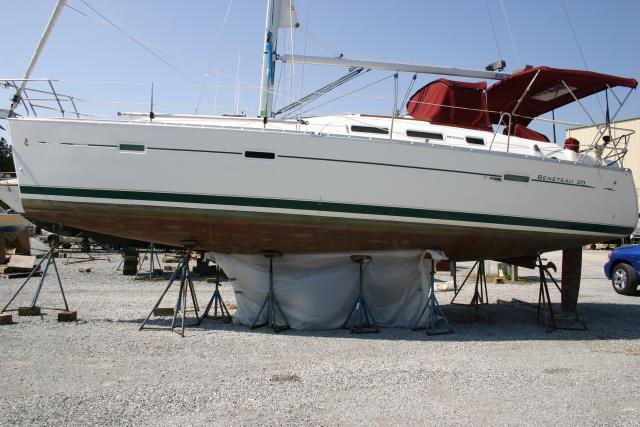

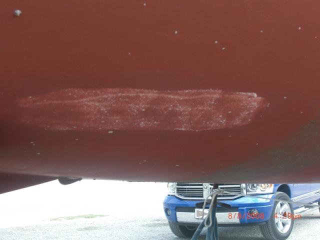

These are the bottom of the boat the first time we pulled it. Yep, you are seeing white spots where it was on the jack stands and they painted around them and never went back to paint them.
Like we would not see them at some point. March 2006 the boat was delivered to us the boat was pulled for a bottom job on 8/8/08.

From the pictures and the long beard on the bottom, it doesn't appear that you're maintaining the boat. I'd have those ducks in order before pointing fingers. I'm not ruling one way or the other but I'd always want to be side of keeping my end of the deal. They'll pick up on that. Plus, with Beneteau being run my woman, it will just make it all the harder.

I pull my boat seasonally, and carefully inspect the hull and keel and have not noted the deterioration you document. I have owned boats with cast iron keels before and know the interlux speced system they use at the factory is good. None the less, I have had a few rust spots appear, primarily due to some minor scrapes, sandy bottoms etc. and have properly repaired same with Interlux 2000, including additional coats over the entire keel, and had no rust spots over the past year. No keel bedding issues have been evident at all.
To me it appears your initial prep and bottom finish may not have been up to par. In our environment yearly bottom refinishing is required.

My ducks in order? The white spots are what we found when the boat was first pulled. Two years after it was put in the water for the first time. Second, the botton is cleaned every two weeks by a professional. The boat is four years old 4 years old it is cleaned and has been pulled three times in four years. Your telling me a new boat with water in the keel is normal? White spots from where the dealer did not paint the boat where the boat sat on the jack stands is my fault? Are you blind have you not seen the photos. NEW BOAT 4 YEARS OLD what part of this do you not understand?
Get my ducks in a row first. I did that is why I have been calling non stop and emailing them with no response. The paint dealer Interlux has seen the boat, we have done electrolist (sp) on the water, docks and boat and the company said it is right. The boat yard is the one we were told to use by them. I put the most expensive paint on the bottom Micron66. I have my ducks in a row so I am completely at right to make my comments. Do you happen to work for either one?
