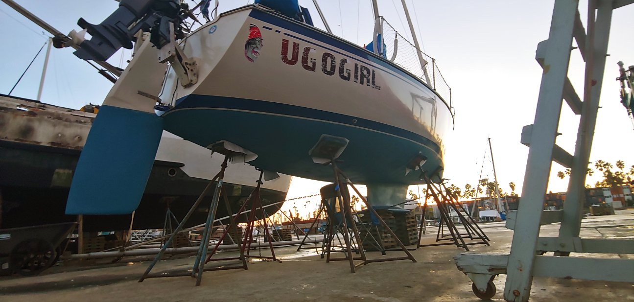

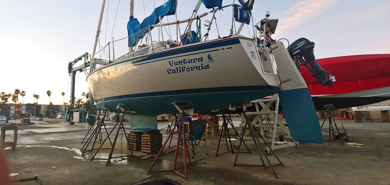

So I am king of poli glo. Finally wanted to get away from it after 15 years. They make a heavy stripper. You have to use it. Compounding will take it off but after many runs. It's so funny I just saw this and I just finished stripping mine and compounding and waxing my 272. Results!
