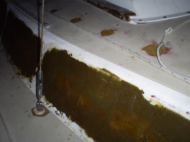

This is what it looks like now except sanded flat. Sooo I think it would be a little better if it were some hue of white instead of this.

I assume you filled your ports with something more than polyester putty, but with layers of fiberglass laminates (cloth, mat, etc.). When you color resin, you don't get a great opaque color. You are actually better off using gelcoat. Gelcoat is a polyester product too. Don't be afraid of it. Someone said go to the paint store and get some paint to apply in that area. No, no, no. It is ok to paint the whole deck or boat, but not just an area. You can buy white gelcoat with wax in it so it will cure without covering it with plastic or spraying a mold release (PVA) over it to cure it. It will cure on its own, if it has wax. You can simply paint it on with a brush after you catalyze it. You use about 10 to 12 drops of MEKP to each ounce of gelcoat (this is a little hotter than resin). Figure an ounce is about a golf ball size. Mix it in a paper cup and use a cheap, disposable brush, and brush it on. If you want to thicken it up a bit, you can use cabosil. After it cures, it is sandable. I would actually take a polyester putty to smooth out your repair job and then clean it with acetone after you sanded it with 80 grit sandpaper. Then paint on the gelcoat. If you want to spray it on, you can go to an automotive store and buy a Preval sprayer, which is a little powerhead unit that screws onto a glass jar. Put the gelcoat in the jar (it holds up to 5 or 6 ounces) and then catalize it with the MEKP. Then you must thin it with acetone so it sprays out nicely and then paint the area. The spray pattern is not very big, but it works. It will be a smoother application than brushing. But, remember, brushing it on thick will give you enough substance to sand. Use 320 grit wet paper, then 400, then 600 and then after that you can actually buff it out with a fiberglass rubbing compound. Even if you don't want to do the sanding and buffing, I think you will find brushing on the white gelcoat will satisfy your needs based on what I have read. If the white gelcoat is not exactly the color white you need, you can use small amounts of colorant to match the gelcoat on the rest of your deck. Good luck.
the problem I have with using gelcoat is, I am unexperienced with it, and I don't want to brush it because it is impossible to get a consistent thickness while brushing on. Too thick of gelcoat is a major cause of cracking. If I was doing a very small spot then I might be able to get away with it, but this is too many square feet. Just because it's polyester based does not mean it is interchangeable with polyester resin.
My only options are 1.leave it ugly 2. dye the resin 3.paint it with a compatible paint that will accept other paints like emron or two part paints. It is likely that when I go to paint it, any bare polyester or epoxy resin will have to be primed with something first. BUT I can't just prime it because primers are designed to absorb. I won't leave primer spots to absorb water while I wait to paint it.
There are many pounds of 24oz. 10 oz. and chopped strand in there. The green is short haired polyester to fill and fair around the edges of the fiberglass panel. I posted a lot of pictures as I went along. It was a nasty , nasty mess inside. It came out ok inside. It was much easier to work inside the boat on the relatively flat surface than on the outside curves.
