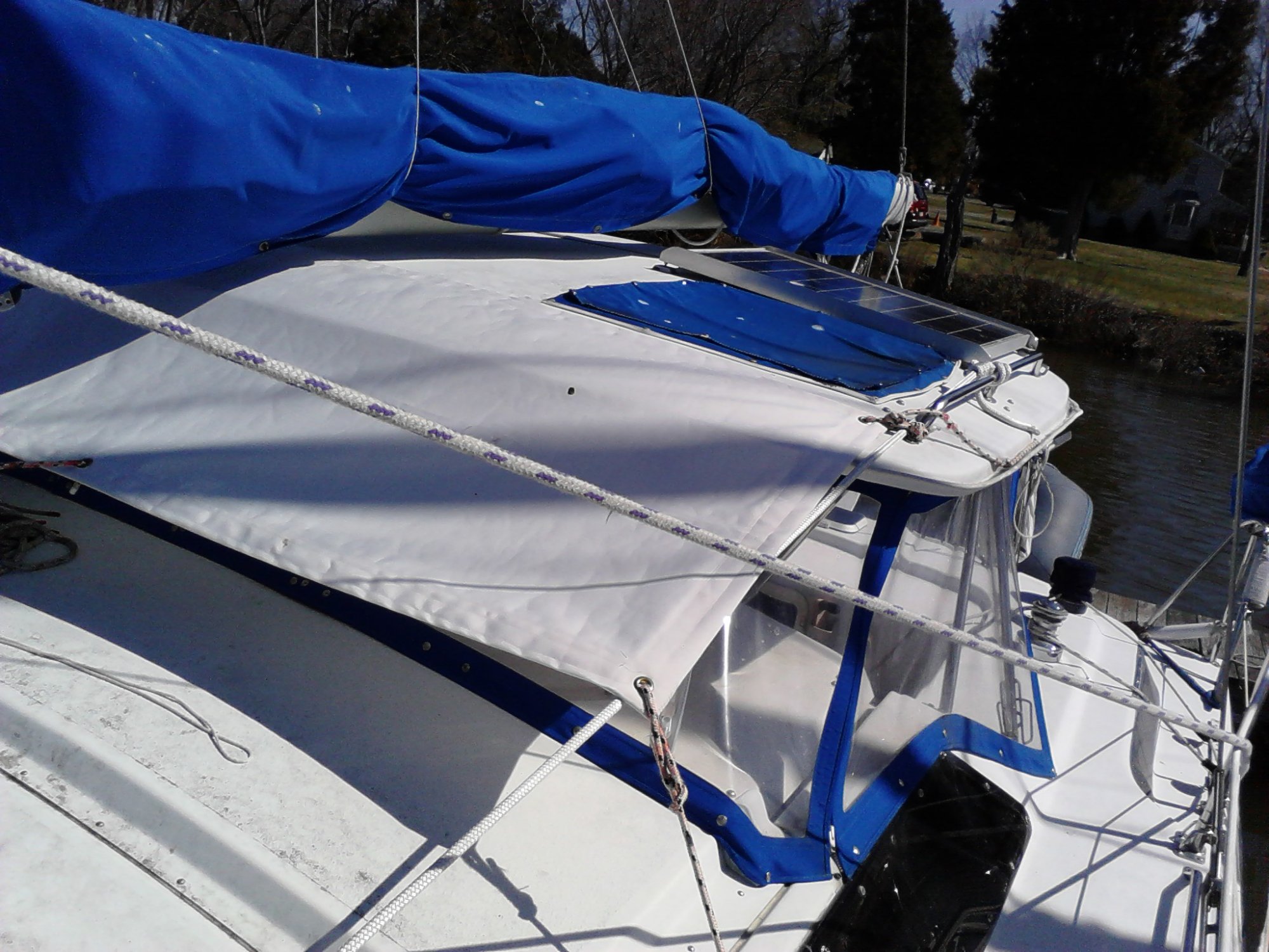

I rigged a low Sunbrella awning over my forward dodger window. It did not touch, so no chafe. It kept the bird bombs off, so much less cleaning. And it kept the UV mostly off the Strataglass, so much longer life. I was at 14 years and counting when I sold the boat. I had covers for all of the windows, though they are not in place in this image. The white supporting lines are actually jacklines, though something could be arranged on any boat.
