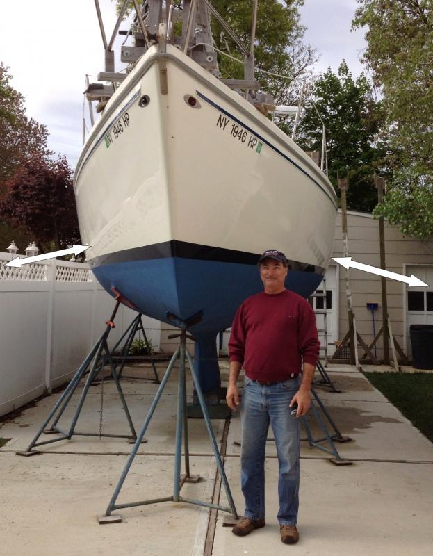

I've been using NewGlass2 http://www.newglass2.com/cgi-bin/cp-app.cgi
on my '77 C30 for about 15 years now. I disagree that you have to use it on an old faded hull. The idea of acrylic coating is that nothing will stick to it. Try sailing thru an oil slick on the very first day of launch. That slick will be on your hull until you compound it off next season. It will simply rub off acrylic. A bottle of New Glass cost $40. I can get 2 - 3 seasons, 5 -6 coats per season. It takes about 2 - 3 hours to put on 6 coats. No wax on / wax off. I has NEVER yellowed or cracked. Every couple of years I willl lightly wet sand with 1200 paper. Thats it! Check out the shine. See the reflection of the garage and fence!
