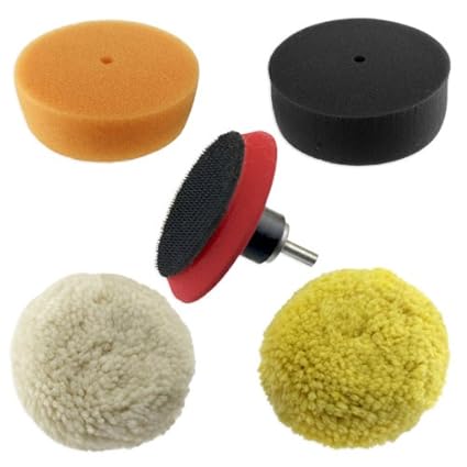

I've had good results with MS' tips on polishing my hull. I want to do do as well on my deck. The trouble is so many small areas and hardware to get around. I already ripped my GPS antenna off with the big Makita buffer. Doing it by hand doesn't look great. Any thoughts on this setup for a drill? I have a 90 degree drill as well as standard. Can't control RPM like the buffer. Any other success with polishing decks? At least all of the nonskid is easy with Woody's wax.

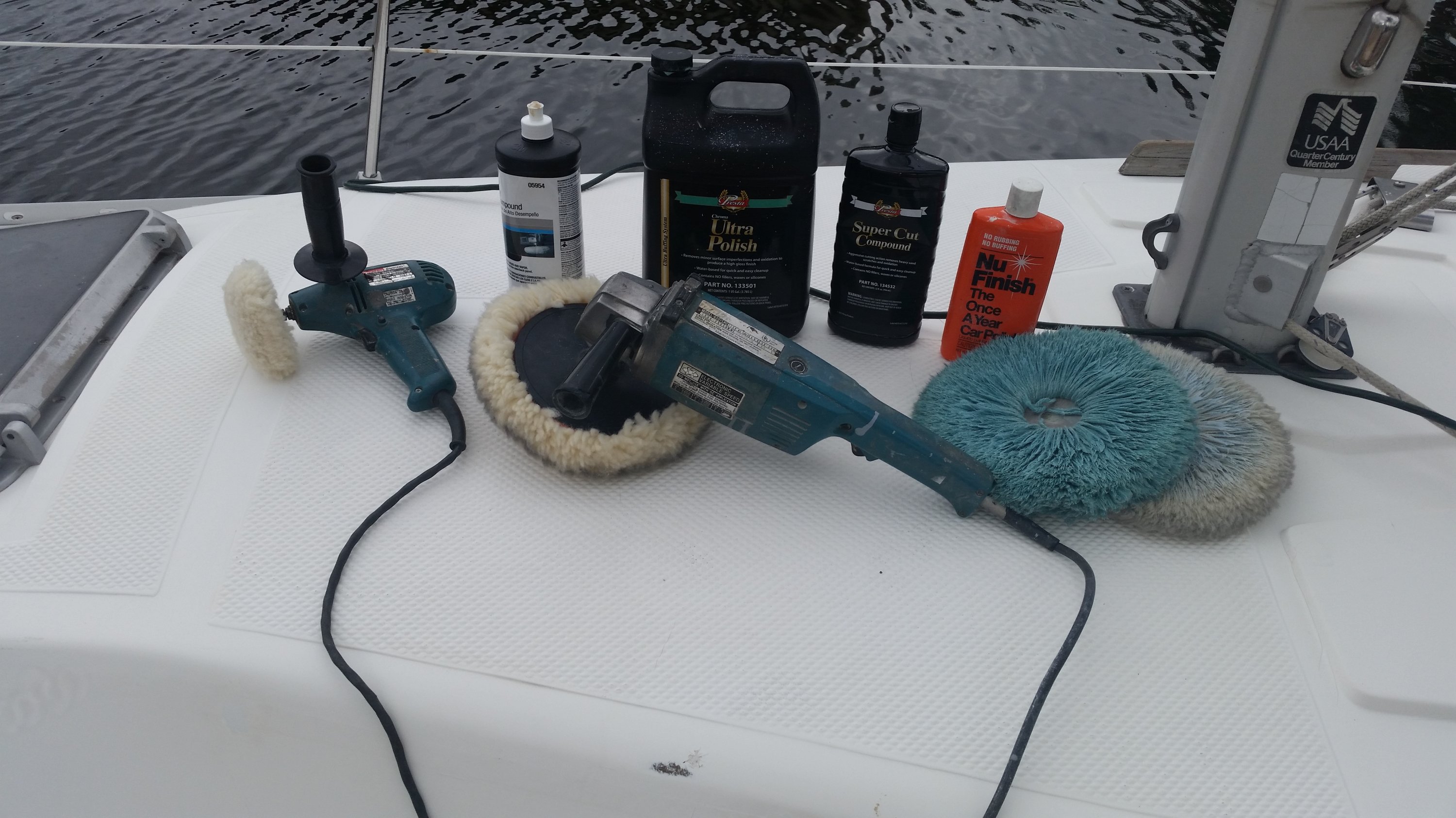

I ran into the same issue, and found a small Makita high speed disk sander that I added a 3" wool pad to. This worked out well for most tight spaces. but there will still be some areas you need to do by hand.

Paetco, can you get a model number off that little Makita? And any recommended attachment pads?

Mine is older, but I think the new version is the GV5000
Plenty for sale used on E-bay
I bought the pad from a local Auto Paint Store I don't remember who made it.

I use the Porter Cable 7424 and polishing foam pads and the wool pads. I get all my stuff at Autogeek.net. I also use their foam pad cleaner and conditioner. It keeps the wax or polish you are using from getting gummy. Swear by the foam pads that have the little indents in them, they don't clog up. The pads come in differing degrees of "cut" depending on whether you are cutting (compounding) or polishing. The nonskid is tough on the foam pads so get several as you will use them up. Here is a link to autogeek and the PC 7424 "kit" http://www.autogeek.net/hk7424.html
I use the same kind of pads and wool covers on my Makita buffer. All with Velcro attachment so its easy to swap pads and covers. They wash out well using the pad cleaner from autogeek and you will get a long use out of them - except the ones you use on the nonskid.
Darn it. I have to buy a new power tool. I see that they offer the bare bones polisher, or a different kit. This kit is cheaper but doesn't have the pad cleaner or conditioner. Decisions, decisions....
