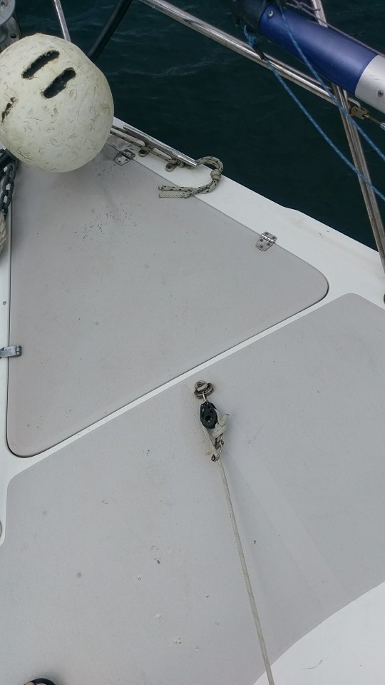

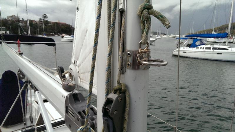

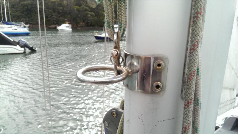

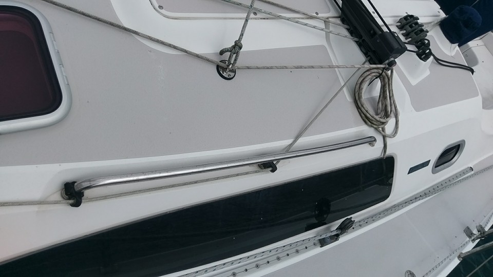

Couple more pics showing foredeck mount, we fitted a couple of guides on the port side hand rail to bring the kicker back to the cockpit Rope clutch.
Topper and kicker clutches are next to each other making adjustments simple .

If you run the jib car all the way forward, the jib sheet should supply sufficient downward pull. The Foreguy is rigged FORE to keep the pole off the standing rigging. I have a stopper knot in my Foreguy so it will be stopped by the rope clutch before contacting the stay.
