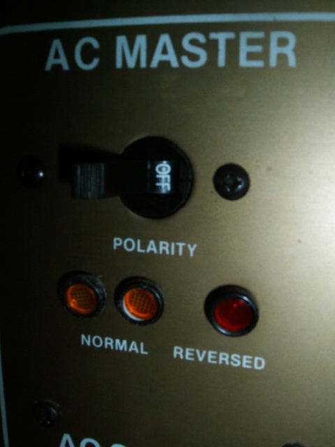

Polarity Light is on.....

Problem solved! I was at the boat this weekend and thoroughly and methodically went through the system. I checked all recepticles and all were wired correctly. I then realized that the newest peice of equipment added to the boat by the p.o. was a digital multibank battery meter. Logic said start with the most recent since it is doubtful that the boat has been wired incorrectly for 28 years. Sure enough - whoever she had install the meter (probably when the batteries were replaced last year) had cross wired one of the neutrals with one of the hot 22 guage wires coming from the battery meter. This was giving me the Polarity reversed light. Then I noticed a solid copper wire with a capacitor in the middle going from the hot main breaker to another breaker connected to the ground buss. This was causing the main to trip immediately when energized. So the problem was two fold. I correctly connected the battery meter leads but wasn't sure what the capacitor was for. I reconnected that from hot to neutral and everything worked fine.
Does anyone know what the capacitor might be for? It is a smal barrell shaped capacitor (I am presuming) with a stiff copper wire coming out of each end. It was shaped as if it was designed to jump from one breaker to another. It also had the letters OPU on it I believe. Any ideas what it is for and where it really belongs? It probably was moved when the battery meter was installed.

Concerning connecting neutral and ground: if there is NO connection between the two, you have a very safe system: you need to touch both hot AND neutral to get a shock, and that would PROBABLY be across a finger or two which would PROBABLY not kill you. But if the neutral is connected to ground ANYWHERE (even in the marina), all you have to do is touch hot and be grounded to get a shock(often one finger and your foot, so the current goes through your whole body). That's in addition to the galvanic problems associated with connecting the two.
I agree that you need to know what you're doing before diagnosing and messing with AC systems - that's why electricians need a "ticket". But one point: I beleive the reverse-polarity light will go on if one of the wires is simply not connected (forgotten which one...). If the AC is also "not working" that might be your problem. (Not necessarily completely not connected - maybe just corroded, possibly under insulation or tape)
