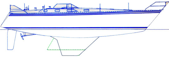

I've searched and read previous posts on this forum but haven't found any direct comparisons of pointing performance by any one who has sailed both models of the 1985 Hunter 40. By both models I mean the deep draft ~ 6' versus the shoal draft ~ 5'.
The reason for my question is that I anticipate doing a fair amount of sailing in shallower water in coastal regions of the southwestern gulf of Mexico in place like Belize, Costa Rica, etc. and have been told that the drink gets fairly skinny there.
I have only sailed the H40 deep draft and really like the pointing ability even though I have gone aground twice due to depth. (Once was at anchor and the tide went out. We broke out the scotch, hit the rack and sailed out on the next tide in the morning).
I realize that shallower keels will generally make more leeway, hence point less well. What I'm hoping for is if someone has sailed both and can say if the difference is noticeable.
The attached picture is from my H40 brochure and shows the difference between the 2 keel shapes.
