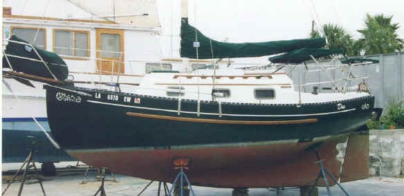

Can you fit the pod in the space in front of the rudder?
Will 6K watts be able to move the boat to the places you intend to go?

There are plenty of electric drive options that you can use with your existing drive shaft setup, remember you don't need a transmission anymore because the motor does reverse electrically
Mar 25, 2021
85
Pacific Seacraft Flicka 20 119 Marina del Rey
No, just measured it online and it does not sadly.
Yes, this should not be a problem.
There are plenty of electric drive options that you can use with your existing drive shaft setup...
Do you have any recommendations?
