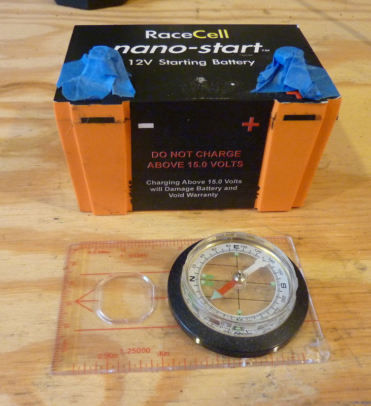

Li batteries, depending upon the chemistry, can handle loads upwards of 10C or ten times their capacity in discharge current. Impulse current can be upwards of 30-70X capacity.... A lead acid battery would implode if asked for anywhere near 10C for anything more than a few seconds........
I have physically started a Yanmar 3GM with a 6Ah Li battery (Race Cell brand). This is a 28C average load with the in-rush starter load approaching 65C. No 6Ah lead acid battery on the plantet, that I know of, will start a 3GM....

I miss spoke earlier the little Race Cell battery was 4.6Ah rated....;)

Holy crap - here are the specs on Main Sail's nano-start - 240 cranking amps!!!! Ten year projected life! I'm impressed.
High Power and Energy Density • Over 100C Pulse Discharge Rates
Long Cycle Life • Rated for Thousands of Cycles, 10+ year projected life
Maintenance Free Life • No Memory Effect
Rugged Technology • Excellent Abuse Tolerance
Cranking Amps: 240
Capacity: 4.6 amp-hours
Nominal Voltage: 13.2
Minimum Charge Voltage: 13.8
Maximum Charging Voltage: 15.0
Maximum Charing Amperage: 150
Weight: 1.7lbs
