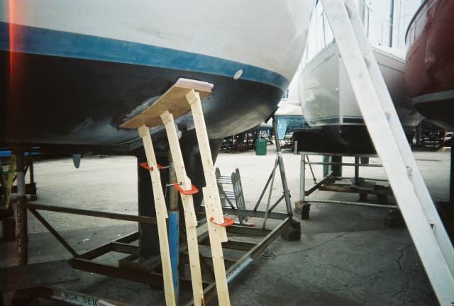

Not that this negates Roger's system and it certainly required two pair of hands, as Ross alluded to, but this Rube Goldberg Candidate that helped fill the exterior portion of the thru-hull used thin pink Styrofoam®, 3/8" plywood and the principles of the wedge to create uniform pressure on the hull contour.
Release fabric between the layers of fiberglass and the Stryrofoam® made it easy to peel and gave the surface some texture for the fairing compound to bond to.
Even an inquiring eye couldn't find evidence of the previous thru-hull once the surface was painted with VC-17 (& I looked, hard).
The Po' Boy Technique is now filed in the "Good Ideas" forder. Thanks.
