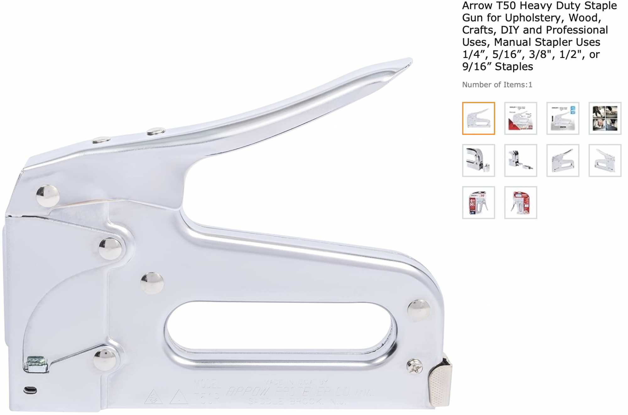

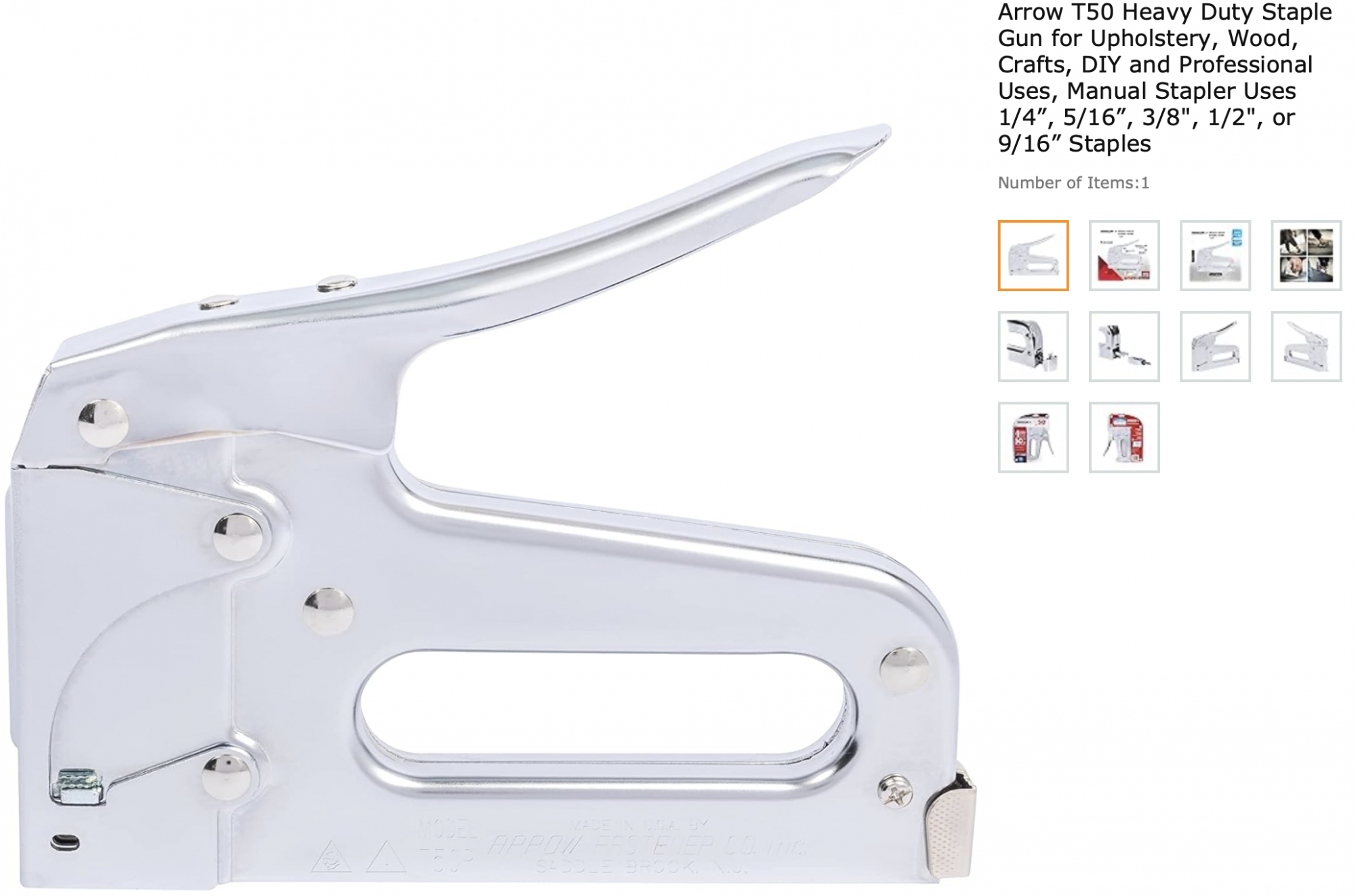

Hand Staplers work fine, but not the paper type.
