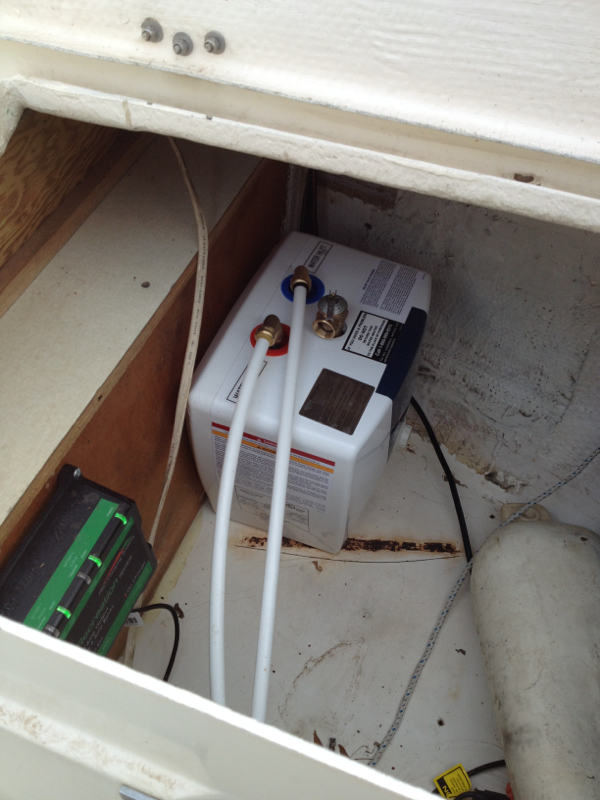

Looks good always nice to make improvements like this. I might suggest at the water heater you secure those water lines so that they are not damaged by stowed equipment. Hard to tell in the pictures but I am hoping you secured the heater as well. What type of heater is that by the way? Good job I am sure it will make your boating better.

We are lake sailors so we are docked a lot so I put in a 110v 2.5 gal. water heater. The tank is secured to the bulkhead. The biggest improvement was the smell.

Cool nice looking little unit. Just make sure the neutral and ground are not connected in the heater as some home unit do this. looks like some nice improvements. I do like the Plex tubing over the hose builders used to use.

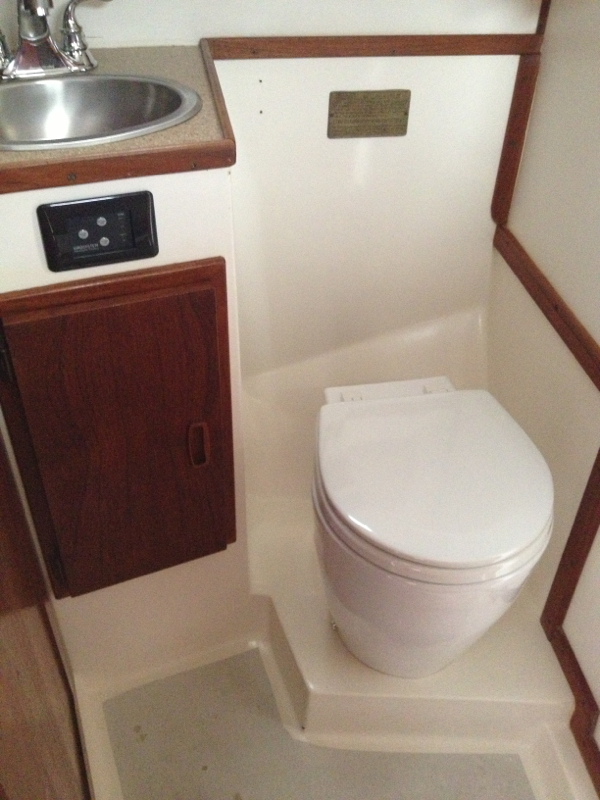

We replaced all the plumbing with new tanks, electric toilet, faucets, water tank and pex lines.

I put in a Reliance 2.5 Gallon Electric Water Heater, it a 110v unit that can only be used at the dock.
