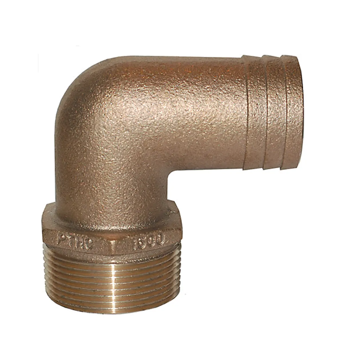

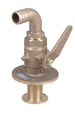

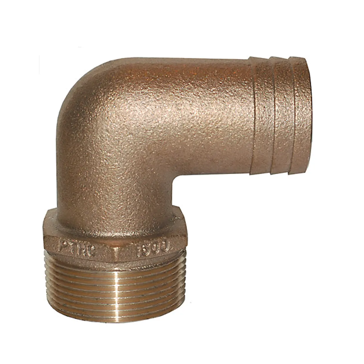

This is what a typical through-hull valve and 90º full-flow nipple looks like.
The nipple can be unscrewed to give you access to the ball valve. If there is an obstruction, it can often be that a non-full-flow nipple was used, like this one.
The 90º bend is too tight, and stuff gets stuck.
Remove the elbow from the valve.
Clean out the valve and the hose all the way back to the engine.

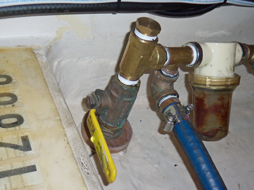

After several clogs, I finally got around to installing this arrangement :
  • When a clog happens, the valve is closed and the top plug is removed.
  • A clear vinyl hose about 24" long with a 3/4" X 3/4" hose adapter is attached where the plug was.
  • The hose is stood upright.
  • The valve is opened and the water slowly rises to the boat's waterline.
  • A long 1/8" SS rod is sent down the vinyl tube and through the valve.
  • You can see what's coming up through the clear tube when clear.
  • Re-assemble when clear and you're ready to fire up the engine.
Your extrnal strainer will cause problems in this operation if you're dealing with barnacles, which was always my misfortune.

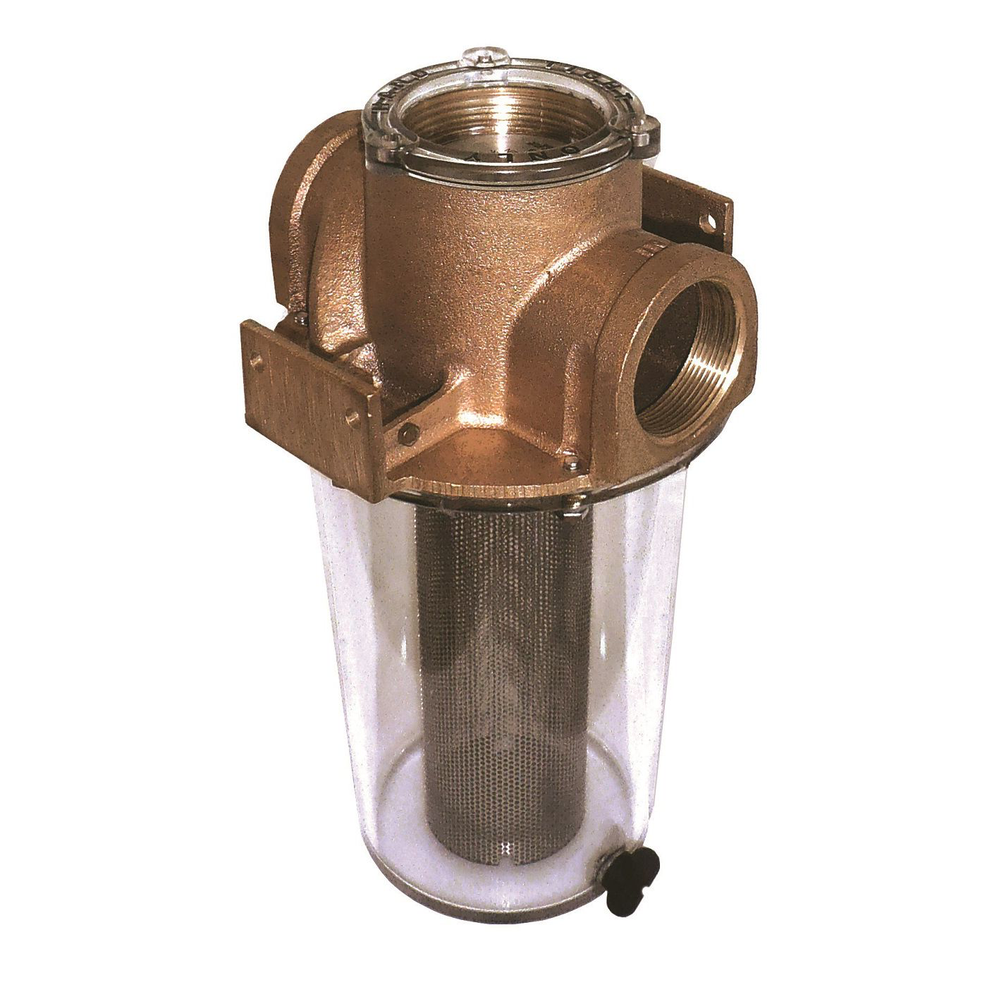

Stephentrapani, you sail in waters where eelgrass is a big factor. It gets sucked up intakes and finds its way towards the engine, unless it gets hung up along the way. It is the reason the boats I sail on have raw water filters.
This is a typical Groco ARG raw water filter and is the type I have on my boat. The screen will trap eelgrass before it can foul your water pump or destroy your engine.
