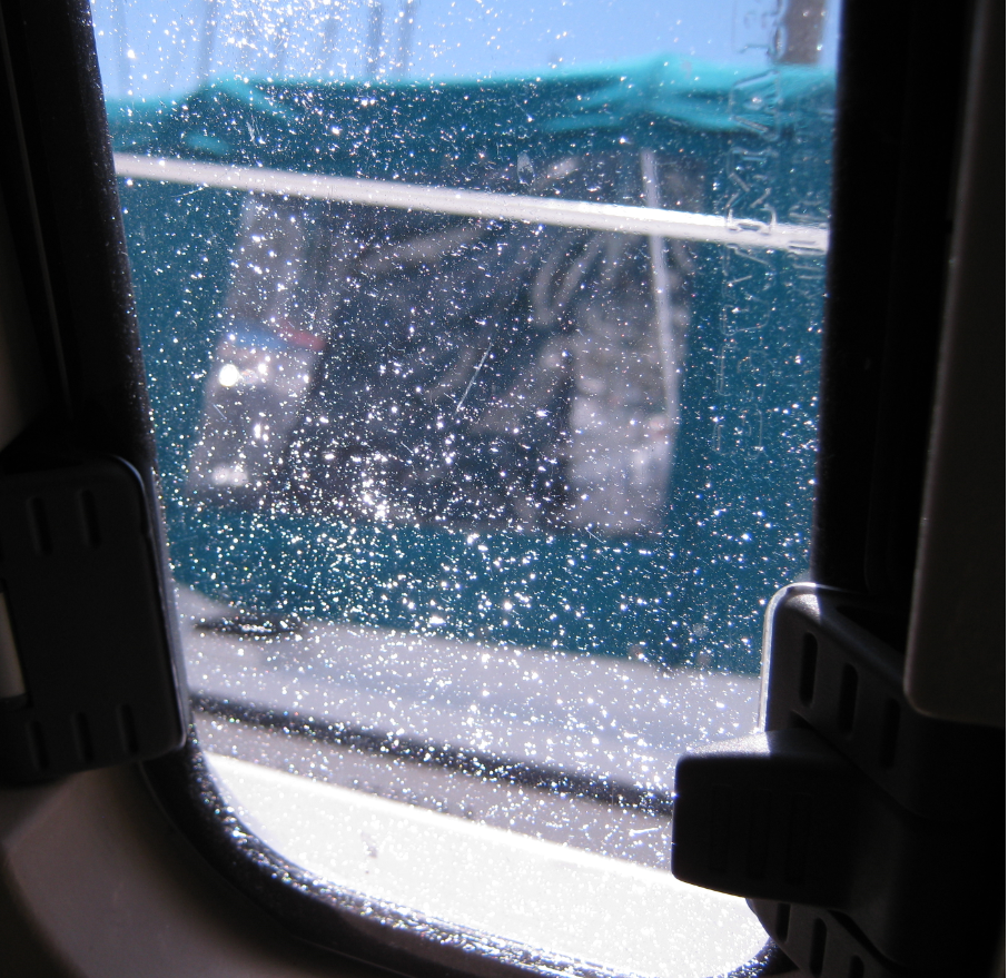

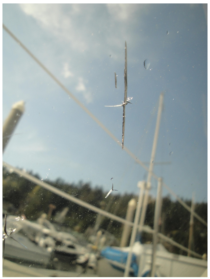

So I take it you are talking about the hard acrylic ports and hatches and not the soft windscreen such as strataglass.
In two words, forget it. What you describe are internal cracks which are not coming out with surface treatments.
These fixed portlights are bright and shiny on the surface because they are polished with a Meguiars cleaner and polish. The internal cracks are growing by the year.
This Lewmar opening portlight below looks like new from the outside as it's frequently cleaned and polished. Inside, a different story when passing sunlight. Replaced all of the opening portlights' lenses in the boat last winter.
Time to replace them.
