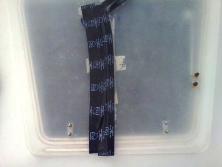

My 7.3 hatches are in need of replacement, the one on the fore deck is severely crazed and the curved companionway hatch has a new crack. I would like to replace them with the bronze color plexi, the fore deck is simple enough so I guess my question is is there a supplier who makes the curved companion way hatch or has anyone thermo formed a companion way hatch with any success? Thanks in advance for any help.

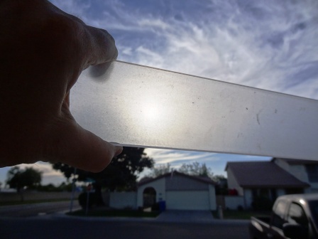

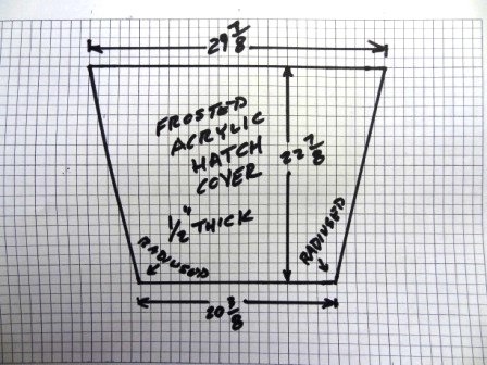

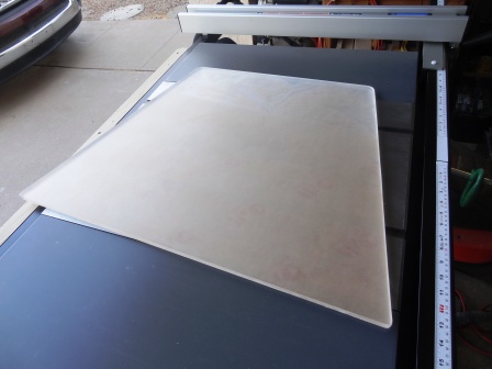

I haven't tackled the curved main hatch yet, but the front hatch was fairly straight forward. Mine was completely split when I bought the boat. Took some measurements and had a square of plexi cut by a local plastic supply company. Then I trimmed to shape on the table saw, and used a sander to smooth the edges and round the corners. I think it was $100 bucks or something like that for the sheet. Then with some 220 grit sandpaper, I dulled the inside surface so it will let light through but you can't see through it. FWIW here are some photos...

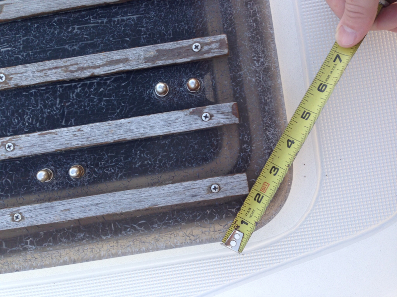

How easy is it to drill the holes? Mine is a square....probably meant to be 24 x 24 but actually 23.75 x 24.5. It has a four inch radius at the two front corners. Meaning that is you measure across the corner where it starts curving it is four inches.
