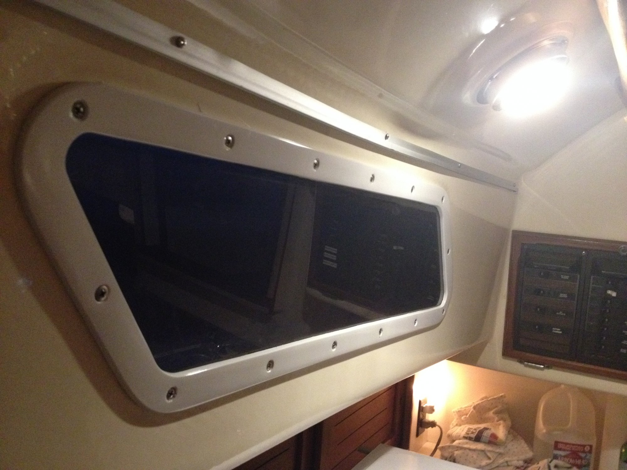

Removed, sanded, painted, resealed the aluminum port frames. (Pic).
Used Boatlife Life Seal.
Well, one of the 4 still leaks.
Is there an ultra-thin crevice sealant I can use on the exterior to try to shore it up?

Try some Captain Tolley's Creeping Crack Sealer.
