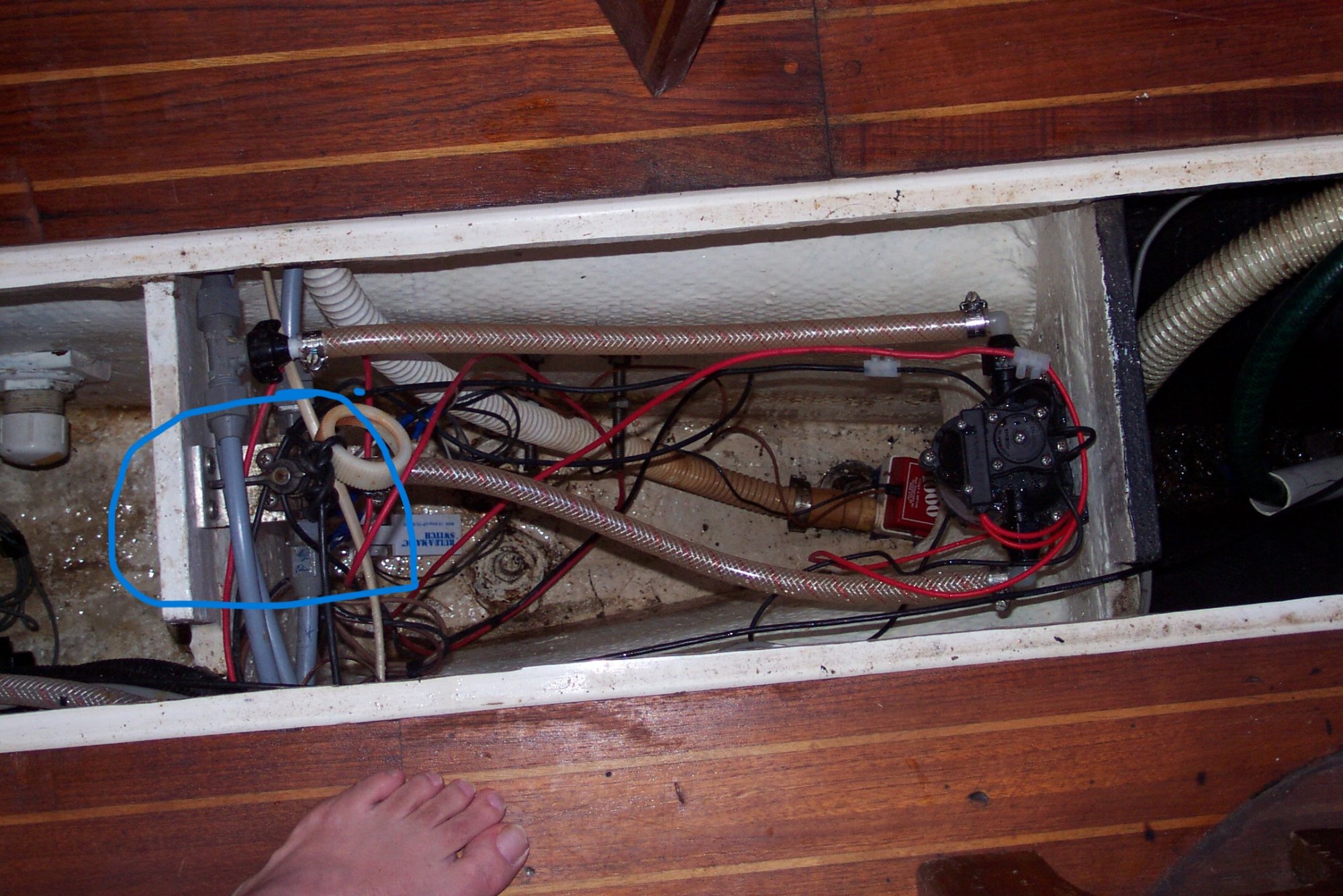

I'm not specifically familiar with the Cherubini Hunter, however, most boats with multiple water tanks have a manifold to select which tank is being used. Try looking in the bilge for the manifold. If you are not careful it is easy to use 100 gallons of water in a short period of time.

Most boats including Hunters have a manifold to select feed supply. if an empty tank valve is open, the pump will suck air into the pump causing what you describe. It shouldn’t be difficult to find the manifold as it is located where access is available for obvious reasons.

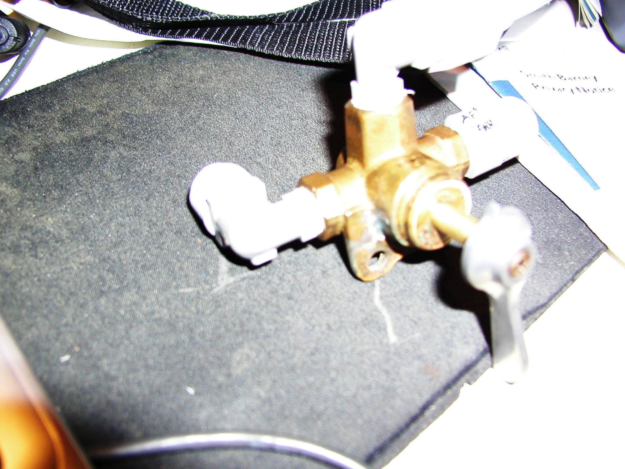

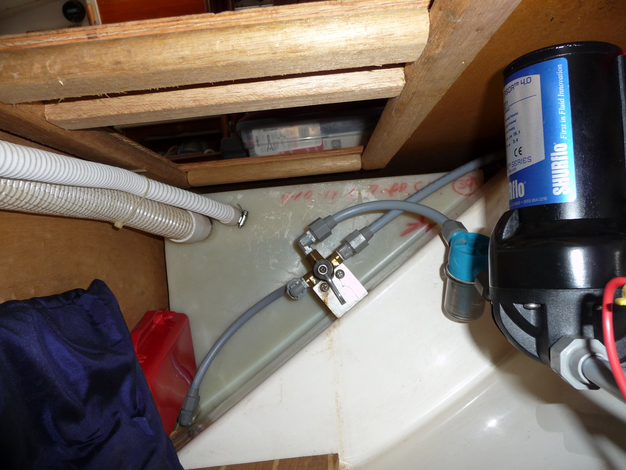

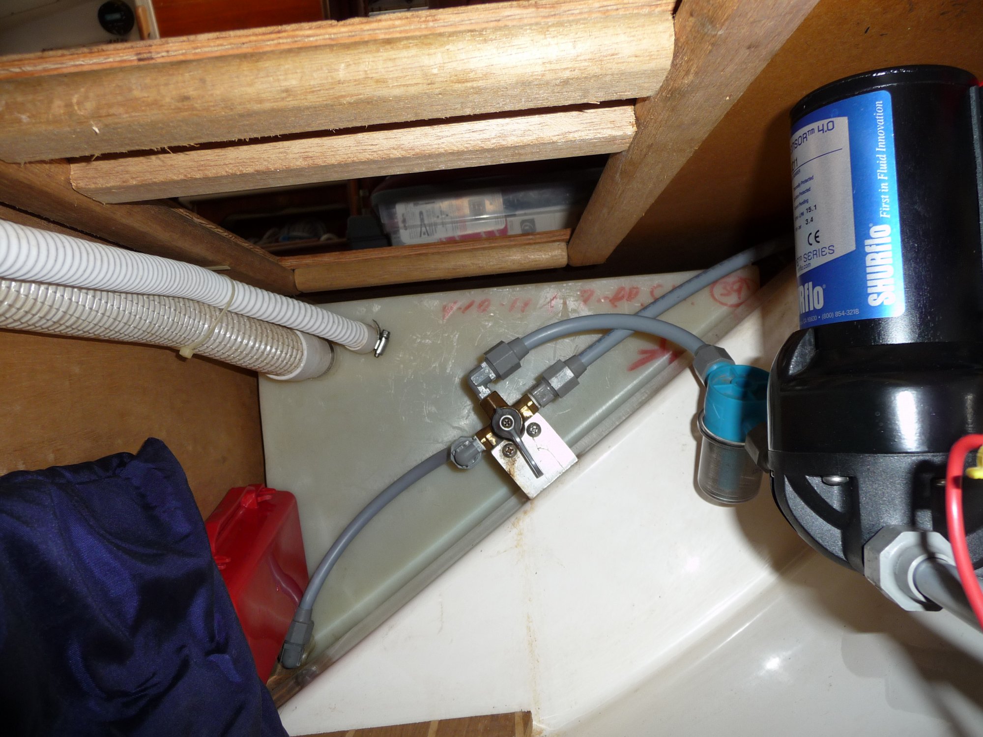

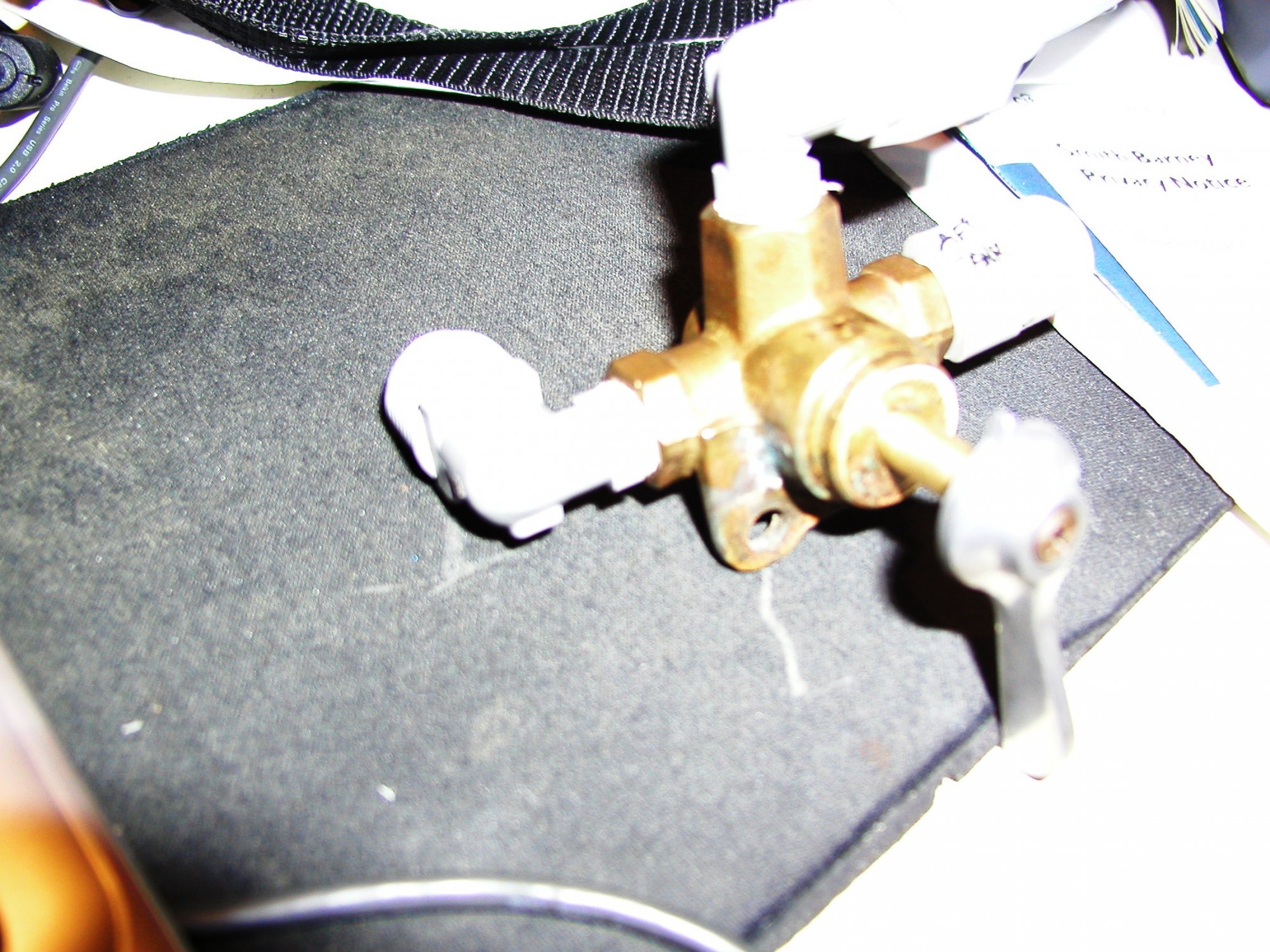

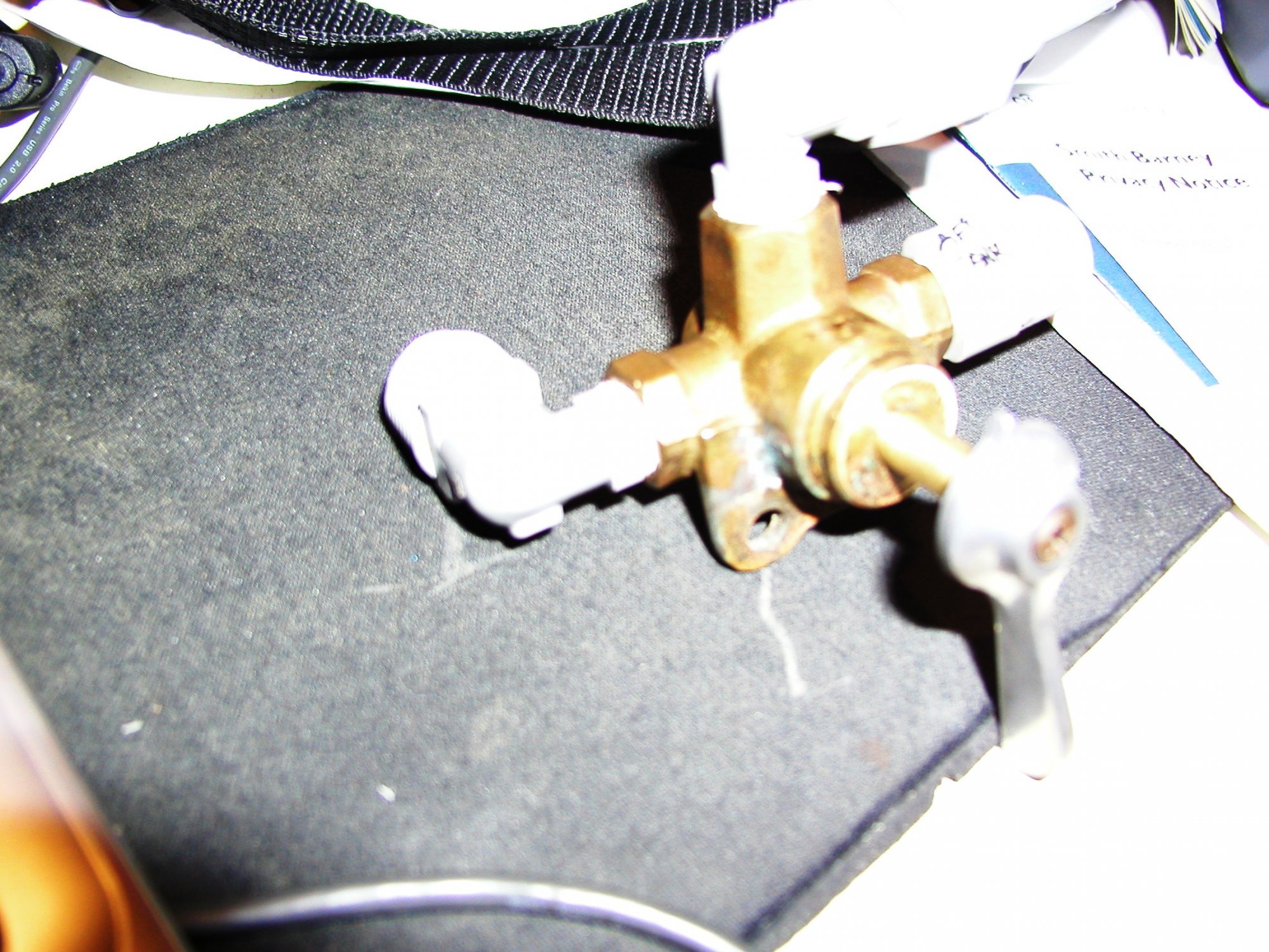

The tank selector valve was originally a three way valve .. I had to rebuild mine when it started leaking water out of the stem seal and it would leak air into the system when the pump ran.. Mine was plumbed with the output to the pump on the middle port and each tank on either side. his is on my H-34 but the 37 had the same valve. This is the valve :

on my daughter's 1984 H37C the water tanks are under the main salon settee seats. There is a manifold under the centerline deck panel with a valve. I think the valve lever is to port for the port tank and aft for the stbd tank. Each tank should have a gage at the forward end of the tank close to the bulkhead. There are two deck fills one port and one stbd.
View attachment 222952View attachment 222953
Thank you. Much appreciated. Found it. It was run out the outside to a little knob on the starboard side couch. Very well disguised.
Thank you
Thank you !!
