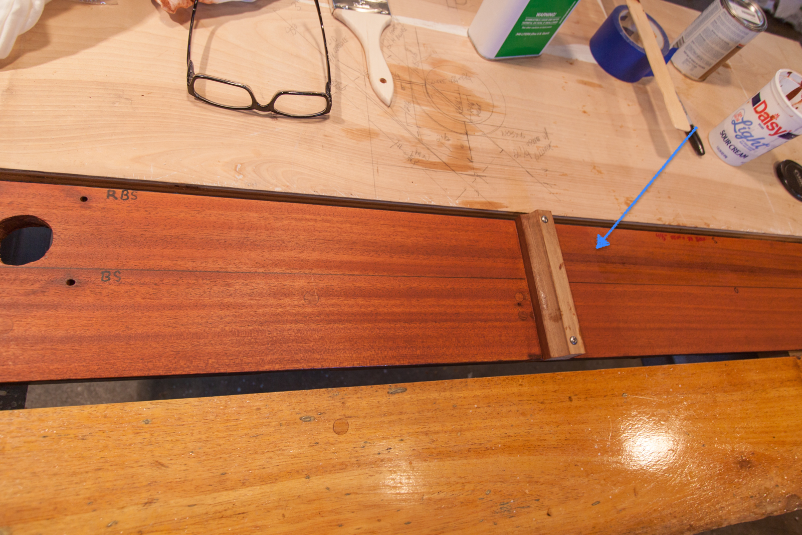

If the sole has no finish and is clean, you could use a marine sealer stain, like Interlux. It's nice stuff and easy to work with. The colors you can get are deep and rich and it's a sealer that speeds filling the grain. This is Interlux Sealer stain on old mahogany, stripped and sanded.
As to the finish, I don't ever use epoxy under or over spar varnish. Plus, I think you may get some un-even discoloration with it.

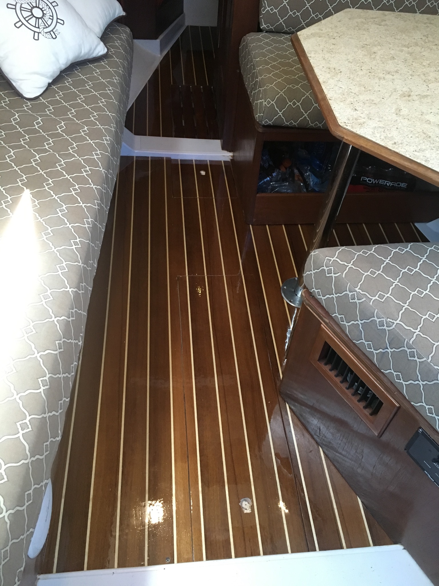

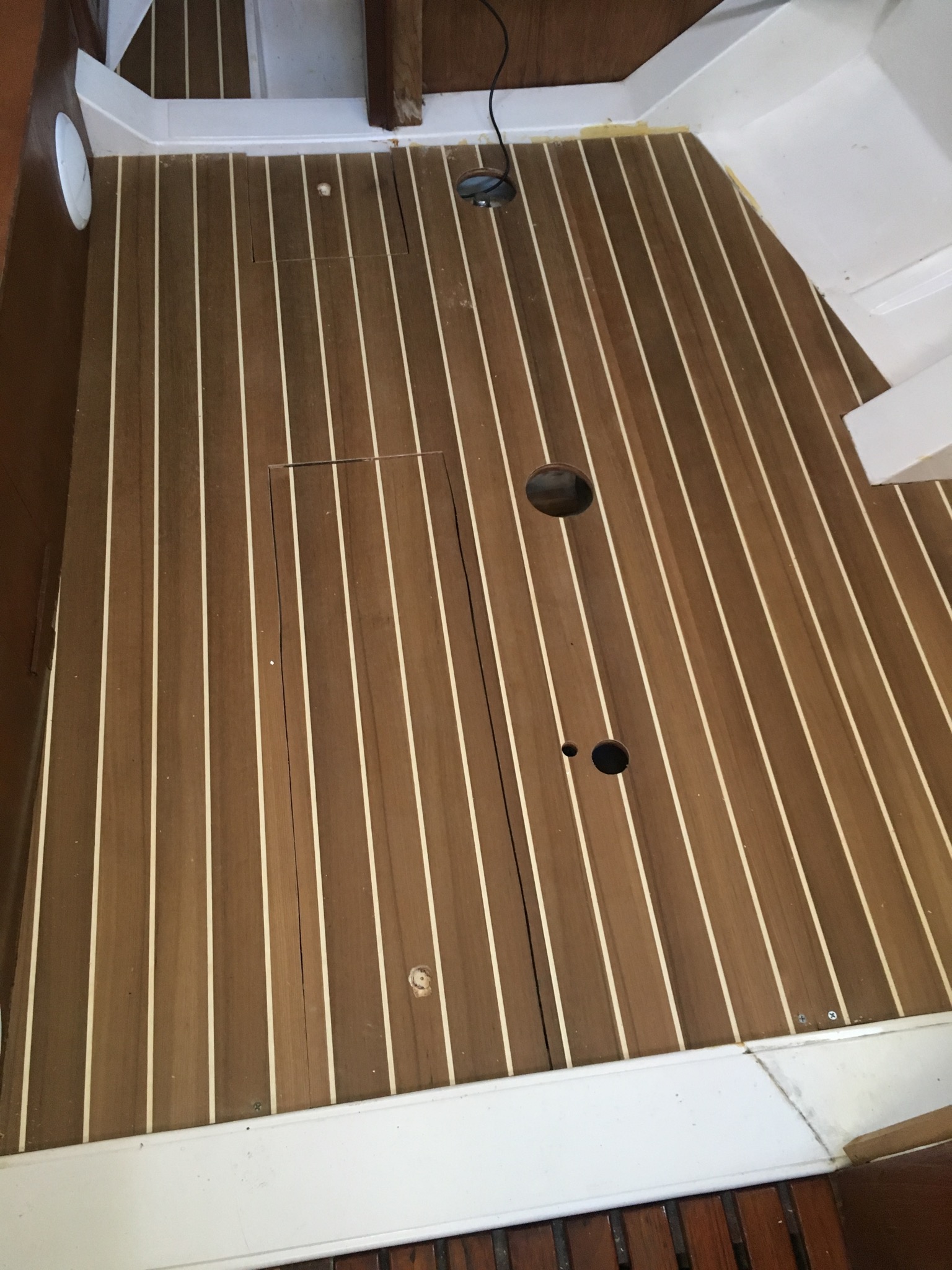

Kermit. Attached are pics of new teak and holly sole bare and then with 2 coats of West epoxy with a high gloss urethane top coat (3). West Epoxy with clear hardener left a rich color in my opinion. Let me know if any questions.

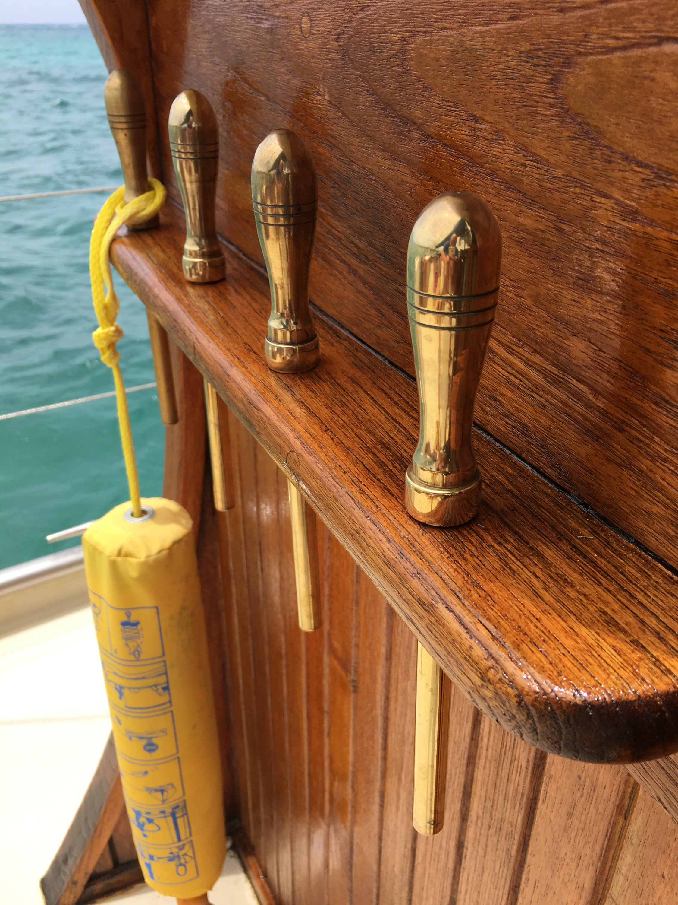

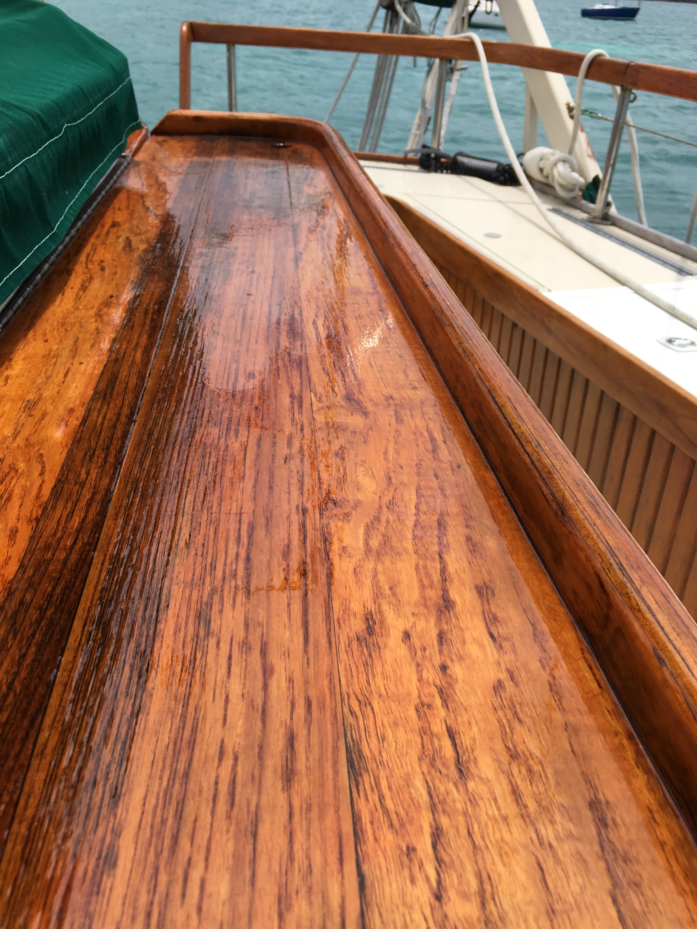

We use Epiphanes High Gloss exclusively. I like that it has UV protection that epoxy typically does not. One thing I have found is, after cleaning and/or sanding, when I wipe the residue of with mineral spirits i see the same color that I will see when I apply the varnish. The final color shows while the mineral spirits are still wet, then fades back to the very light pale as the mineral spirits evaporate.
I've included a couple of photos of Epiphanes on unstained teak. The photo of the pins is after 2 coats, the table top is after 8 coats.

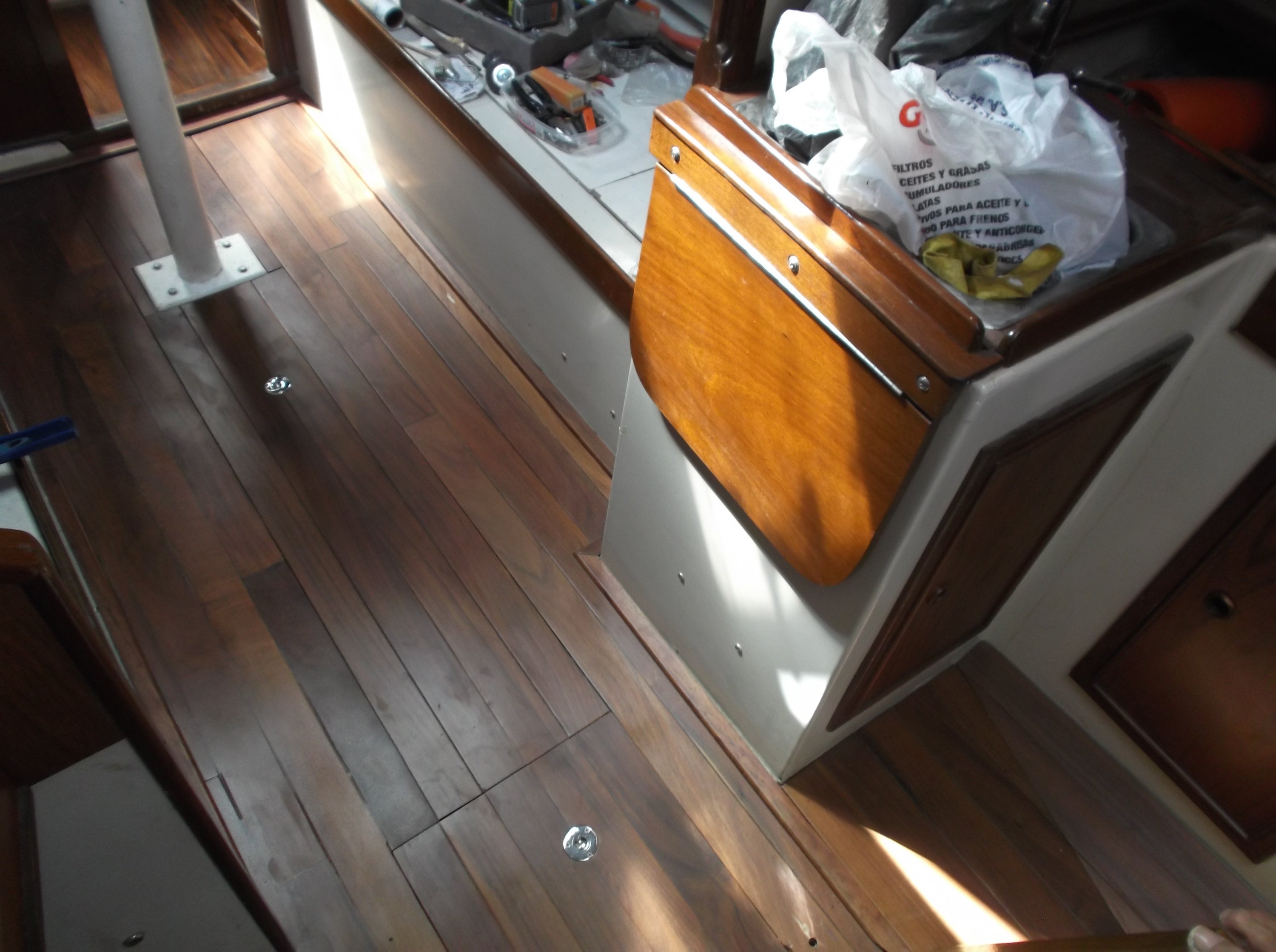

Hi, I just installed a new sole in my I30 and I used a wood called guanacaste. Here in Mexico teak is either non-existant or so expensive it's non-existant. I first used a 2 part polyurethant with a gloss finish...I didn't like it. Any and every little thing or imperfection seemed to be magnified. So, I sanded it and repainted with 2 part polyurethane semi-gloss...It's still a bit dirty but I think it looks great!
