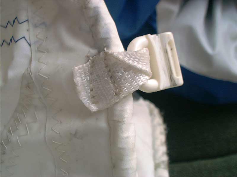

The plastic shackles on my main keep breaking. Lost 4 the last time out. A fellow sailor suggested sewing a piece of webbed strapping from the sail to the slug instead of using the plastic shackles. Anyone done this? Other recommendations?

Yes. Webbing. In a bind you can also lash them with parchute cord; doesn't wear as well, but should last few years.
Sailrite has instructions on their web site.
http://www.sailrite.com/Slugs-Slides-Shackles-Selection-Installation-and-Positioning-Instructions
Some folks use metal shaclkes, but they can cause wear if not well protected and place more strain on the slugs.

Webbing works well and can be bought at most sewing outlets in 1/2 inch widths. Use a needle palm to shove the needle through.

Have fun. My North Main has webbing. I still lost two and had to restitch one. I followed the Sailrite instructions.

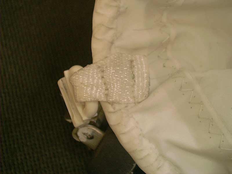

Just a thought: How old are the slugs that are breaking? The plastic/nylon will get brittle over time. Particularly if say 1980's vintage. If you are replacing only the ones that are breaking, are the new ones then breaking? Or just the remaining old ones? That was my experience for my 1980 Hunter 36, which I believe still had the original slugs when I bought it in 2007. Now except for the new plastic slugs at the four full length battens (attached to the sail by webbing) all the rest of the new plastic slugs are attached with SS shackles. No slugs have broken in the last four years ... even with many of 20-30kts San Francisco Bay outings to stress them.

I have replaced most of mine with #3 from the Sailrite link I posted above. I've used these on 2 boats and have found them to be more durable. I have full battens, though to be honest they break between the battens almost as often.

When I had the mainsail of our small boat converted to slugs a few years back, I chose slugs with metal loops, and the loft secured them with 3/4" webbing, well stitched behind the bolt-rope. This has been dependable.
