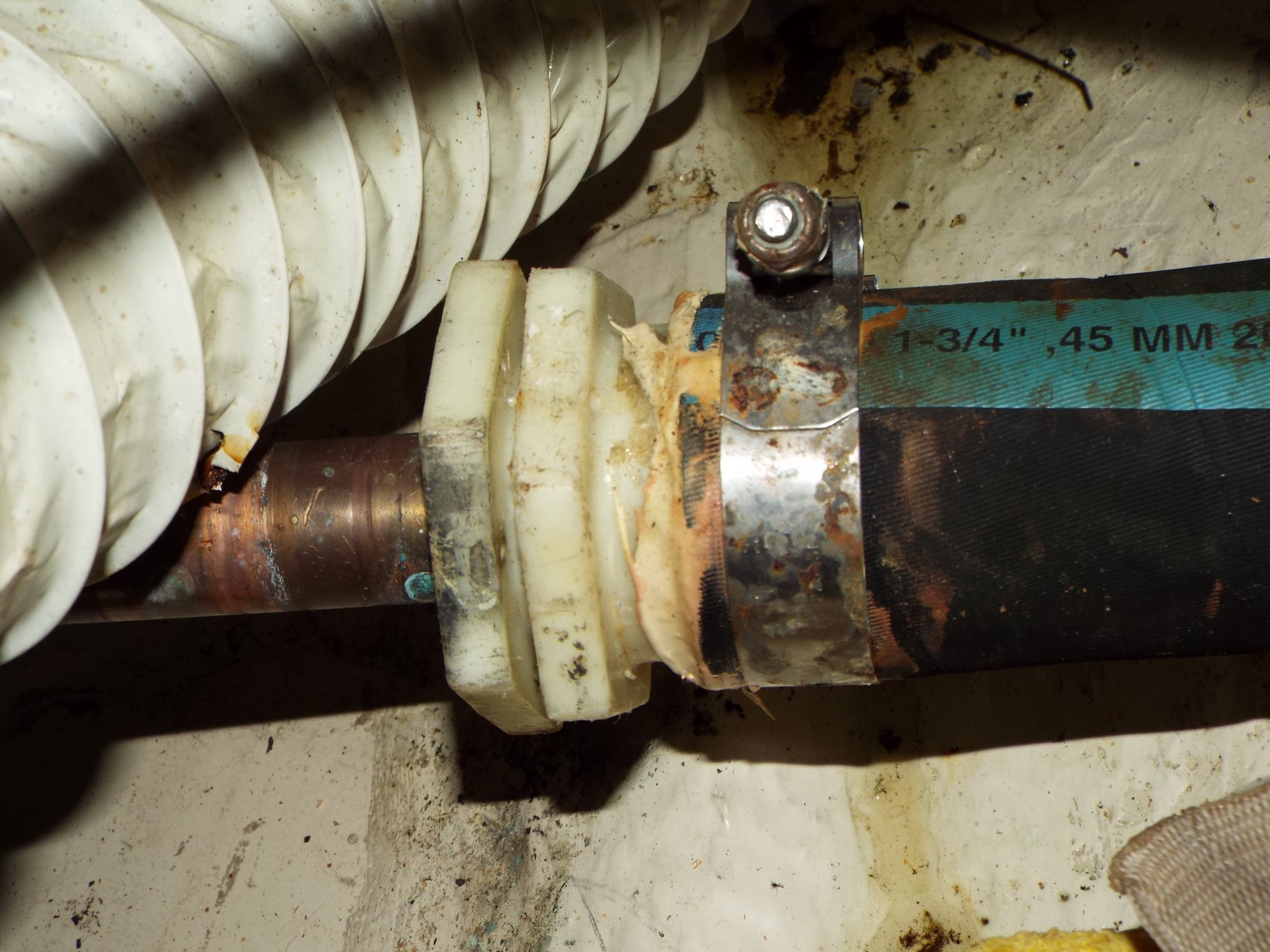

The packing box on my 1999 Hunter 335 is made out of some sort of plastic material. There is no lock locking nut. The packing nut is held in place with a piece of wire running through a hole in the adjustable packing nut and the fixed nut. Where these standard on this Hunter model? When I adjust the packing nut, do I need to align to the existing holes so I can put the wire back in place? This does not appear to allow me to fine tune the packing nut. Any advice would be greatly appreciated.

Wow ! Just what have you there ?
Mine is a 1999 Hunter and it came with the standard brass packing gland. As you say, with a wire for keeping the nut in place, there's no way for fine adjustment. I know the nylon packing gland does have a locking nut in a feeble attempt to keep the nut in place.
Hate to say it, but you may be forced to replace it with a proper packing gland ................ and all the effort that goes with it. My condolences.
Any chance you could send a few close up photos of this little marvel ?

We had a plastic bushing type shaft seal on our 1992 Hunter 30. You’re correct on both questions, there is no fine adjustment and you need to line up the holes in the flanges to put a wire or cotter pin thru to hold it in place. I bought a large pair of channel locks to help with then adjustments, which is trial and error till you get the drip right.
About five years ago, I put in a PYI, PSS drip less shaft seal. No more scrapped knuckles, baling water out from under the engine, or running down below while motoring underway to check the drip. Now it’s just check the set screw periodically. It’s an expensive installation for sure, but we’ll worth it.

Any chance you could send a few close up photos of this little marvel ?Photo attached

Thanks again to everyone who responded. After much consideration (and a couple of glasses of wine) I've decided to take the easy way out for now and do nothing. I'll revisit the issue when I next haul the boat. One thing I may try in the meantime is to drill an additional whole, if necessary, after adjusting the packing. If I can't line it up to existing holes, I'm fairly sure I can get my right angle drill in a position to drill a new hole and then wire it. Not an elegant solution, but one that may be able to serve me for a while.

Only 1 clamp :yikes:
Good catch - I was so focused on the packing box issue I didn't notice the single clamp. This entire episode, including the single clamp, makes me wonder about other "economy" measures Hunter took - many of which may not be readily visible.
Not all Hunters are like that. Mine wasn't, but I replaced it anyway with a dripless. You could still double clamp it without taking it apart.

That is so wrong in so many ways. I've never heard of Hunter using a bronze prop shaft in 1999 models. Are you sure the boat's not a forgery :biggrin: ? Maybe check your hull ID and see if it conforms to normal numbers.
Given your situation, I'd probably do the same until next fall. If you do try to tighten the packing nut (tighten 1/2 a flat at a time), be careful nothing happens while you have the wire out when the shaft is running for testing purposes. It doesn't look like you have much clearance left on the packing.
You can make it as good as new next fall with a new SS shaft, new shaft coupling, and a proper gland seal.
