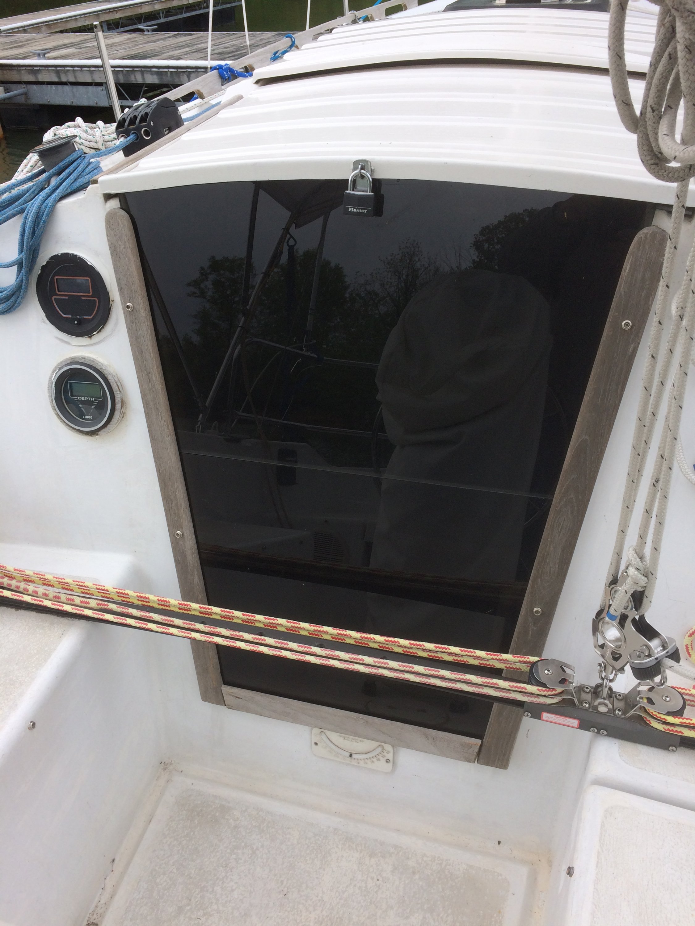

I think this looks dead sexy. :)
I forget whose boat this is, someone here at SBO if I recall.

2 pieces. Cut the width slightly small, so they slide easily.
Taper jig on table saw works well, too. Jig saw for the upper arc.
1/4" interlocking rabbets form a watertight seal.
Bottom piece, rabbet the outward face, top piece, rabbet the inside face.
Easy-peasy. Go to YouTube to see how to burnish the edges.
